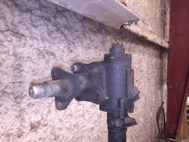

    ID this column please:

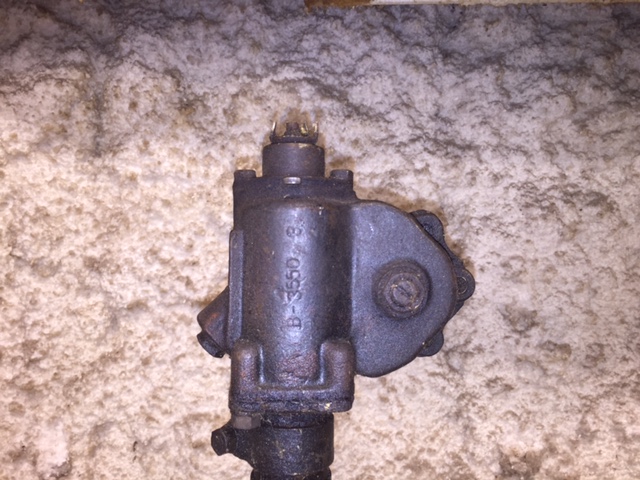

    I think it's a '34 Ford, box, column, and wheel. The switch seems to be also.
    However, that 'tang' next to the clamp on the mast jacket is a black zip tie...
  3. RPU Rick
    Joined: Mar 9, 2006
    Posts: 164
    RPU Rick
    Atwater Mike.....Eagle Eye.....!
    Thanks...

    Would a '34 steering box, (if in good condition) provide adequate steering for an A-V8?
  5. Atwater Mike
    Joined: May 31, 2002
    Posts: 11,624
    Atwater Mike
    Yes, Rick. It's a Ross box, parts to rebuild it are available, in a 'kit'...
    I had the identical steering box in my first 'roadster', a channeled '31 Model A Cabriolet over a gennie '32 frame. Flathead 59A-B, '37 Lincoln box, '32 rear.
    Car was NOT a 'lightweight', had all the original wood (!) and a strong subframe, weighed 2200 lbs.
    Steered as nice as friends' F-1 steering boxes in similar cars.
    If it's rebuilt, it's fine for a light car...
