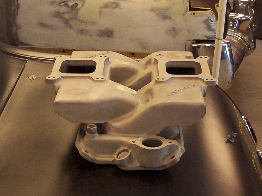

    im thinking of putting 4 rochester on this

    way cool. On what engine?
    I will run a MoPar small block, and the intake selection for old style carbs are more than slim. That's why I'm going this way. and unfortunaly I think just 2 stromberg 97's are to lillte on a 360 cui. There are not many 2x4 intake either, but I think I found one that will work this way.
