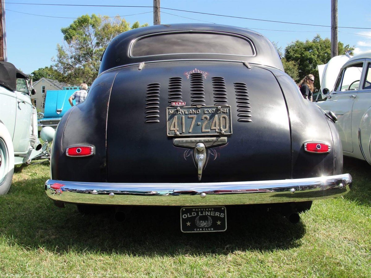

    I think your suggestion is a good one and one that I should do. I do not have period correct rear lighting, and have motorcycle lights in front for turn signals. I used LED units in the back and assume they are bright from a distance, I need to check that out to make sure my assumption is correct.
    I am building a Studebaker and I want to somehow upgrade the tail lights so they are brighter than the factory designed lights in 1953 IMG_1142.JPG

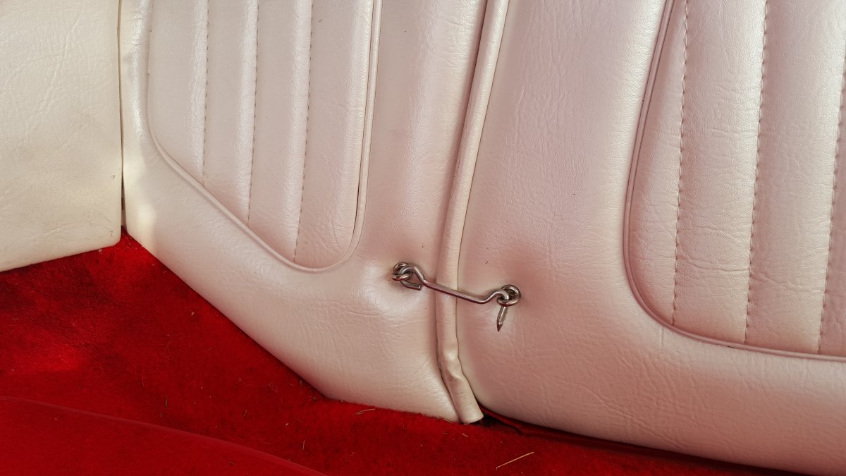

    I've got those on my A too. I use them every time I drive it. Even though it has bear claw latches, those will also pop open with the right conditions.
