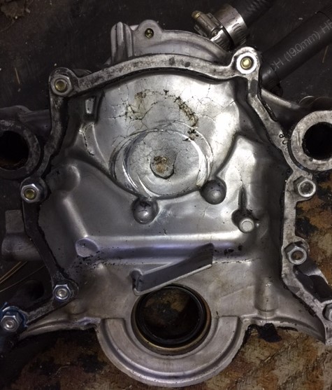

    To begin, I bought a pretty good 1936 Ford cabriolet project from a fella in GA that he'd put together to be small block Ford powered. However, as often happens, his priorities got shifted and he had to remove the engine and trans for another project after he had already pretty much worked out the clearance details by using a Zoops front system. Please forgive that Zoops is not traditional but I promise not to show any of that in the pictures. It really doesn't matter what parts you are using in this tech tip anyway.
    The problem, as show below, is that while I got the front system with the car; I did not get the engine. Figuring, incorrectly I might add, that any SBF could be used; I bought a 1986 fuel injected 302 with AOD and proceeded to put same in the cabriolet after removing all the original fuel injected stuff as well as the original front system of pulleys, pumps, alternator, etc..
    I got the timing cover that went with the new front system with the project car package; just not the rest of the engine!!
    I put that timing cover on the new engine and tightened everything up and was thinking things were moving right along. It did go well until I went to put the second gallon of anti-freeze in the engine and I started hearing something that just didn't sound right... the sound of water pouring into standing water. After thinking about it a minute, I decided to check the oil... and found where that water sound was coming from!!
    Drained the oil, and water!!, from the oil pan and left the oil plugs ou11t.
    Took it apart and here's what I found.
    You can see where I inadvertently considerably expanded the water capacity by adding a hole in the back of the water pump area of the timing cover!! Dang!
    Anyway, removed the concentric piece that might have run a fuel pump on a none FI engine and bought a new timing cover. I also measured the clearance in the new timing cover and also measured, as best I could guesstimate, the room needed for the revised configuration on the front end of the camshaft. I even ground a little bit off the top of the bolt but not enough to complete remove the original relief cuts in the top of the bolt.
    In telling a fellow gearhead friend of my efforts, I told him I was going to run a yellow marking stick over the end of the bolt and then stick the cover on dry, without the gasket, to see if it cleared.
    He then suggested I ask the wife for an old tube of lipstick. I'm sure the rest of y'all have been using lipstick for this purpose for years; but somehow nobody ever told me!!

    Here is the sequence from round 1:
    I applied the lipstick. Didn't even use a mirror.:D:D:D
    Checked that the inside of the timing cover was clean.
    After putting the cover up against the block and realizing it wouldn't sit flush against the block on both sides, I removed the cover and found the above.:( Dang!

    Then I found a slightly thinner heavy washer to use on the end of the camshaft bolt to secure the top timing gear and also ground the top of the bolt down some more.
    Round 2:
    Wiped the timing cover clean inside.
    Then, tried to get it to sit flush a second time.
    ALMOST set flush to block but not quite!! Dang again!!
    After looking at it a bit, I realized the dummy doing the work had NOT used the thinner heavy washer!!:eek:

    I already knew but further realized that engine assembly was not my strong point!!:D
    So, for round 3 I used the thinner heavy washer and also ground the top of the bolt down further; removing the rest of the original relief slots in the top of the bolt and then making sure the top was pretty flat by finishing it off with a flat hand file.
    I wiped off the inside of the timing cover again and proceeds to check my progress again.
    Round 3:
    It seemed to sit flush against the block on both sides; even without the gasket.
    Maybe?
    Verdict is a thumbs up as shown below!!:):)
    Any questions?
    Yes, bright red might work better but I didn't want to come across as being too brazen!!:D:D:D
    Hope this little saga causes some of you to share a laugh or two with your buddies...
    and improve your technical skills at the same time!!;);)

    If anyone else runs into this, you can countersink the hole in the washer and use a countersunk socket head bolt with loctite.

    I am more confused by why everything is hitting the inside of the cover?!?!? I gave build hundreds of SBF/351W engines and have only seen this a couple times and each time it was the top gear sitting wrong on the cam.

    My thoughts exactly. What happened to cause this timing cover to be too shallow? Is it a special cover of some sort?

    I have been working for FORD forever, I remember 351 had bad "CAM WALK". And there was a thinner washer on the cam bolt in the for the cam gear. Ford did find a fix for it with a TSB for this concern. I am 57 and retired. I cant believe I can remember this stuff.
