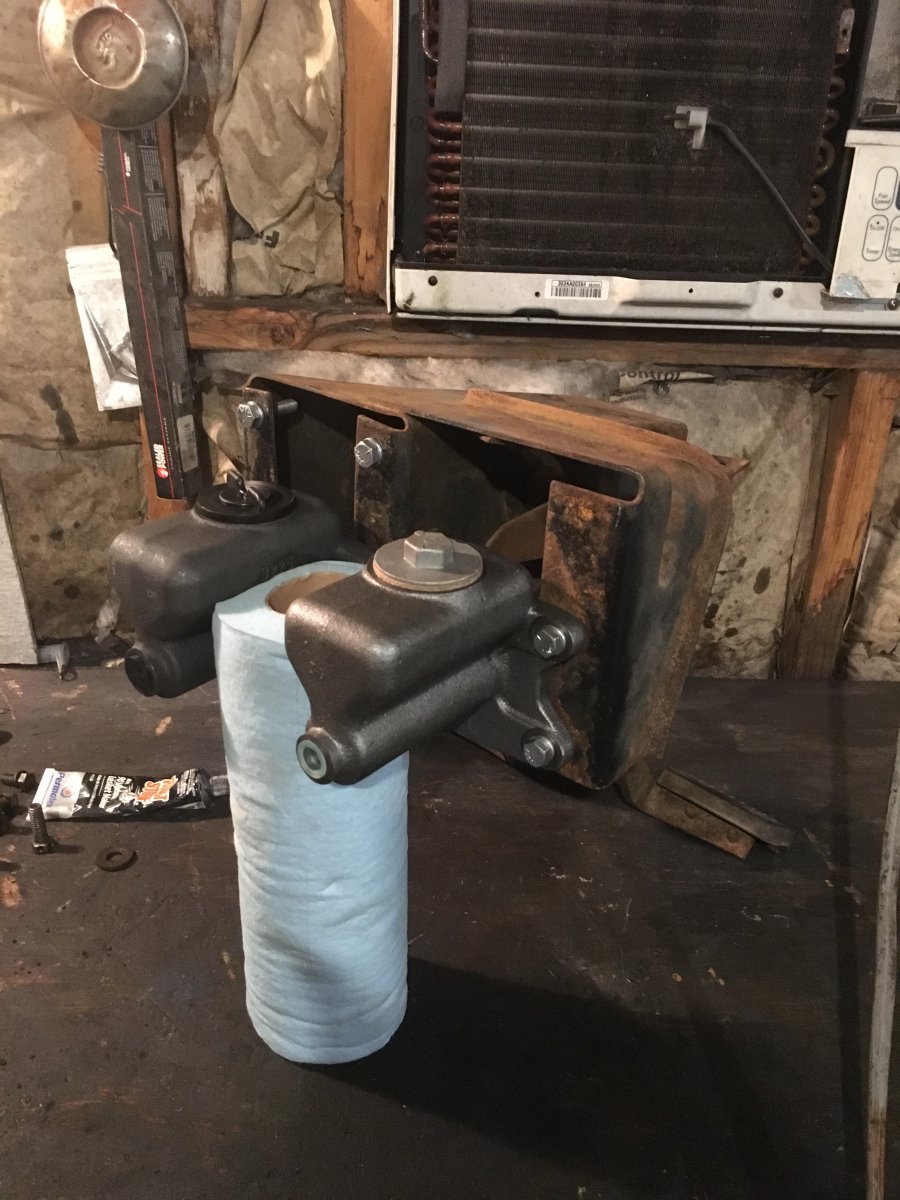

    I am going to run a 1957 ford truck pedal assy and use its brake and clutch master cylinders along with a '62 chevy slave cylinder. This last weekend I built the clutch slave cylinder setup for the tranny. IMG_0729.JPG IMG_0730.JPG IMG_0746.JPG IMG_0749.JPG

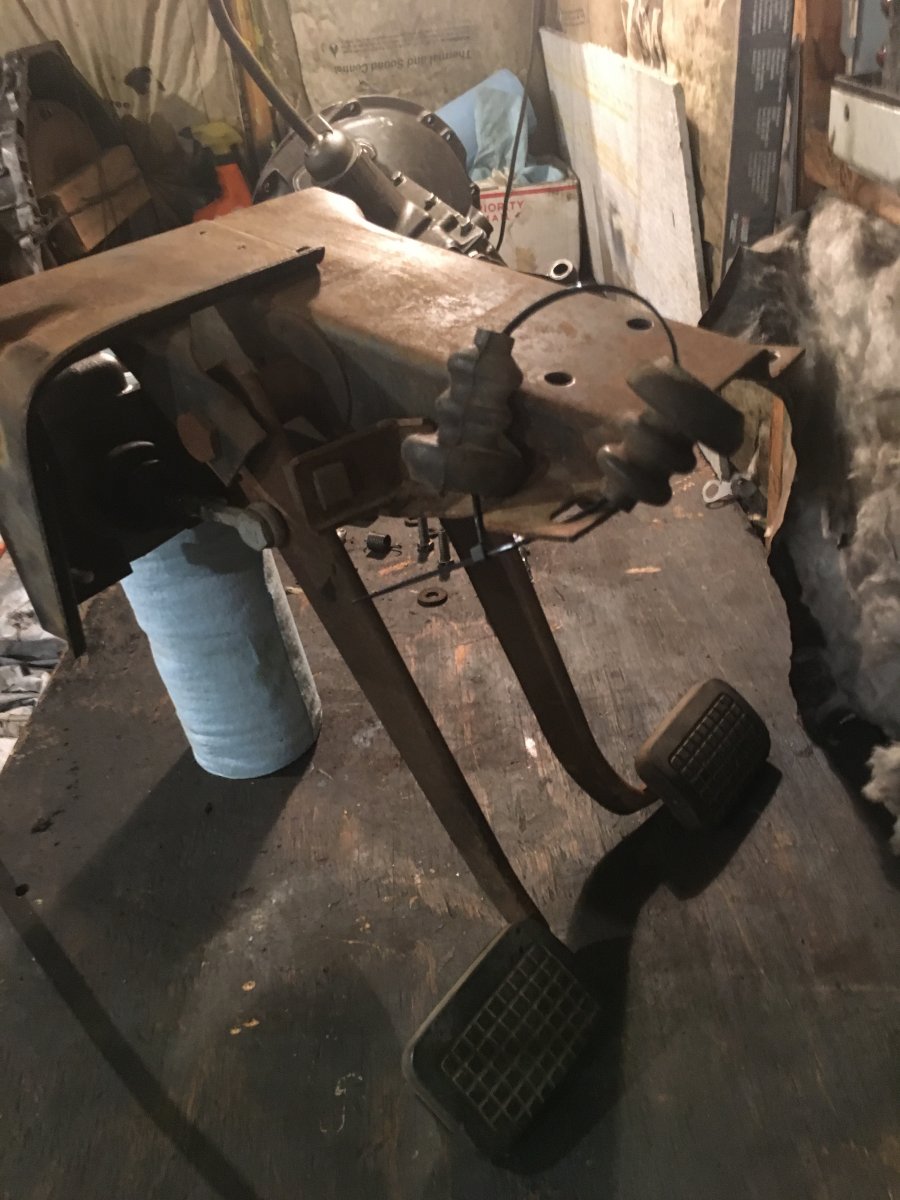

    I got my peday assy installed. I will probably have to rework the actual pedal pads a little.

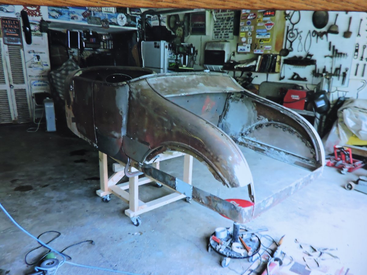

    Been working on building the floor and also decided to raise the front end of the body (firewall end) up about 1/2". Now the hood (If I had one) would be setting level.
