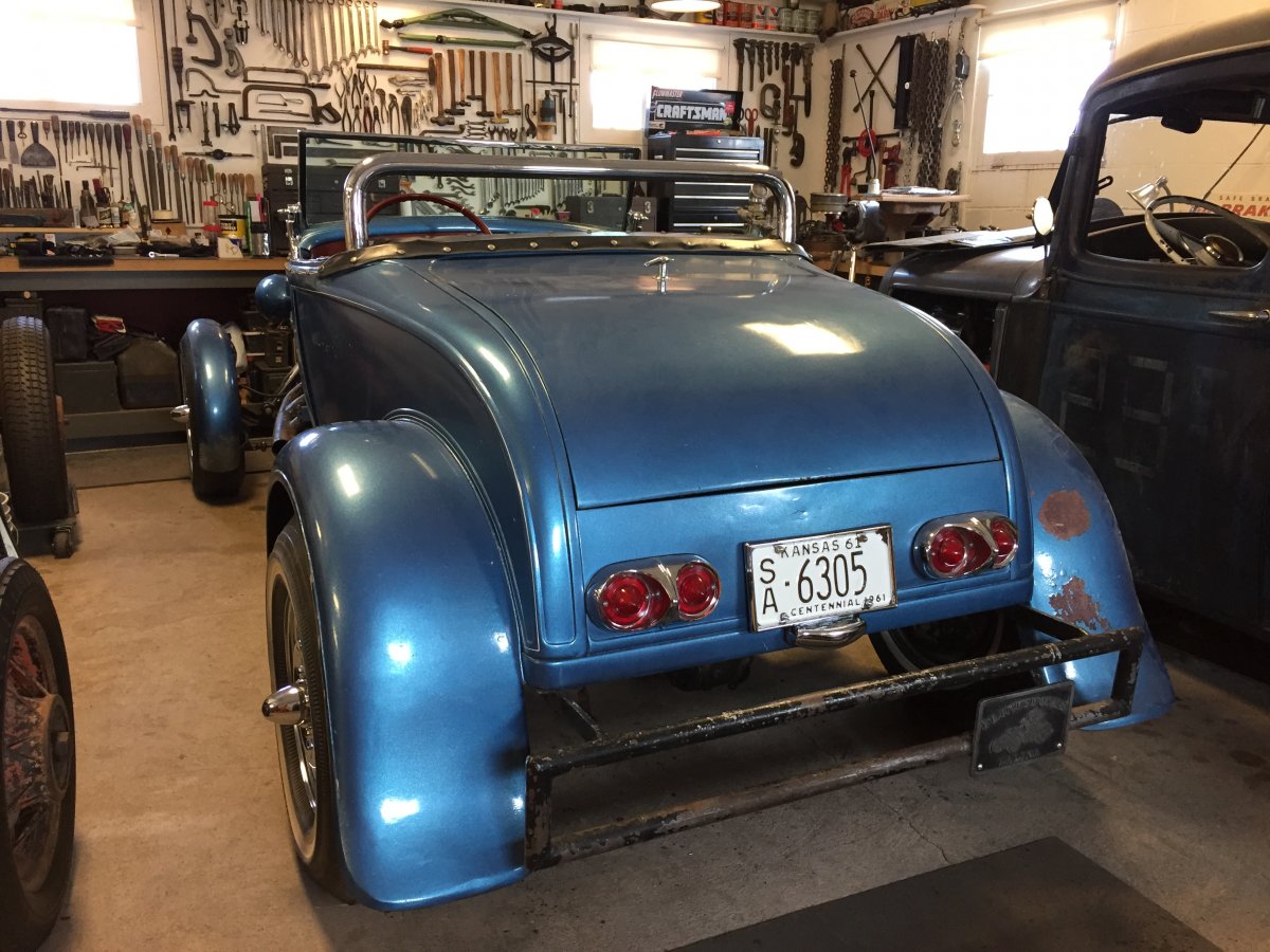

  5. Hey @31chevymike I actually have been working a little bit!
    I got this plate online. SA=Saline County= Salina, Kansas! We can run YOM plates here but a ‘31 plate would be weird so I’ll just get an antique tag and use this one for shows.
    Yankee 331/32 tag light. A friend is suppose to send to me a Hollywood tag light that I may use instead but this should be of similar dimension.

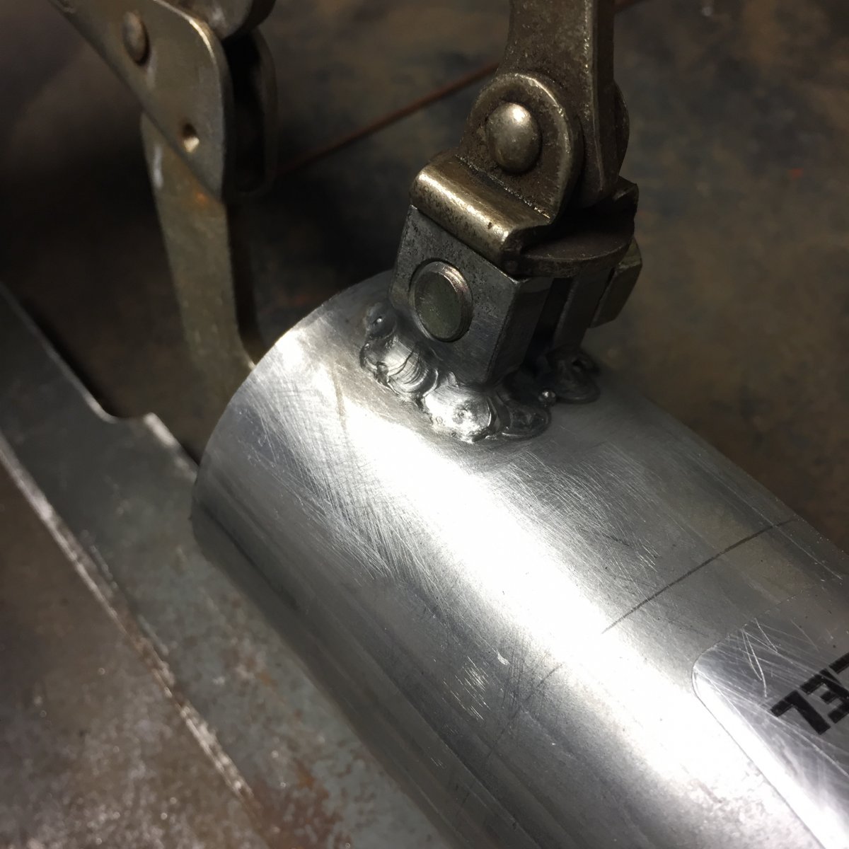

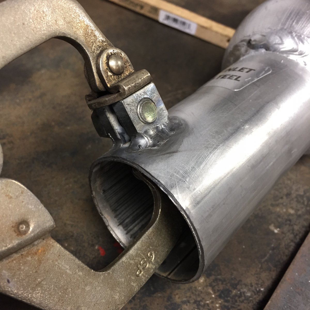

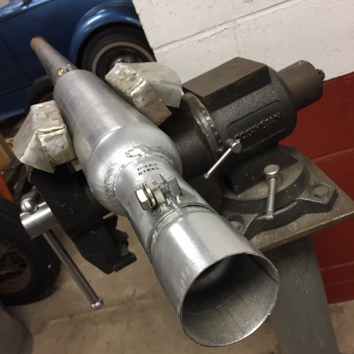

    I also bought a set of Brockman Mellowtone steel packed mufflers to attach forward of the “Scavenger Pipes” that were loosely bolted underneath. They’ve been under there a long time and are visible in pics of the roadster when it was white. I’m not sure if they were ever hooked up though?

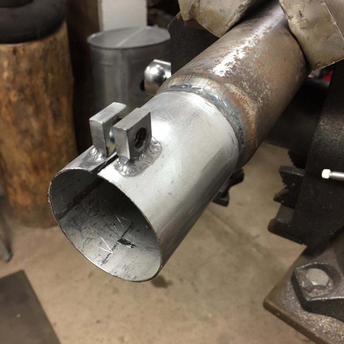

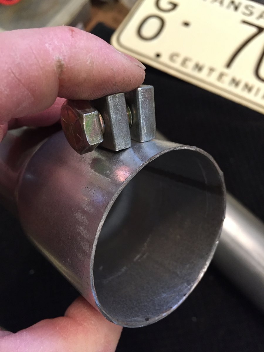

    Anyhow, I wanted to keep it fairly uncluttered so I modified some square nuts to weld on to act as clamps.
    I did the same on the “in” end of the scavengers after adding that 3" piece of pipe to them.
    Cut a slit to get some clamping action.
    I just need to fit it all up to the car now. I may have to monkey with some bends at the ends of the headers but it should work out pretty well. Thanks for asking! Happy Holidays to you and yours (and the rest of you all too!) as well!

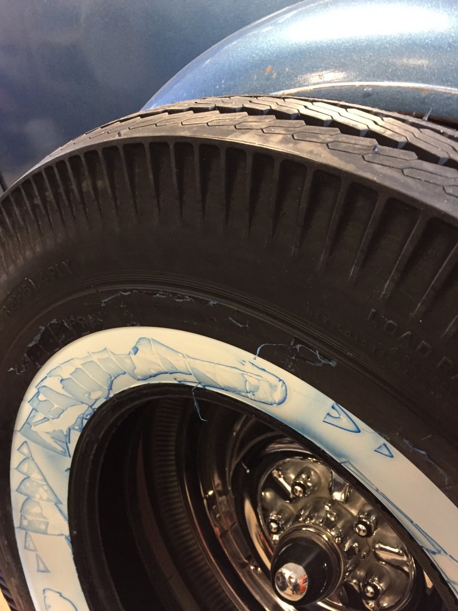

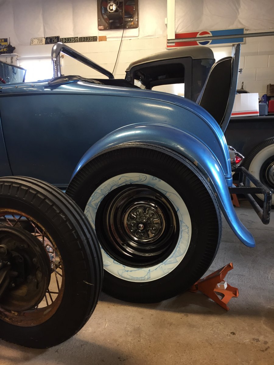

  13. I managed to make a decision on rear tires and got them ordered from Coker to get in on the free shipping they were offering. That along with my alliance membership saved me over $100! I decided to go with a medium wide whitewall. These are BFG silvertowns and I love, Love, LOVE the pie crust on them!
    I am still deciding on fronts.

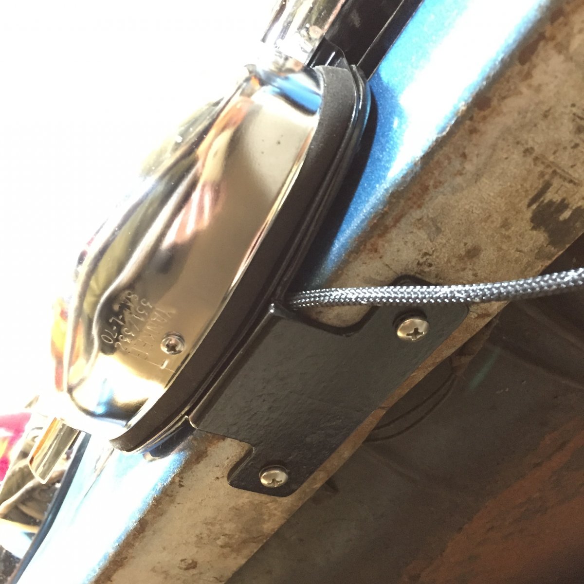

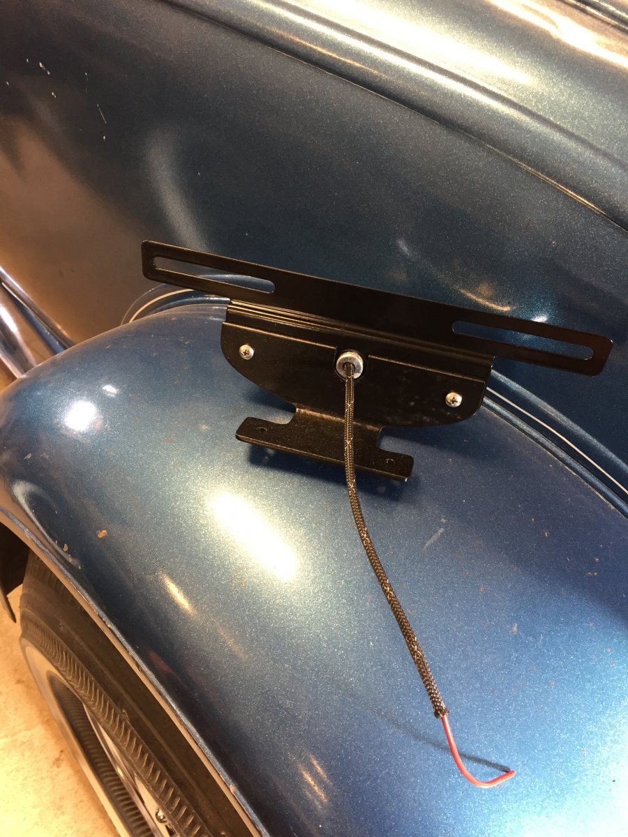

    Then I decided to make a bracket for my tag light/tag.

    Really nice work on the license tag/light mount! Also LOVE those BF Goodrich Silvertowns - how high is the whitewall on them Mike? I'm looking into the front tires as well, hoping they match my 2-1/4" high wide whitewalls on my Radir Cheater Slicks...
  16. Thanks @31chevymike! The WW is 2-1/2". These are 8.20-15s. I would imagine that a smaller front tire would have a slightly smaller WW? Probably 2-1/4"? I'm looking into a different tire on the front (not BFG) that has a look similar to what is on it currently.

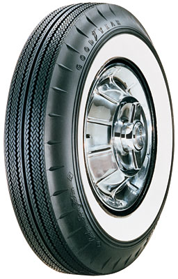

  18. @31chevymike, I’m actually leaning toward these Goodyear Supercusions as they were also available and a hot ticket on custom cars of the era. Plus, they are very similar to the tires that have been on the car since ‘58.

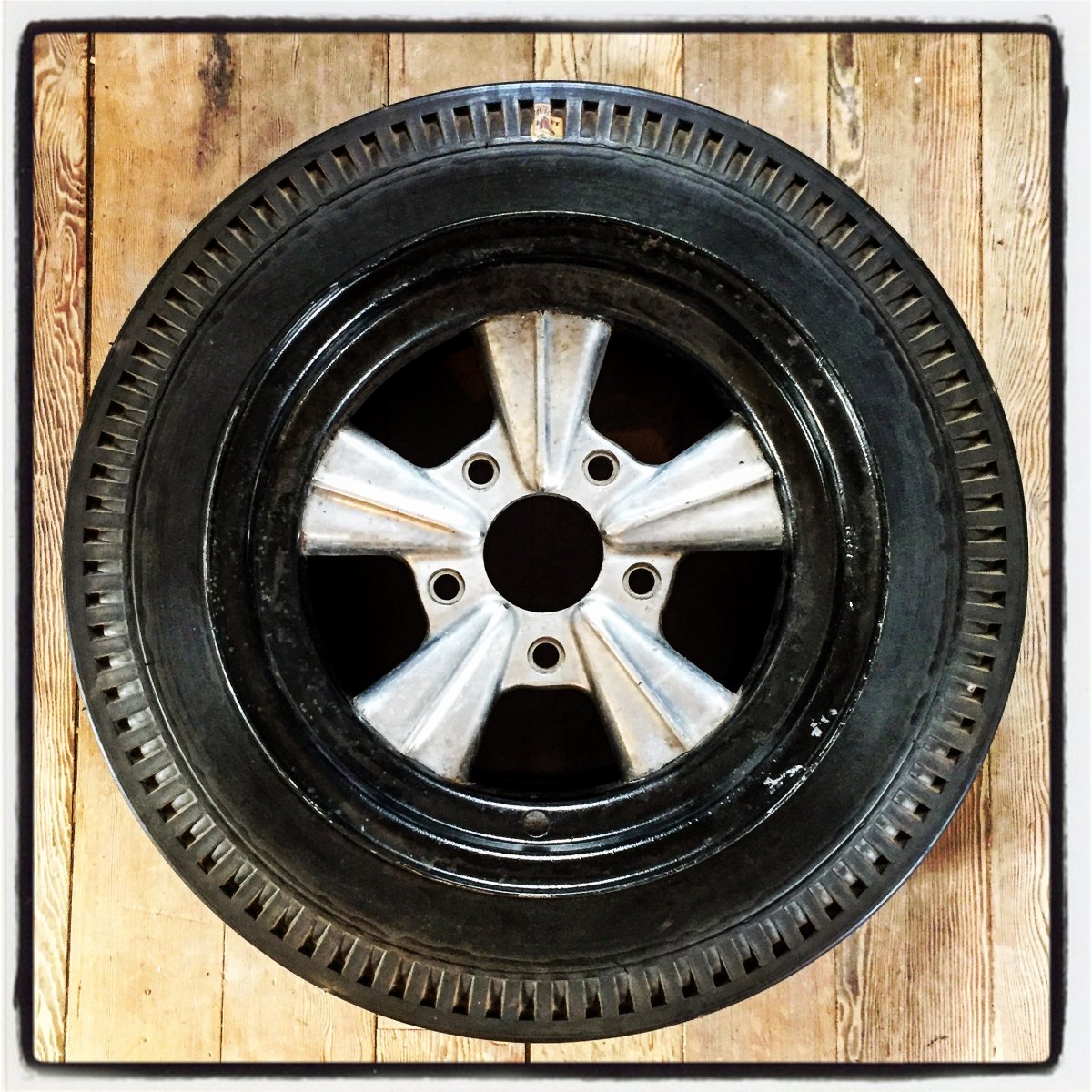

  25. Not Radirs but old legit MT Raders. Should look pretty bitchin’ with the windshield removed and a tonnou cover!
  26. 31chevymike
    Joined: Feb 9, 2008
    Posts: 1,294
    31chevymike
    Hell YEAH!!!!!! I didn't know Mickey Thompson had the first Raders spelled "er" instead of "ir". Damn Mike, I wanted the Radir single rib like you have here... Great score - where on earth did you find these MT Raders???? Those slicks look very familiar... Call me crazy, but did your Hurst slicks come with a little tag molded in the tire?
  27. I found the wheels (2) last year on Craigslist! They were on there for a month before I couldn’t stand it anymore!
    And yes on the Hurst tag. You can see it at 12 o’clock in the picture. I got those 7 or 8 years ago, also on Craigslist!
