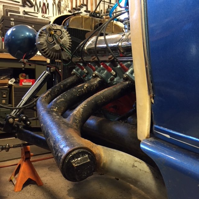

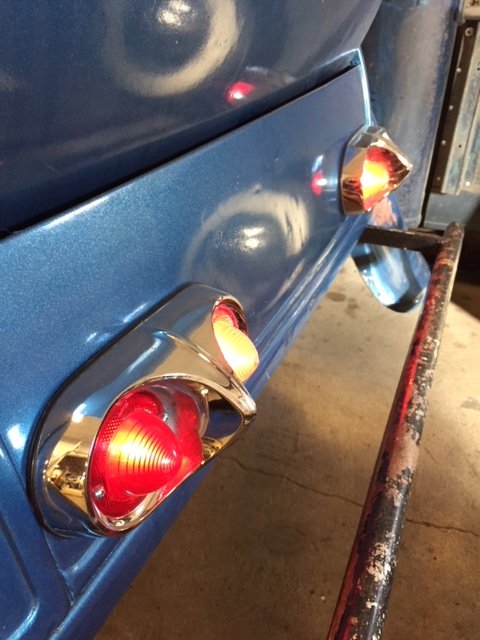

  1. I bought a new battery and ground cable (missing for some reason?) and hooked it up last weekend to see what kind of shape the electrical system was in. The head/ taillights work and more importantly the starter/ignition.
    Hopefully this link will work...
    https://instagram.com/p/BZ9wwopA2V7/

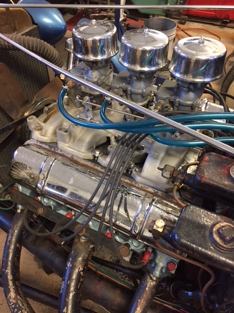

    Pretty exciting! The mechanical oil pressure gauge pumped up to 40 psi. I was hoping to see some oil at the rockers but from what I'm reading the early olds engines don't put much oil on the top end. I may borrow a friends pressure oiler and give it a shot this weekend.
    I bought some wire and ends and made up some new spark plug wires using what I could of the old spark plug boots. A few of them were cooked but a friendly Instagram friend sent some matching replacements for me.
    I put the intake back on and made some block off gaskets for the end carbs for now. I'll get it running on the center and then re tune it as I add the two end carbs individually.
    Now I have to figure out a gas tank. I may use a temporary boat tank that I have just so I can see if thing will run or not!
    Stay tuned!
