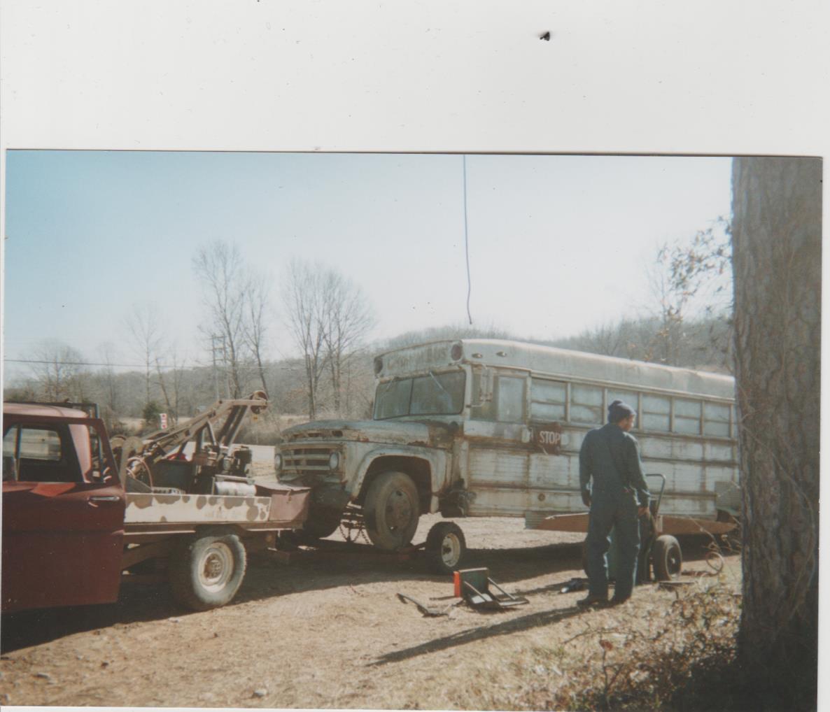

  19. The old 64 chevy 3/4 we used for a wrecker was all wound up a 60MPH with 750x16 tires. We installed a set of 19.5 tires and it lowered rpm and helped with fuel economy. It didn't pull as well but it don't bother me to downshift. 64 wrecker 2.jpeg
