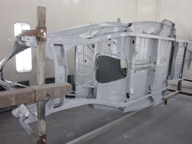

  3. Ok this is one of those really cool projects !!!!
    If your car has the original floor cut out- chances are it was rotted.
    And finding an original chassis won't do you much good unless you want to install the original floor to the original rockers and all of it back to original. At that point of wanting all original you'd be better off starting with a different zephyr. Oops only 800 of those.. & not to mention you'll be cutting and re configuring the original stuff to get the stance you want.
    Next plan would be to sort of duplicate the original and make what you want in the process.
    Running some rails and crossmembers with floor pans that look right and fit correctly and function as they should would not be that difficult to pull off. It would not look exactly like the factory stuff, don't kid yourself but it can look like it belongs there. With just some very basic dimensions box tubes can be smooth bent to those contours. Those crossmembers can be duplicated in the spirit of those shapes as well. That's easy and your desired stance can be built in to the structure as well as any suspension upgrades and choices.
    The floor pan appears to be relatively flat with some cool beads, easy enough to duplicate those too. The technical part would be the the rockers and how they tie into the body and the floor. That can't be fudged too much and that will control the alignment of the body.
    I'd love to be a part of a project like that,
    Ship it up to Ohio and we will get busy on it for you.

    If you can get a rolling shell reasonable and the floors aren't rotted, you could do as 31Vicky mentioned; cut the 4 dr shell away at the rockers and drop your 2 dr. shell on the floor/frame assembly, then be on your way to installing the front and rear suspension of your choice.
    It's a lot of labor, but pretty straight forward work. Cheaper than a Morrison/custom built frame, if his price is re

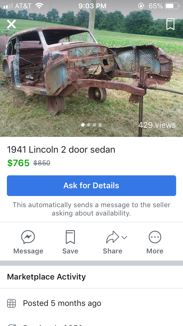

    Will this work
    It’s cheap enough
