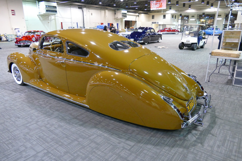

    If you're chopping the top, you can also fit the body to the frame (rather than vice versa).
    An extreme case, just for example...
    (EDIT: BTW, Ray Ericson and Doug Thompson were both involved with this build!)

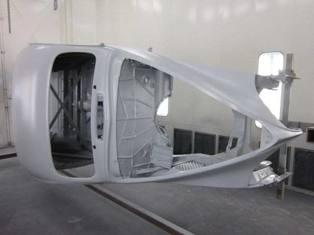

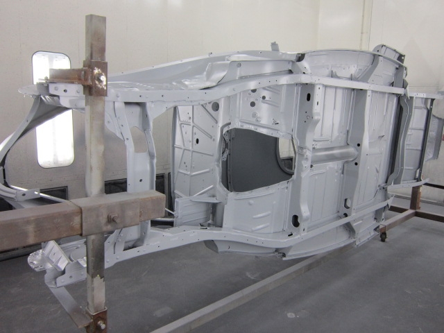

    Anthony Myrick, post: 12485162, "a Lincoln zephyr? they are unibody"
    Not really. They have a normal (for the period) Fomoco type frame to which the body is riveted/welded in an attempt to avoid squeaks and provide additional rigidity, but this does not make it unibody, at least in the sense of not using an underlying frame (as compared with current automotive design). Lucas
    Atwater Mike and chryslerfan55 like this.
    a unibody by definition
    it may look different than today's unibodys but this is one
