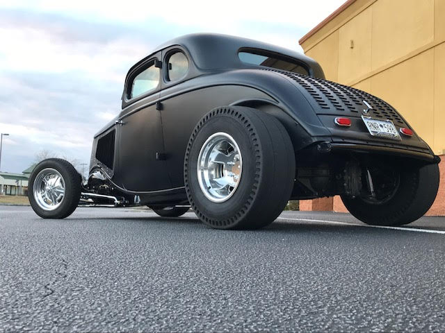

    I want to put a quick change under my 34 coupe project, but I really don't know that much about them, or what my options are.
    What's the best?
    What's the cheapest?
    New?
    Used?
    Halibrand?
    Winters?
    Rodsville?
    My project is roughly based on the Dick Deluna (Rolling Bones) coupe.

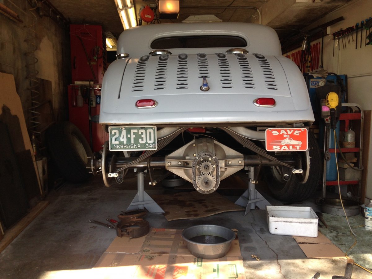

  18. I bought a used Winters "champ" rear. Got it for cheap but had to drive from Nebraska to Minnesota in a snow storm to get it. Sent the non-brake wide 5 hubs to Tman and used flanged axle shafts and Ford 9 inch housing ends and brakes in mine. I drive it on the interstates and to Joplin for the HAMB drags. I used a gear type posi at first but sometime last year the carrier bolts and ring gear bolts vibrated loose and destroyed the carrier and R&P. This time it went together with a Detroit locker and lots of red loc-tite. After it was all assembled and back under the car, I had the realization I really should have safety wired those bolts. So far-so good.
    I use 3 different sets of spur gears...one for drag racing, one for hiway cruising and a 3.54 set for everyday driving.
    Bandit Billy, Gimpy's hot rods and I use the more modern axle bells. To be really hardcore traditional, the steel bells should be used.
    Mine whines most with the hiway gears in it but it's not all that loud. If I could go back, I'd do it again.
    Most guys use a model A rear spring for clearance. 34repairs4_19.jpg [ATTACH=f

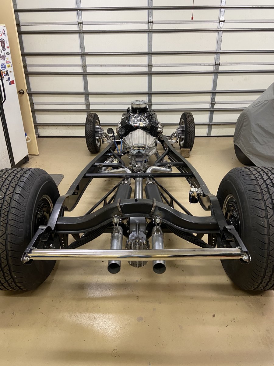

  20. So, to be a glutton I am going the DIY route for the street Tudor. Building my own outta a banjo and this 1620420939265.jpeg
    Sent from my SM-J337V using The H.A.M.B. mobile app

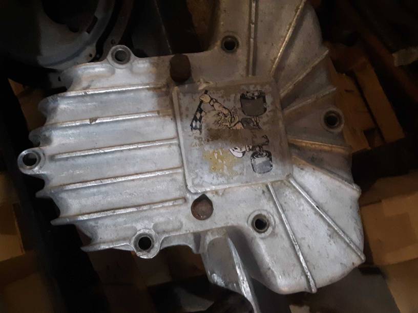

    I found a Frankland in an old dirt modified chassis in a local scrapyard. Paid $75.oo for it. Traded rear covers with Tman. After some advise from Bruce at gearheads Q.C., i took it to a local shop and they set it up with new street internals and tubes with bearing ends set up for 9" ford brakes.
    I guess its all assembled and waiting on moser axles to be delivered....for the last five weeks. Am getting anxious to get my hands on it.
    loudbang and Tman like this.
