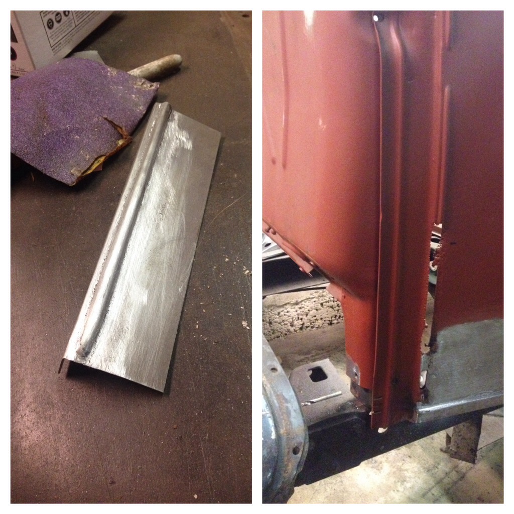

Projects I finally made a metal patch that doesn't need filler
Discussion in 'The Hokey Ass Message Board' started by 31Vicky with a hemi, Mar 3, 2014.
  1. Yep, I'm so fucking pissed off I said to my self, "Self - fuck the filler, fuck the rust removal, fuck the sanding, fuck the ISOs, fuck the material bill, and build a damn rat rod"
    It's taken nearly 35 years to reach this level of agrivation.
    Hopefully ill come back to my senses shortly but damn.

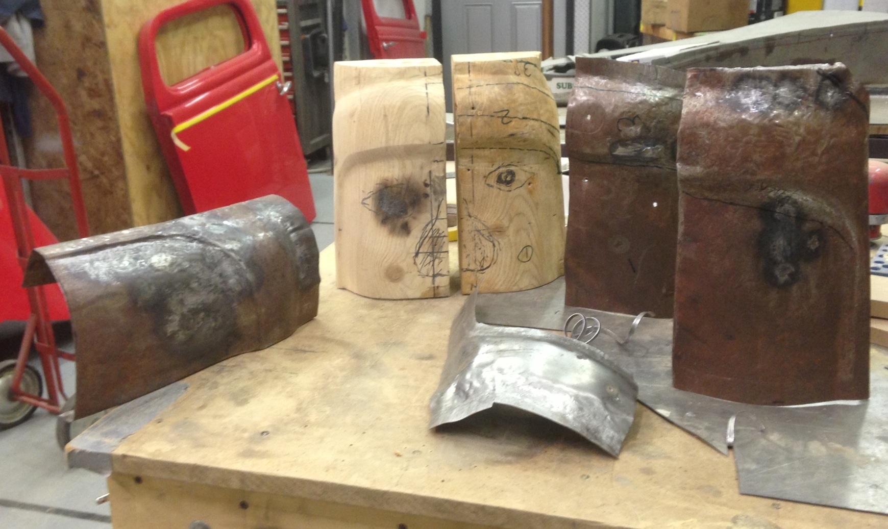

  13. Heres some pics for your amusement and comments.
    Making lots of scrap today in my fortress of solitude.
    But I have pondered this with my some 1800 select on the rocks and have developed a new plan. I will try this with 4 pieces on the hammer form and see if I can make some different scrap tomorrow. :p wish me luck
    There's just too much metal to move into to details
    This all started because the guy who was there before me rebuilt a 60" wheel well bead and only used one piece bigger than a quarter and that was a chunk of 10 gauge.
    When you say "fuck it" all of a sudden you don't need filler. Life gets a whole lot easier and cars get a whole lot uglier

    Hello , Hard wood forms work well to form body lines and shapes . The forms need to be a little smaller , than the desired panel size , and the body lines more pronounced , to give you the right effect on the outside of the panel . Also try a piece of thinner gauge metal as a test piece . Easier to form , and it will let you know the limitation , of what works .
    I have been making patch panels for over 25 years , and I still toss them on the scrap pile . Hope this helps . Good Luck , Scotty
  20. Those slightly rusty ones are 24 gauge and some weird really extra malleable stuff.

    :eek::eek: but 24 gauge isnt gonna do much for you once you have to weld it in .
  22. wow ,I get mad sometimes,but I've never given my buck a black eye
  23. There's nothing that I have access to that's going to bend easier. It just won't do it.
    In going to try to do 4 pieces of 18 gauge on the hammer form.

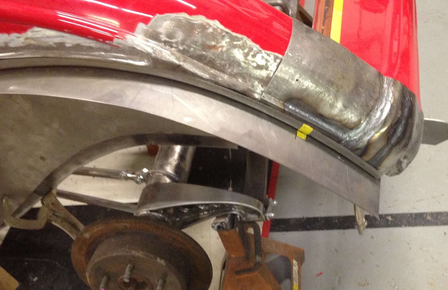

    Hey 31 get some 20 gauge !! 18 is gonna make you wanna rip your hair out .
    That's hammer formed out of 20 gauge
    I think you are going to have to make the stretch first on a shot bad then add the tapered line after you are happy with the shape .

  27. Little hammer and dolly work , little buzz thru the planishing hammer and this should be usable. Still going to need some filler
  28. 18 gauge worked over pretty easy in 3 pieces and a cut.
    I need a deep throat shrinker/stretcher for this or more patience.
