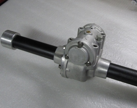

    Hey guys, I bought this steering box a while back (advertised as sprint car steering box) and have since disassembled it. I am hoping someone on the hamb can identify this steering gear. I have all the internals but would like to replace the bearings and seals, bearings I can find based on id, od, and width but some of the seals don't have numbers on them. Also the gear ratio is 6:1 and would like to find a more friendly 8:1 or 9:1 if someone makes it.
    At first glance I thought it looked similar to the box in the Doane Spencer roadster but I'm not positive and I don't have any close up pictures of Spencer's interior. Is it a Schroeder box? some sort or Norden or Franklin? and if so what era is it from?

    Nice looking piece, no idea who made it, but it looks to be based on the Franklin design. Franklin car from the 1920's, not Jimmy Franklin. Bob

    Still looking for a possible manufacturer of this steering box.
    Yeah, I've looked into using a steering quickener as a reducer but have yet to find one that looks good/cast body or traditional. I'll have to look into using the guts from one and making my own box.
    If anything I would like to have 8:1 gear and possibly reduce it to 16:1.
    Does anyone have any close up shots of Doane Spencers roadster interior? or under dash area?

    Very simular to a Schroeder (but not) Call them and talk to Gary

    Hmmmm, That's a new one for me too. If I had to guess I'd say some model of ROSS. It's definately an OEM box out of something. But has been fitted for a Sprint car or Dragster.
    Sorry, man.. My vote is to call Gary too. He's the Steering Guru. If you get ahould of his wife on the phone, ask her. She is just as sharp as he is..

    Doesn't look like any Ross I ever saw, but I haven't seen everything they made.
    Erlbacher out of Missouri?

    Possibly a Casale. They make boat stuff nowdays but years ago they made race car parts, Q/Cs and such.

    I e-mailed Gary Schroeder and he said " I don't know who manufactured this steering box. It is not a Schroeder but similar."
    Spent some time searching the internet for Doane Spencer pics. this is the best I can come up with. It sure looks similar to me.
