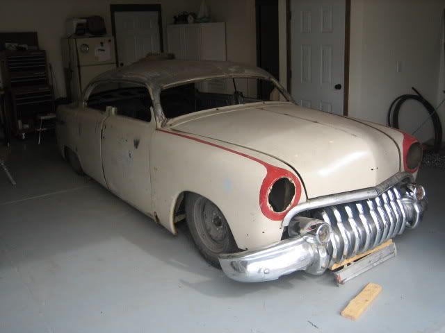

    After I ran out of lead (2 lbs.) I cut out the other b pillar and opened the whole car up. No wrinkles or twists either!
    That's the old man standing in the background.
    I also was messing around with my front bumper and got it kind of into place (it's sitting on top of some blocks of wood and stuff) I think it looks real good, but I will have to narrow it at least 7" Probably closer to 10"
    And again:
    So there you go. I think it's coming right along.

    Reinforce that floor, A and C pillars, and roof!!! It may not be twisting now, but going down the road you're sure to screw up all that hard work.

    As for the reinforcing, the roof, the A and C pillars have been reinforced, I haven't reinforced the floor, but the frame is gusseted to the truck arm crossmember. Do you think I should also reinforce the floor as well?
  15. inkmunky
    Joined: Jun 29, 2009
    Posts: 537
    inkmunky
    Yes... the frame may not twist with the reinforcements but the body will in between all of the body mounts and may cause undue stress on them. I'd run some "stringers" just to be safe. Better to do it now than worry about it later.
