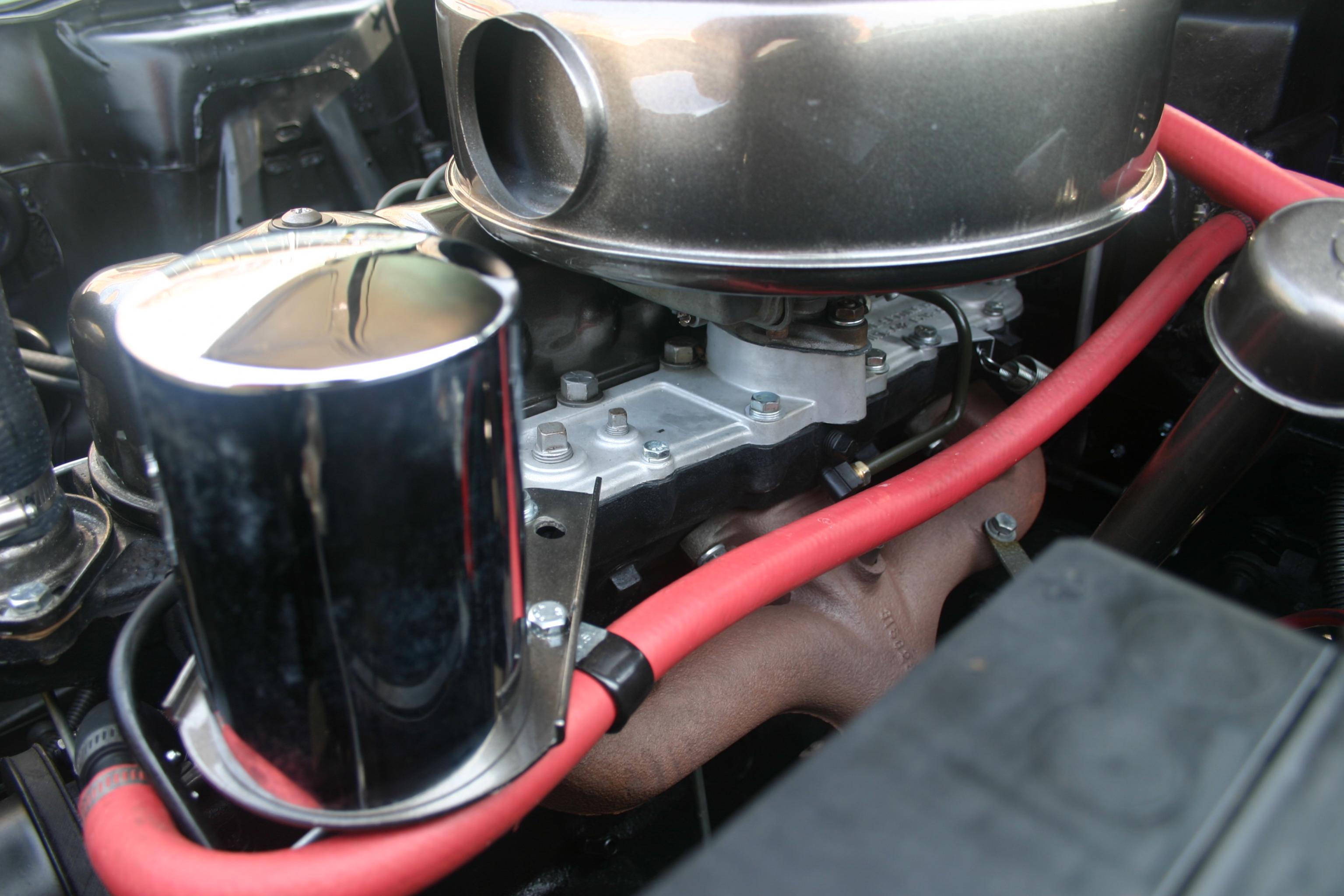

    Alright time for a Rambler update. Sorry it has taken me so long but this fn car has been kicking my ass for the last month or so.
    (My 8 year old son has also started kart racing and that has taken an unbelievable amount of time and money. What did I get myself into now!)
    First as you know this car has smoked pretty bad and I re ringed it and still had a problem with it smoking really bad at idle. The longer it ran the worst it smoked. Oil started clearing up and I could tell it was fuel. Reset the float and played with the idle mixture but couldn't get it to stop. Regular driving it was perfect just the longer it sat at idle the more it smoked. I disconnected the vacuum reservoir and the wipers and have made the biggest improvement yet. It will now idle for 2 or three min before it starts to smoke! It was instant when it was hooked up. I think it is the power valve. I need to put a vacuum gage on it and see if it is excessive vacuum or lack of vacuum. I think it is lack of vacuum. I will let you know but I think I am about to get this figured out. Man its not supposed to be this hard when you leave something stock! Here are some updated pictures of the engine and the new re-cored radiator

    Even the old 196 can look good when cleaned and dressed up with a little chrome! Do you have a vacuum booster fuel pump or are you using a vacuum canister instead? If a vacuum canister check the check valve. It might be leaking down and causing a slight vacuum leak. Old carbs have rubber parts that get bad, mainly the accel pump. The pump won't affect idle though. Might be something else in there plugged or leaking -- could be a small leak at a gasket or pulling in at the throttle shaft (bad news/harder to fix). The carb is just OLD and needs attention most likely! May as well get a kit for it and thoroughly clean it.

    Still having light smoking at idle. I just rebuilt an original carb for it and took off the later 1904 style Holley one barrel. It is now a good bit better. I also feel I had the idle speed set to low. I can almost slow this thing down to a ridiculously low idle and it still runs smooth. I bumped it up and it seems to have helped more than the new carb. I am going to remove the late model valve seals and install the original umbrella style seals soon. Still runs like a top. I hate I haven't done more to it but I needed to take a break after I re ringed it only to have the same problem.

    If you haven't driven it a lot it SHOULD still smoke. The rings need to break in. If you used chrome rings that will take quite a while. Light smoking for 1000-1500 miles is normal, with chrome rings it might take 3000 miles to fully seat though.
    Idle should be 500-600. It is low, but the thing is grunty -- ready to pull right off idle!

    Yea Farna I think I still have a combination of blow by, carb, and I hope valve stem seals. Its not bad. The biggest improvement came from bumping up the idle and going trough the carb. When I built the carb I found that the plug was missing on the side of the fuel enrichment circuit so it is ineffective and always open. I ordered a 50 and 52 jet to lean it out a little as I plan on leaving the enrichment circuit open. I think now that I don't have the carb really putting the fuel to it at idle the rings will seat and get to a livable level. It doesn't smoke driving only if it sits 30 to 45 seconds. And gradually gets worse. Cant hardly see it in the day but at night it looks like the thing is a piece of junk and thats why I haven't had any fun with it. By the way it was just a steal set of hastings rings.

    I'm not so sure leaving the enrichment circuit open is going to work, but I'm not a carb expert. Just seems to me the designers wouldn't have made it that way without a reason, but I've deviated from design on other things for my own reasons before too.
    Blow-by can build at idle if its bad, but sounds like the carb may be loading up at idle -- most likely due to that open circuit. Increasing idle speed would make that situation improve some...

    Hot damn I'm closing in on it! Farna by eliminating the enrichment system I am basically removing the power valve. Instead of blocking it off I am leaving it open and rejeting accordingly. I have seen Holleys blocked off on plenty of streetcars. You have to give it a little more throttle pulling off when its cool but that is the only noticeable thing other than less and less smoke! It is what it is. It is just a cool cruiser. I wont be trying to pass a line off 18 wheelers on a two lane road but thats not what I am doing with this car. I love driving it as my everyday transportation. I needed a break but now that I feel I may be getting this smoke deal handled I can start working on some of the other aspects I want to improve on. If it runs lean I will fatten it up
