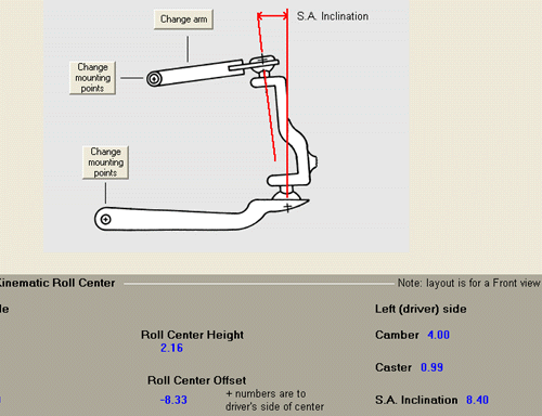

    Here's something else to consider if you are going to haul heavy loads with your truck.
    An IFS will tilt the tire out at the top and in at the bottom when the suspension squats under a heavy load. You'll be driving mostly on the outer edge of the tire, causing that edge to wear out faster. It's because of the short arm / long arm set up.
    They are designed that way on purpose to provide better grip with radial tires. Radials have a soft sidewall which "rolls under" just a little when you're going around a hard corner. When one side of the car is heavily loaded due to cornering, the tire tilt helps to compensate. However, when both sides are heavily loaded because you're hauling something heavy and you're going in a straight line, it just wears out your tires for you by driving on their edges.
    With an I-beam front suspension, the tires are always perfectly perpendicular to the pavement no matter how much the suspension squats under a load. That's one reason they use them on most 18 wheelers.
    Plus, if it has several leaf springs packed on top of one another (unlike the coil springs in the picture above), then the suspension is progressive. In other words, it's soft without a load and stiffens up as the load increases. The IRS's rarely do that.
    If you are planning on carrying heavy loads with your newly dually truck, I'd vote for the straight axle mostly because of the longer tire life, but also, it's a more rugged set up / less expensive / already engineered and got the bugs worked out / and of course the cool old truck factor.
    If you're not going to be carrying heavy loads very often, I'd probably go for the IFS due to less unsprung weight / smoother ride / better handling.
    The fact is, this is only my opinion, but it's based on fact (in my opinion).

    The other way around isn't it?
    Because in your illustration your upper arm is already past its level point and any dropping of the suspension will cause the upper ball joint to pull inward.
    The lower is still level and with the additional length on the bottom the angle change will be minor compared to the top.
    But other than that I agree!!! :D
  6. bwahahaha, thanks for the refresher...:D
