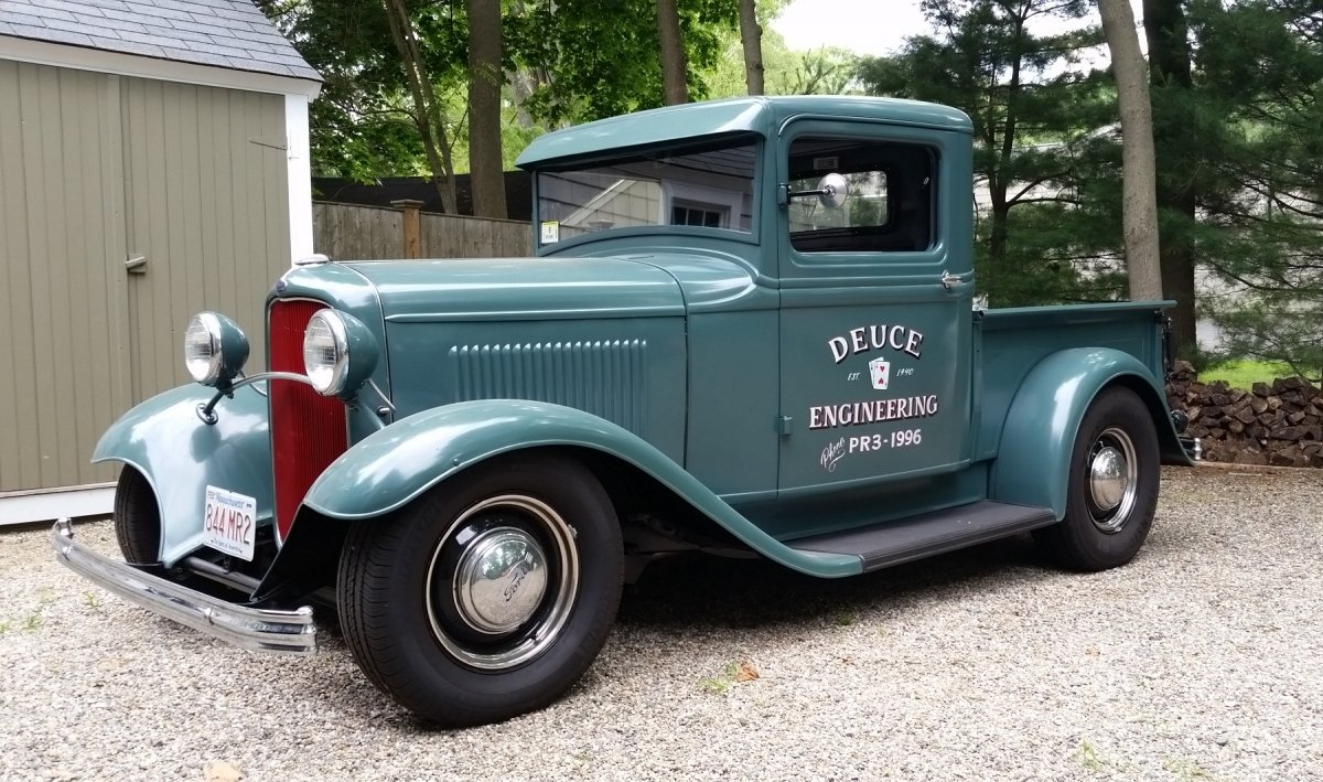

    I can get you the info on the set up (axle width and tire size) under this Deuce pickup later today if you like the look/stance.

    Baron - yes that would be appreciated. From the pic, looks to have adequate tire /fender
    clearance. Is truck running disc brakes? Thanks

  8. Baron
    Joined: Aug 13, 2004
    Posts: 3,637
    Baron
    Just got off the phone with Mike. Axle is one of the narrow 46 inch ones(not even sure if they are still available, not that you'd want one anyway). Running 56 F100 front brakes, and the tires are 205/75-15's on a 5 inch wheel(custom off-set to move them out 3/4" to make up for the narrow axle). Probably not much help other than tire size. I second the So-Cal dropped I-beams. Had them on a 1/2 dozen of my cars. Excellent product(s).
