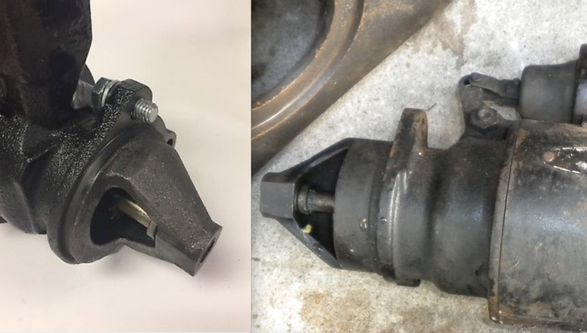

    It's starting to click now... I checked Claymarts numbers and what Anthony mentioned on ebay. I remember truck specific and wouldn't interchange to cars as the current ebay ones do. The left pic is the snout for the #1107670 compared to the one I was told was the correct truck starter (for sale if I would buy a complete trans.) The snout is a lot longer. Maybe to clear the bulge in the torus/flywheel? thanks guys - I'm learning.
    Milan, searching now for that number.

    the difference is on the drive end, it is longer between the three bolt flange face and the the end of the drive end housing the armature is longer as is the drive housing I sold my Delco unused reman along with an not flywheel about a year ago, I can't recall the number, but will look for it...

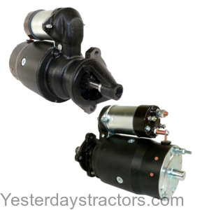

    when ya google the 1107643 number, a tractor/equipment application comes up

    Thanks Anthony, I looked at one of those and the snout isn't as deep as pics I found. Andy Is right I had to do a double take the starter looks to hang upside down. Never thought an old small block starter would be this hard to find... learning new things.
