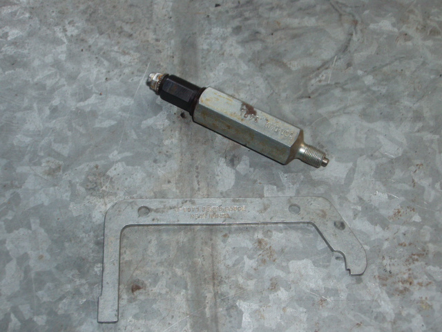

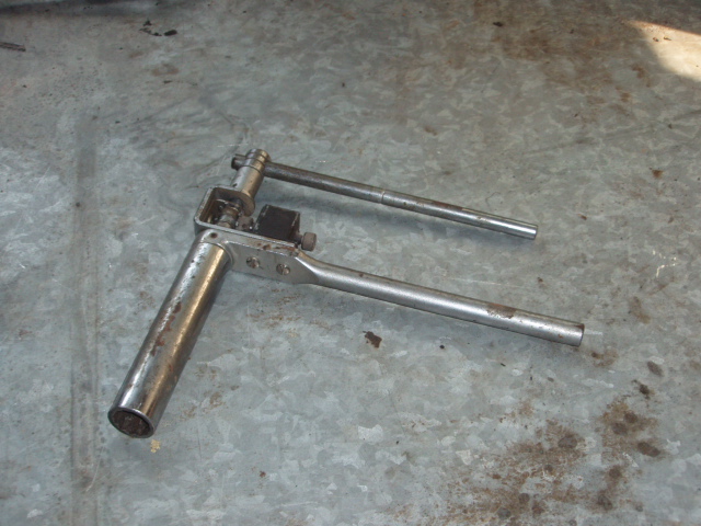

    If you get a chance to come across these tools it will make adjusting the servos and bands a lot easier. Picture with the two tools are for internal adjustments. The other tool is for external adjustments for the earlier hydramatics where you adjust from inside the car.

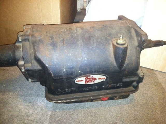

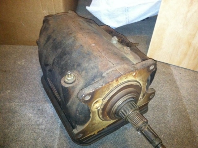

    Just recieved my B&M BC series HydroStick today....Holy cow.I can see why hydros were used in some tanks.This thing has an output shaft that looks like it should be on a piece of industrial equipment,or on a giant tractor or something.Pretty confident I will never break this monster.

    As promised.... ImageUploadedByH.A.M.B.1379275103.337306.jpg ImageUploadedByH.A.M.B.1379275141.733007.jpg ImageUploadedByH.A.M.B.1379275160.771724.jpg ImageUploadedByH.A.M.B.1379275187.722829.jpg ImageUploadedByH.A.M.B.1379275210.141306.jpg
    That last one is the money shot....

    Some of the guys might not know what the "lever" on the rear band adjustment is for; a little after market item made to release the band for the tow back after a run. It helped to save the trans from wear/tear/burning up. Also, look at the patent number on that B & M Hydro Stick Trans; go to the patent office website and look it up; it's for the "T-Valve" B & M invented to hold their trans in first gear without it shifted into second automatically. It also might be of interest to the Hydro Group. Butch/56sedandelivery.

  29. You are talking about the deal on with the little universal that sticks out of the top of my tranny. They didn't all have that. Yep for flat towing. I had to ask an old timer.
    Here is a little trick that I learned from an old gasser racer (old enough to have been involved in the cam wars) when I was a kid. First gear is really low in these trannies. He told me that most guys can't shift as fast as the you loose first gear so most of the fellas that raced them (at least on blower cars) started out in second and let the tranny make the first shift.
