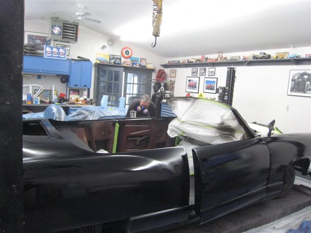

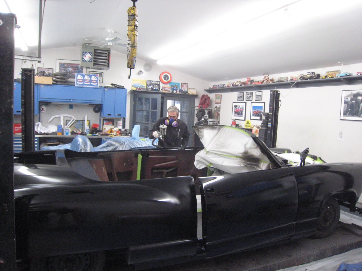

    I am super pleased with the system. There is almost no over spray and it works just fine for me. I'll be painting the 37 5-window coupe over the winter and the lower part of the RV this spring. The fact that I can paint the RV outside with no over spray to cause concern in my neighborhood is a good thing.
