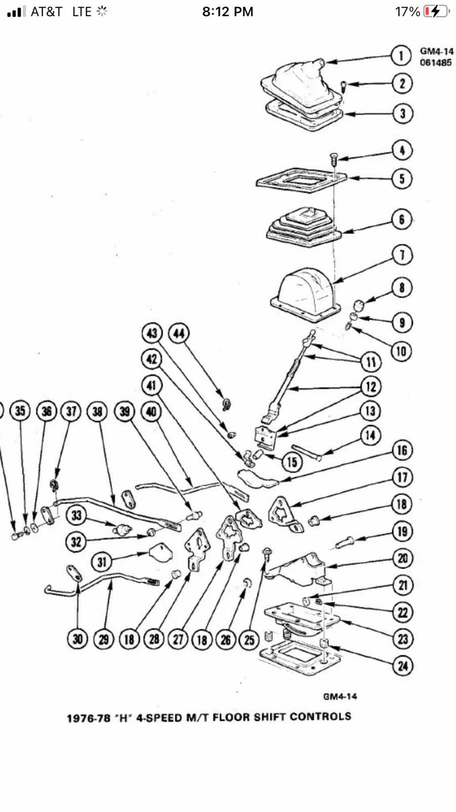

  7. The H-body (Vega, Monza and other GM variants) Saginaw 4 speeds did not have their shifters mounted on the trans extension housing. The casting had the mounting bosses but they were not drilled and tapped for the shifter bolts. The original shifters were mounted to the floor pan or tunnel somehow.
    If this is the only difference between the H-body extension and the one used on the other car lines you could probably drill and tap the mounting bosses and attach any Saginaw 4 speed shifter. Or swap on an extension from a non-H body Saginaw trans, providing that everything else is the same. Check that the speedo drive is in the right place and that you have any other mounting holes in the right places if you need them. And you might want to make sure that the shift levers on the side cover are laid out the same way.

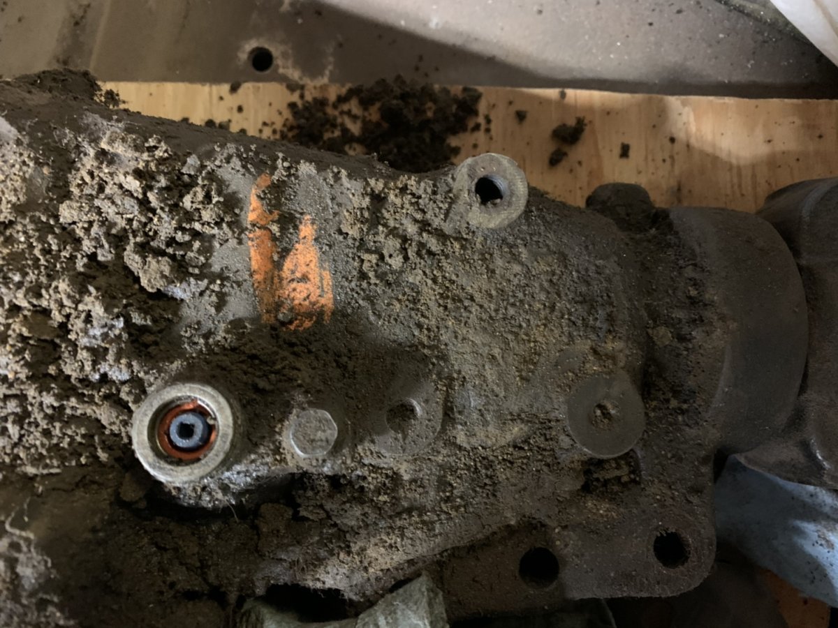

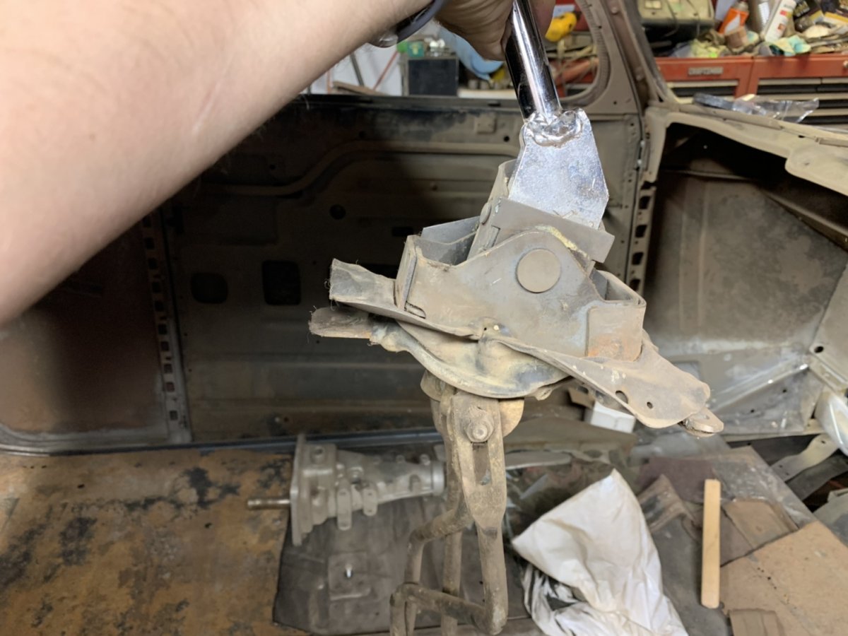

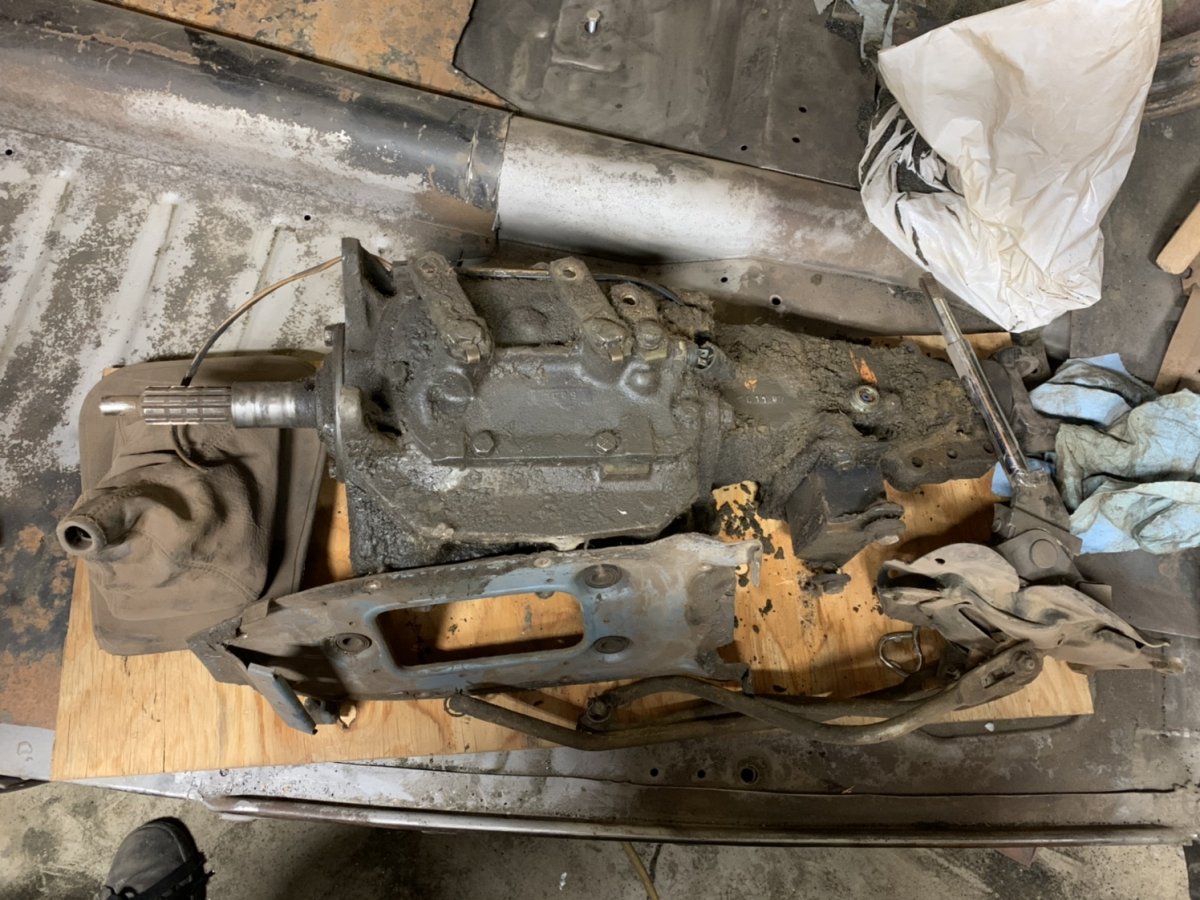

    Here’s the factory shifter, trans, and tunnel bracket. I just don’t want to set my El Camino’s floor up for this thing, especially if I change to a different trans later.
    It looks like the bosses are tapped on the trans. The parts are obviously not sitting in the El Camino.

  15. Just an FYI, but that shifter set-up is higher and further forward than the Muncie will be. If you fit the floor for this combo, the Muncie shifter will not fit in the hole.
    lewk likes this.
  16. That shifter your holding is the floor mount for the Monza that was mentioned earlier - and does not bolt to the trannie.....if you didn't figure it out.
    lewk likes this.
