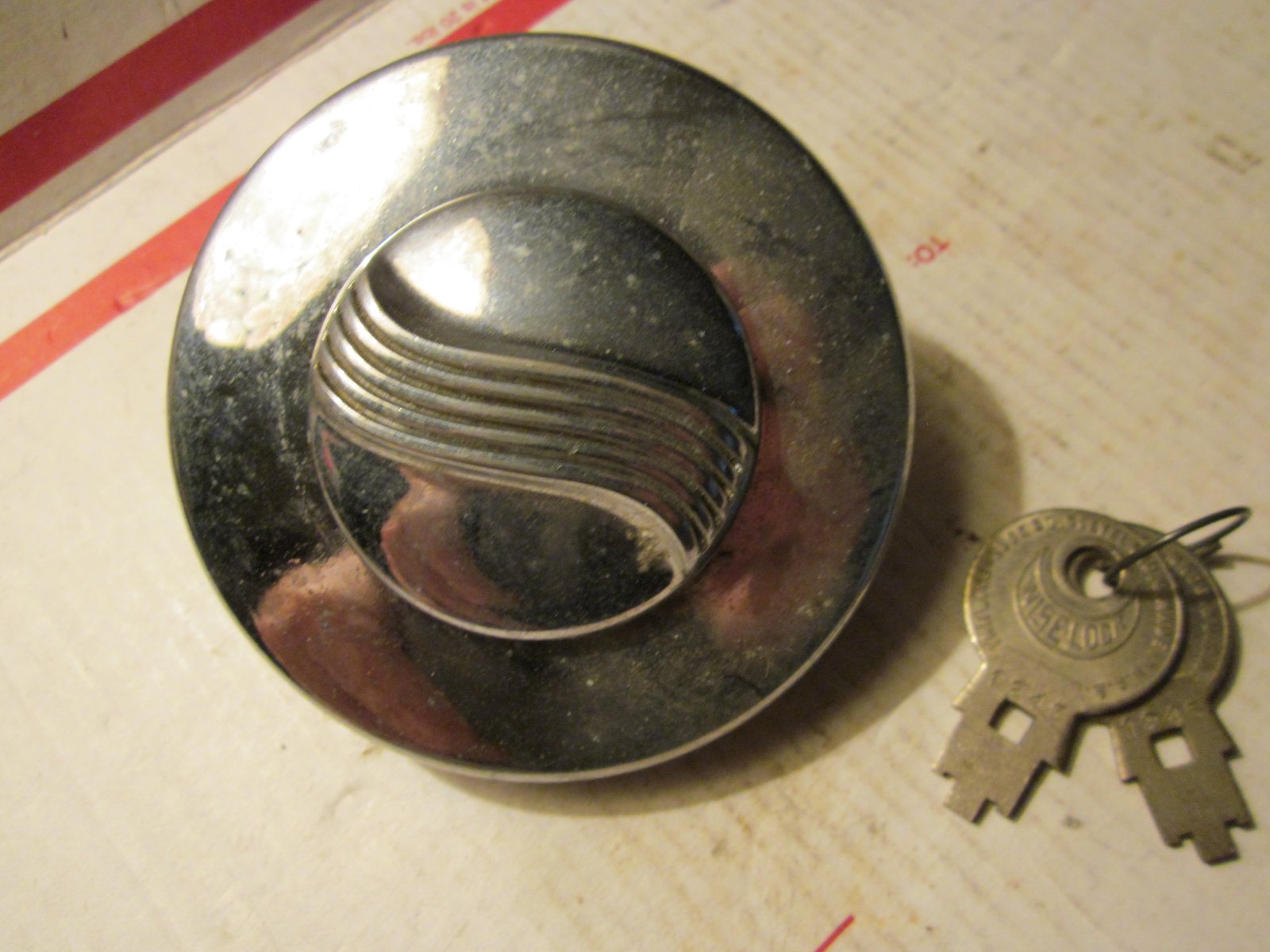

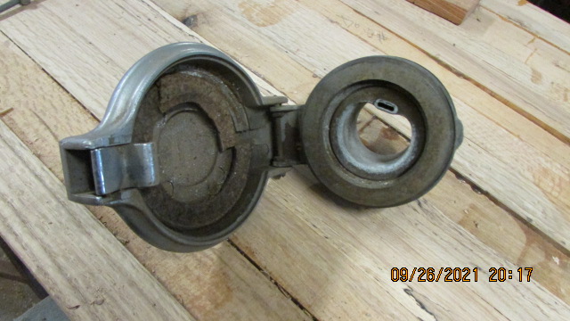

  5. IMO, you're asking the wrong question.
    The better question is "What did 1950s street roadster builders actually run?"
    The answer to that question is most likely either stock Ford or something from a racecar, or possibly military surplus.
    I chose a locking '48 Ford cap for my mid '60's style sedan:

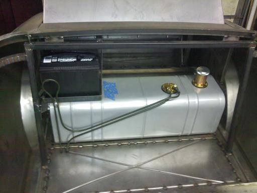

  8. My thoughts too; keep it inside.

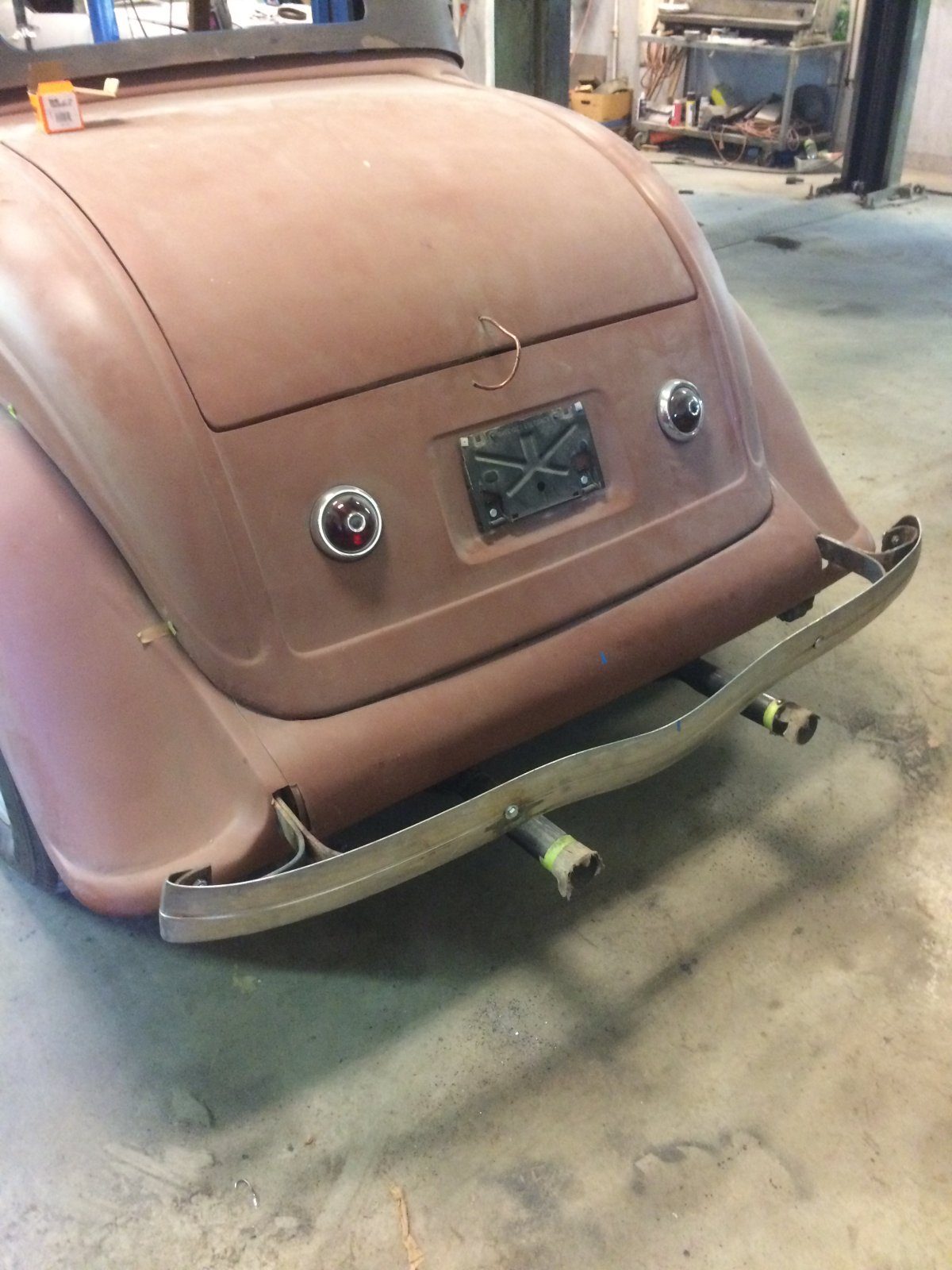

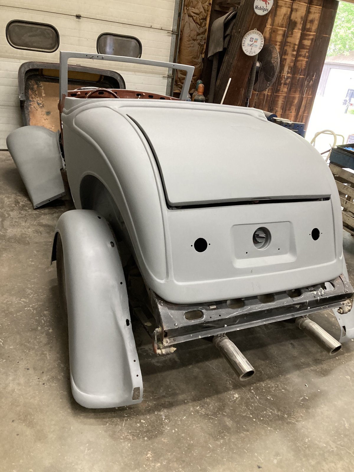

    IMG_2994.jpeg IMG_1192.jpeg I chose the hide it behind a pull down license plate route IMG_1192.jpeg

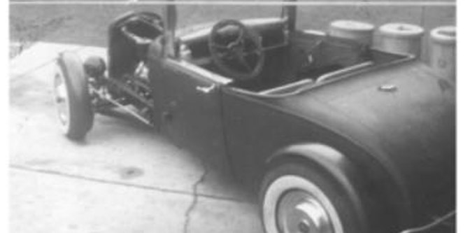

  10. Inside fill you have to worry about spillage. I've always hated that. Especially with a finished trunk.
    This is my late 50s built channeled roadster.
    This is the bell Auto Parts Special. No filler any more on this one, but you can see the old hole in the quarter. Car was likely restored in the 80s. Old channeled hot rod body too. I'm less fond of this position than the tulip panel. But thought it was worth posting.

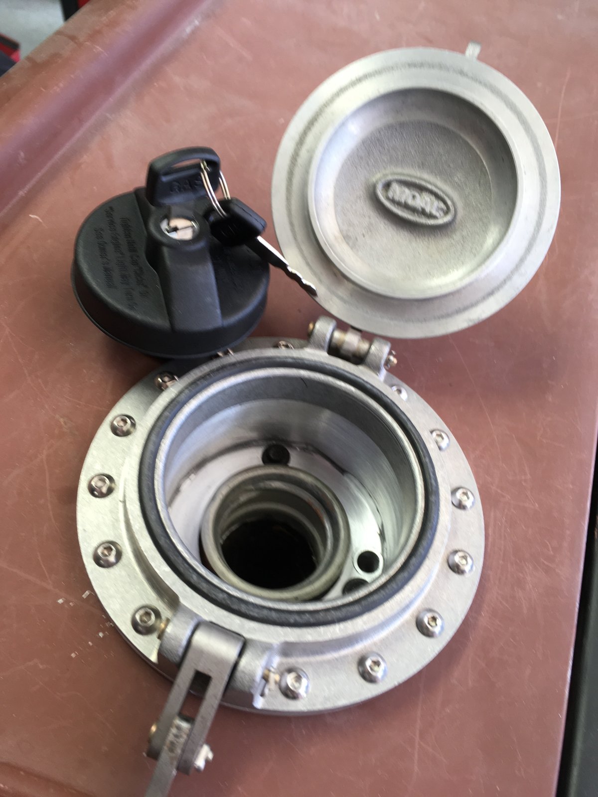

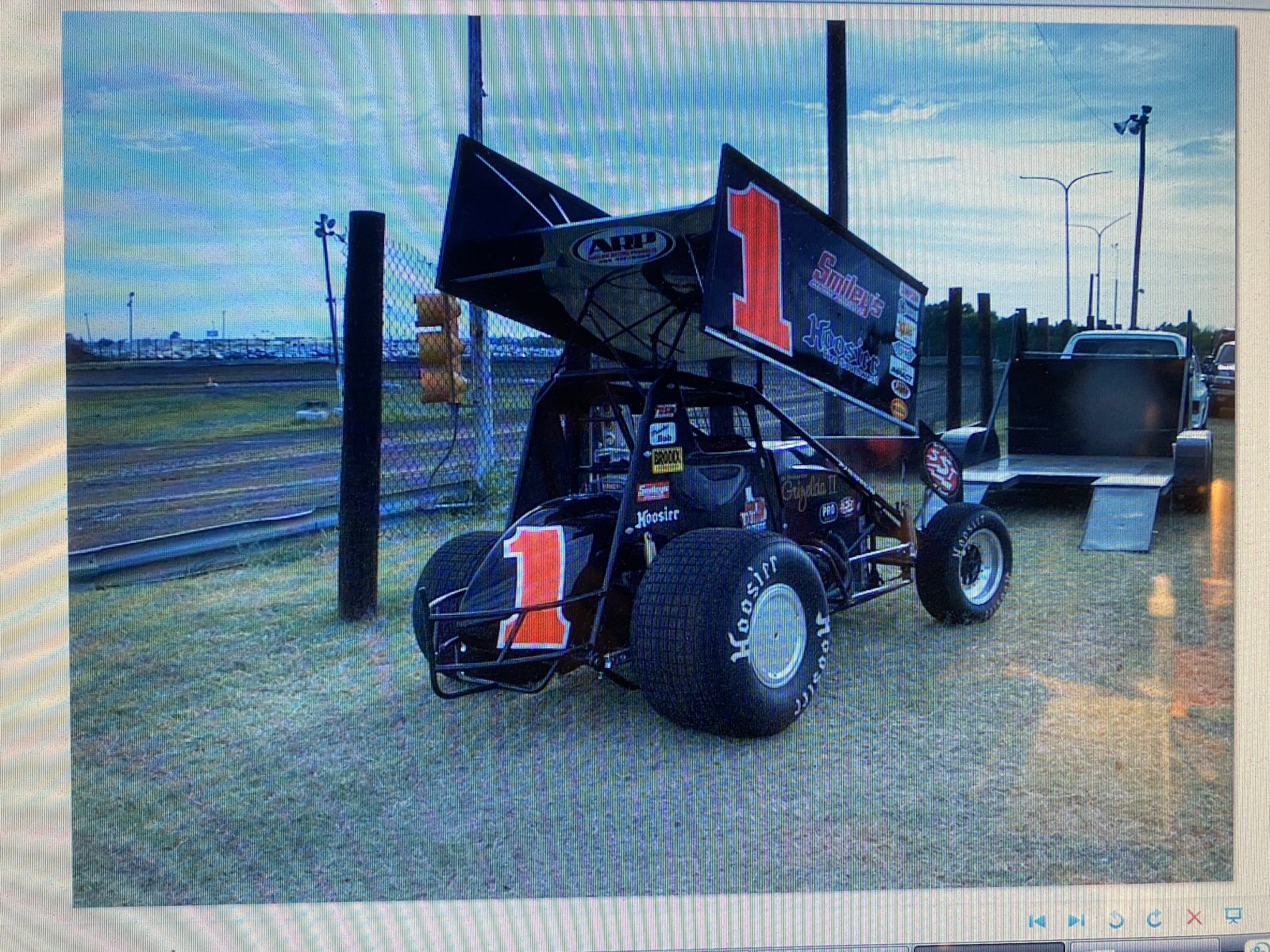

    Because I run one of these #1and love louvers I run one of these with a locking cap inside #4 and my license plate. I like black and polished aluminum IMG_3264.jpeg IMG_4854.jpeg IMG_4853.jpeg IMG_1217.jpeg IMG_1622.jpeg

    A friend almost lost his 50 Chevy pickup because the battery shorted out while he was working under it in the garage. Battery was behind the seat. He was lucky enough to get it out, but lost the whole interior and paint off the cab (battery was behind the seat). The proximity of your battery to that fuel line and fuel tank give me pause for those reasons. Maybe a sealed box vented elsewhere for the battery would be better in this case?

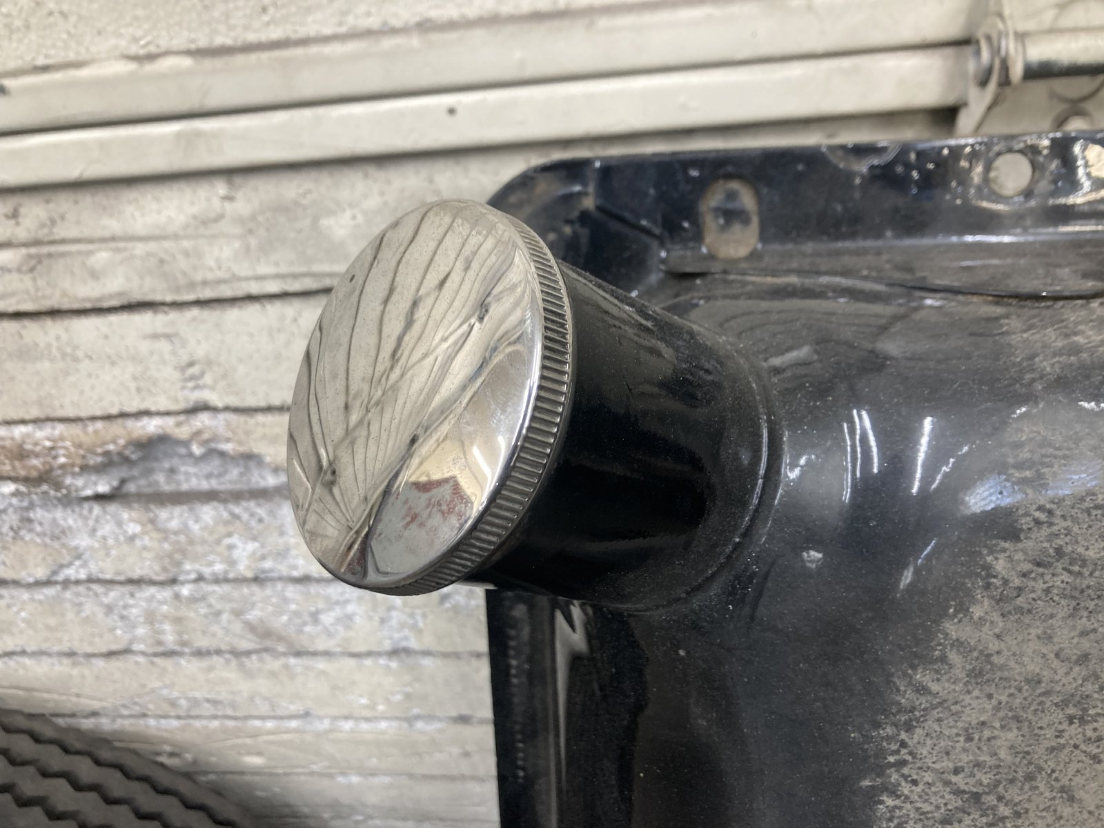

    I probably have one of the most expensive gas caps in history. That's not a brag, that's a realization of my OCD, or detail orientation, stubborness, or stupidness, take your pick. But I got what I wanted, and am super happy with the end result. I wanted the stock style, chrome gas cap on my '32 tank, but I wanted absolutely NO LEAKAGE PERIOD. Stock traditional looks, with modern guts. So this is how I achieved this. First let me say I didn't do it myself. I came up with the plan, and the parts, but the Veazie Bros. in Pomona, CA (former employees of the So-Cal Speed Shop) made it happen. My hats off to them! I started with an off the shelf, stainless steel, 11-12 gal. tank from "TANKS", Inc. These come with a chrome, stock looking cap. The look I want!, but with the flat rubber gasket seal, and the cap that only does a 1/4 turn and that's it. This is a sure fire way to develop a leak soon after the purchase, or at least as soon as the tank gets painted! So I also bought (from Tanks) a stainless steel filler neck with the straight "pipe thread" and brushed aluminum cap. This has a superior seal, but not the right look. I took all this to the Veazie's and said, "Ok boys, here's what I want." Take the filler neck off of the tank, and weld the new filler neck on. Now, take the chrome, stock cap and "gut" it. Take the brushed aluminum cap and put it in the lathe and reduce the diameter and the height so it just fits (unseen) in the gutted chrome cap. I suggested epoxy to secure the now machined aluminum cap to the chrome "cover" cap. And Viola! A cap that looks correct, with the guts of a modern, straight thread, o-ring cap.
    (NO LEAKS!) I think they said it was about 15 hours of shop time, but I got what I wanted. When I show the car, I'm proud of it, sure. But I think I'm most proud of my gas cap. SILLY!

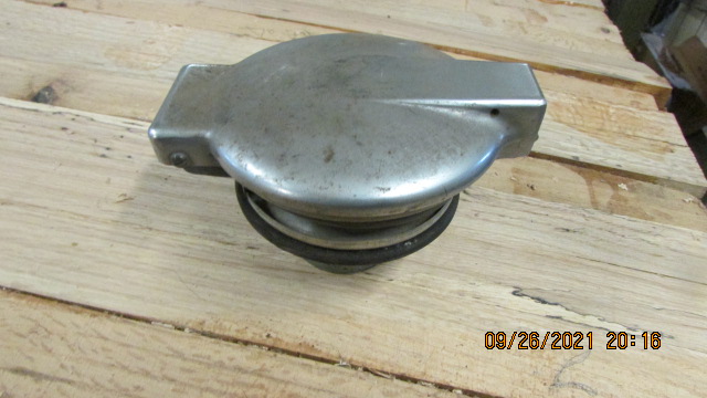

    Like hitchhiker said no fill in trunk, IMO. I have a TR 3 or so flop cap if you want it I'll mail it out to you.

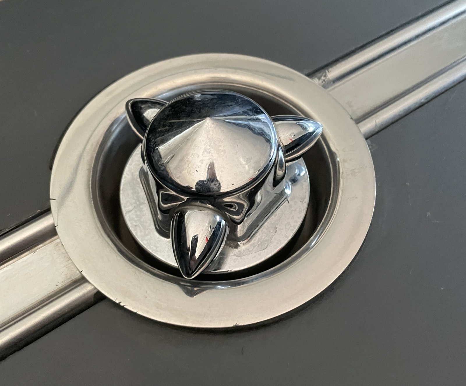

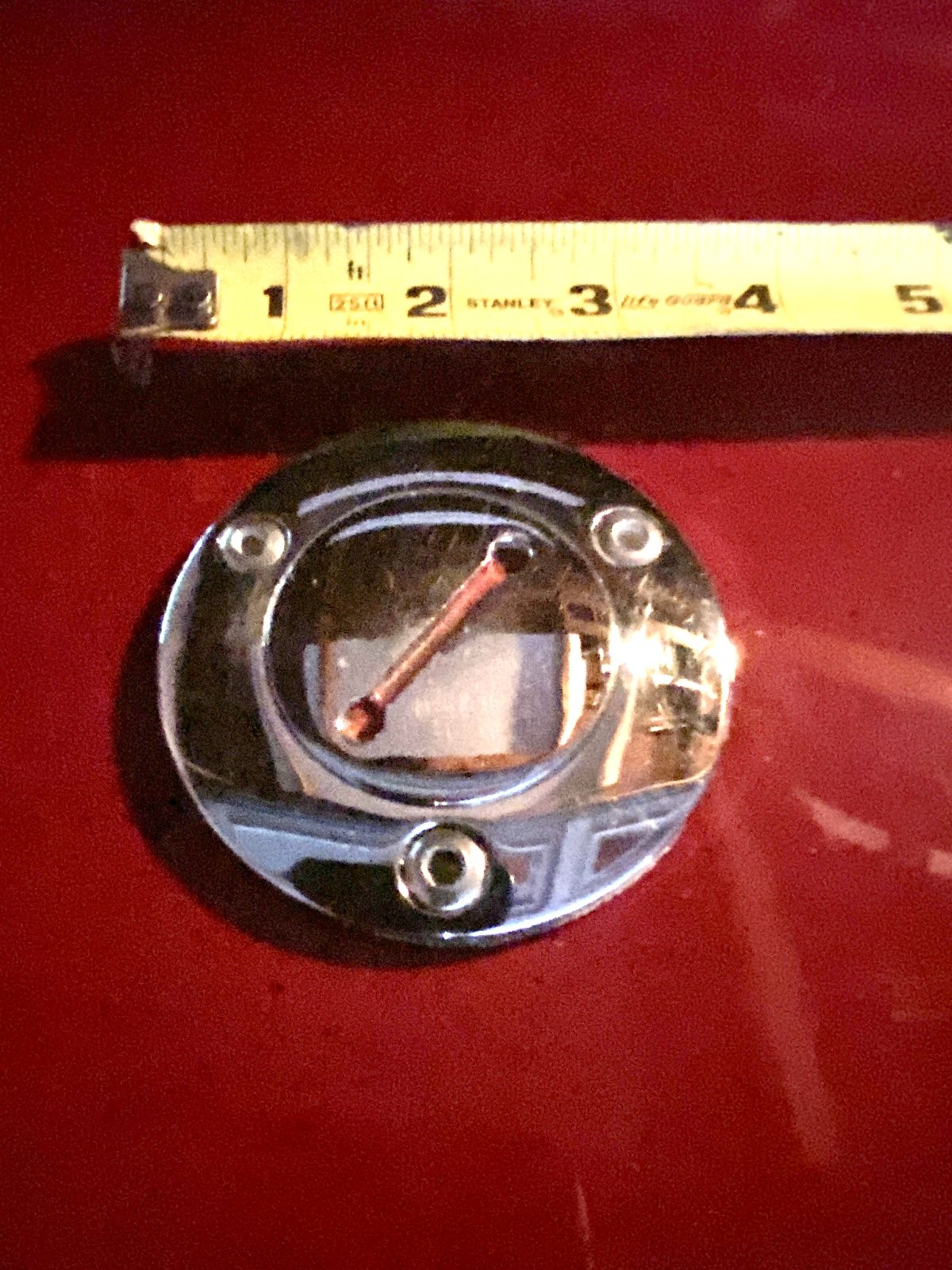

    Rather than blending in, maybe it could be a detail. This is a sink drain bezel with a vintage Harley accessory cap.
