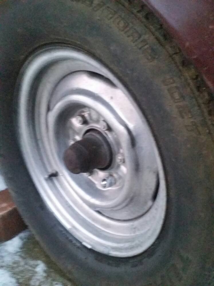

    Late 60s Buick caps will clear the hub. I was running a set of 67 Riviera caps before I made a set to fit.
  11. henry29
    Joined: Sep 5, 2007
    Posts: 2,878
    henry29
    That's a 60's truck wheel.
  12. Derf in Ky
    Joined: Feb 16, 2012
    Posts: 28
    Derf in Ky
    Here is the rear rims..
