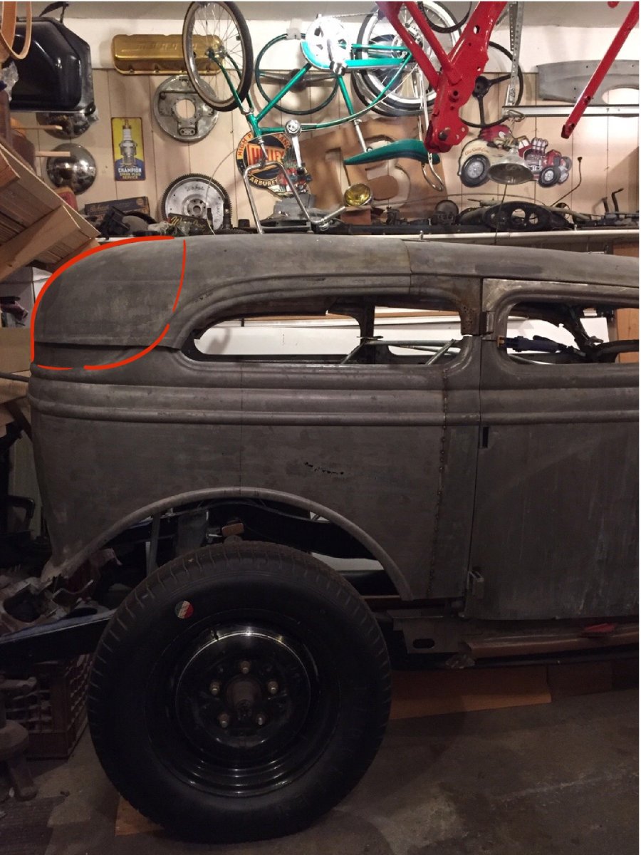

    @Stogy thanks as always. The bobbed rear frame horns are awesome!!! I don’t know how I’d pull that off back there with the spreader/push bar. I really don’t want a smaller tank but it could be cut side to side to shorten it up. Not an original idea but a louvered rear belly pan may be in order. I sure would like to see the car and frame except the tank and rear horns in the green color.
    You did great on the quarter window. I think the back roof portion will end up looking less squared off then your pic.
    Yes my garage is a hell hole.
    As for Mr. Terry, thanks so much for everything including being here the whole time. I hope you and so many others may have a chance to take her for a spin someday. I wonder how shoddy she might run on a road course?
    I don’t see it as that altered from Henry’s original design much more than any other chopped car or custom. The bulk of what’s changing its appearance is in the chop. As for the main hulk of the body I don’t see it through 33-34 eyes. I keep focused on the crazy notion of it being a 32 1/2 Tudor. Maybe a Sport Sedan or Concept pre production car? Remember my first initiative for doing this is the belt line and door shape. If you recall I stated how I knew it was so similar to the 32 3w. I would have never done this project without that key ingredient. Again for everyone I’m trying to make a Tudor version of a 32 3w Coupe. I wanted a Sedan for the family and quite frankly could never afford a 3w. I even considered using 32 3w header and cowl. This was ruled out from expense and labor. I actually think the 34 header looks nicer anyways and it’s sleeker design lends to my Lakes progression.
    Although my front end should come down a little I think we’re looking as fast as Jerry’s 394 car only less mean. Especially once I get the roof right. I can’t compete with @chop nor would I.
    Now cutting off the Tudor section. Are they that much different to the bulk of the non-knowing? Imagine if they were in the same paint color.

    Just thinking about that body line today.
    Not sure what I would do with the back end of the window but that’s your job I guess F6E3A367-80C6-43CA-AF2D-34F2A56FF87C.jpeg C4EB7FBB-6141-4584-821A-C1C323D1D7B3.jpeg

    Yeah @Tim, the roof still gets slid forward. I’m not ready for that yet. I’m not even working on the body.
    I will remove metal from the bottom of the top panel. Leaving a section where that window body line stuff curves down to fit where needed. The tops of the quarter panels above The beltline in back curve slightly forward not vertical.
    But you got it right there. The fat body line in the corner above the belt line gets cut and slid forward. Then a patch is put in the space left behind. I’m torn on what size to let the rear window be. I planned to move it down into the lower panels to limit the amount of chop and retain some visibility. Now a I worry it will just be a useless slot. I just got to put my “Buy War Bonds” waterslide decal on the glass.
    Either way it’s all gonna look so good.

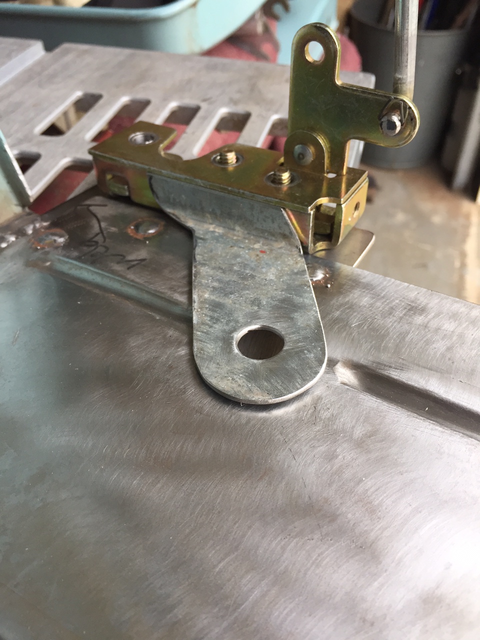

    Four fresh little reinforcement brackets out of scrap. They’ll get tacked in after I get the holes centered. It dawned on me that the latches get the most of ones body weight. If they were to bend inward they could put the release rod in a bind or maybe even cause themselves to unlatch. I wanted to also strengthen the hole in the thin side material that more so gets all the weight first on two 1/2” bolts. I had room for a washer and thought why not combine the two dilemmas with one solution. Is they’re a online degree for backyard engineering?

    Could you use some sort of a rubber bumper under another part of the seat to help bear some of the weight and keep the latches from rattling?

    Yes, just like a door, give it a little preload? The strikers fit very well and I suspect it would only be an empty seat that would rattle. Weather anyone could hear it over the straight empty 36 driveshaft tubes and blown Flatty with no substantial interior? Dunno.
    I know it’s been a long process and most probably don’t care about building some weird two-off seats. I can’t wait to show you all the finished pieces. I etch-primed one today on the inside surface and it’s really starting to look the part maybe more than I envisioned. I got the pins for the front mounts and clear red plastic covered braided steel cable for the pull clips. I’m painting the pins red and making egg shaped washers for the pins to go through the main fat part and the cable through a hole in the small end with a little bend in it away from the seat bracket. I’ll tack these washers on the insides of the front seat brackets. When you pull the clips and pins you won’t loose everything. Does that make sense?

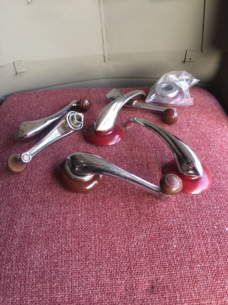

    I think the 40s handles will blend in nicely with a little attention to any brand new pieces. I have another chrome door handle on the way to swap out the nickel one.
    I still need two more escutcheons for the quarter windows and may replace a couple knobs to get a better balance of the oxblood stuff. I was super excited to get the ones for the door handles. I think those are 37ish? They don’t look so red here in natural light. I love how the window crank knobs have passingly the same shape and color that the 40 shift knob has. It may seem strange to some that I would bother on doors with out interior panels.
