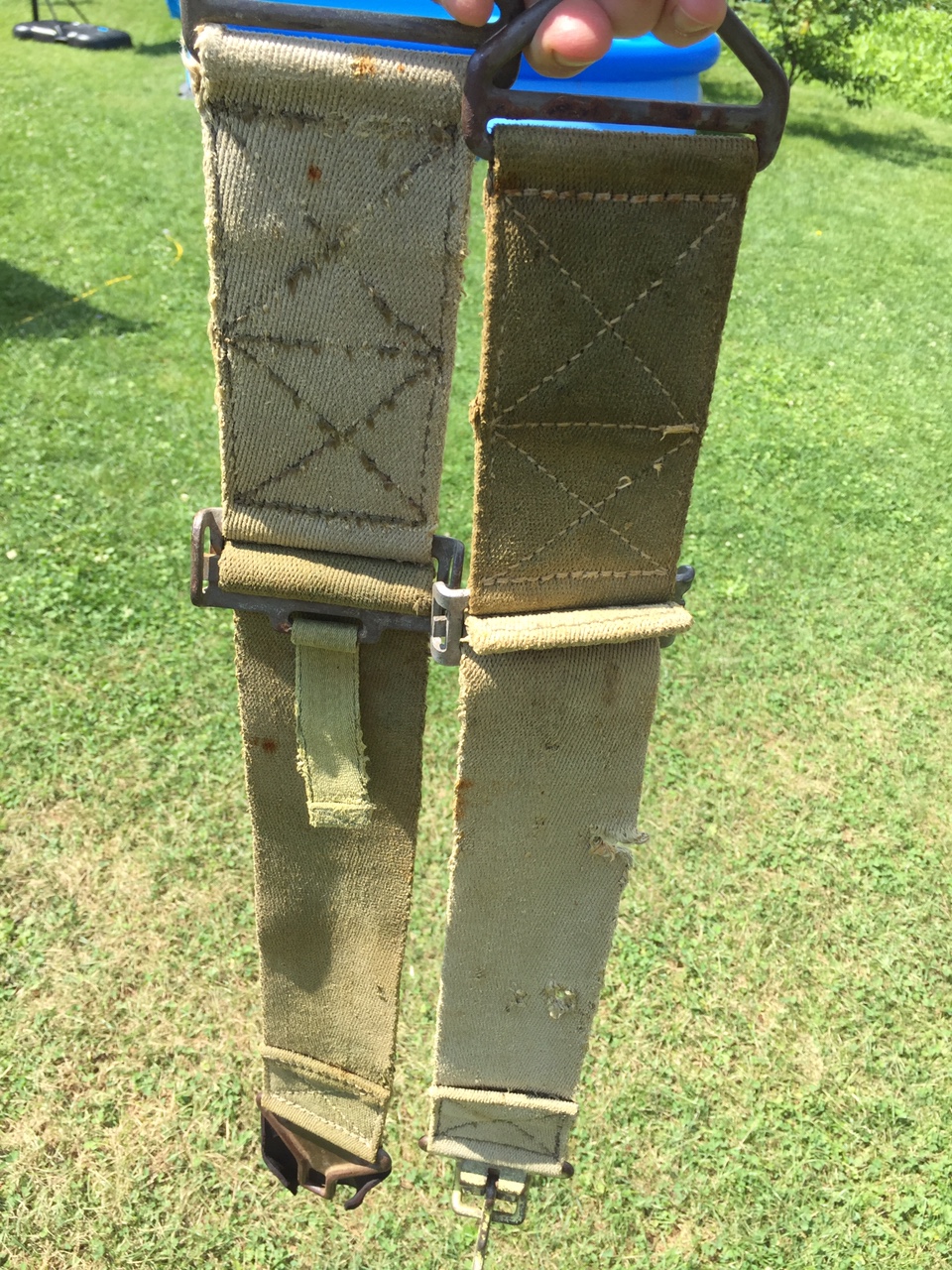

    Here is the only one that “was” finished. I used a old can of aged oak that I tinted for my truck bumper. It was all gel’d up but I dug into it anyway. It looks totally wrong so I’ll pick a new can up and tint it as well to get the results I want.
    As for the seat base. If you recall the were mid century theater seat. Well, they flipped up in the original intended form. So long ago I devised the idea to make them adjust. But just a little to accommodate pesky passengers who would most likely have distain for what I would deem a sitting position worthy of a dog fight through traffic. Insert Snoopy climb, death spiral, and machine gun sound effects here.
    Oh and the entire seat flip forward to get in the back seat.

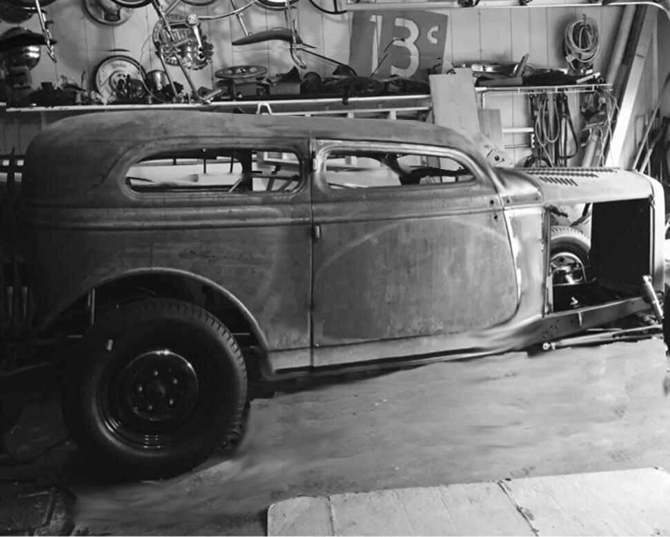

    Runnin shine
    @greaser...
    Well there was this
    Which was a lot harder to fit then one would think.
    Then there was a trim to the b pillar
    I just overlapped the rear part of the roof for a visual. The front roof section has to be leaned back more and this requires a section taken out of the front roof half. I am pondering leaving the windshield it’s current size and cutting the header to place it further back up the roof panel? I also am going to trim and shorten the inner header support bracing to give more visibility out the windshield opening. I have to get the crowning out of the front of the roof.
    I am the happiest I’ve been with the roof height to date. I think it’s a 7” or 7.5” chop now. I’ve lost track.
    Mind you the front a-pillar area has not been corrected to match the other changes. I’ve discovered all type of other issues to address as it goes back together. No biggie just work. My point is I used up most the week staring, measuring, and thinking.
    I have to really plan out the seat mounting and the final seat cushion height. There is not a lot of room in there. I’ve been sitting on different stacks of boards and such to get a feel for its limitations. The back seat is a whole nother problem. I will most likely have to make the seat base shorter than stock. When I(5,10) sit on the diff case and the the axle is 2.5” from bottomed out I don’t have much room. Now if there was a seat I might hit the roof. The back is for kids but at the rate I’m going they’ll be grown before the cars on the road. I am considering another 1/2” chop for the sake of badass looks. I won’t do this until the the panels are back on and I see the final proportions. It has to look perfect. My wife will probably never want to ride in it now. But oh well.
    I took the extra 3” inch out of the quarter panels, started on the inner quarter support panel that the window regulator mounts to, marked the drilled brackets I made before to re-weld in better, trimmed the homemade right sub-rail to match the rocker curve. I’m about to drill holes in it to loosely reflect stocks oval holes. Then I’ll do the left side. I started cutting the frame down. This had to be taken very seriously. I’m using calipers, levels, and the kids abacus to precisely remove 3” and keep it straight. No frame table here. Reached a level of confidence then my wife came home sick Friday. I stopped and the garage is a complete disaster and a pile of cut-off wheel dust. But I’m happy again.
    This should be a good week for Hubba Hubba.
    I need to make two dollies or engine carts for the flatties to move out of the way. Then I can take the car outside for pics and photoshop requests.
