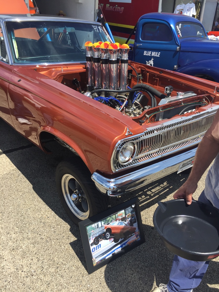

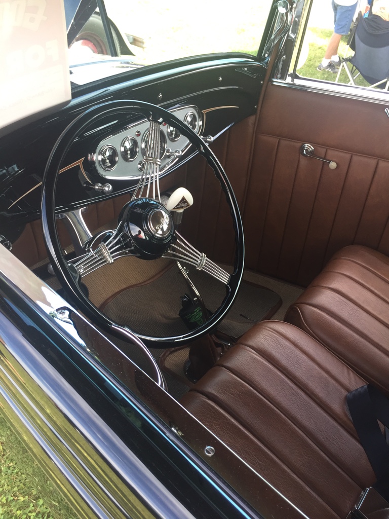

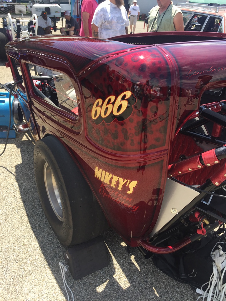

    A few more inspirational pics from the Meltdowns.
    Tim's 5w interior
    Possibly the best use of a Model A Tudor
    Clean 32 inside and outside
    Super awesome 3w inside and out
    And with out starting a SBC war, I can tolerate one if it's tastefully done in early garb.
    And a slightly non-thread compliant
    I love this gold beast and this second reminds me a lot of a build me and my best friend had begun for him. Divorce came along and the 500 had to go. I sent him some pics of this car that day and he didn't respond. Might have made him to upset.
    Finally a switch back to Hubba Hubba
    I really want this look but I think it's all too much and and probably settling closer to where it is now. But as curly said "day ain't over yet".

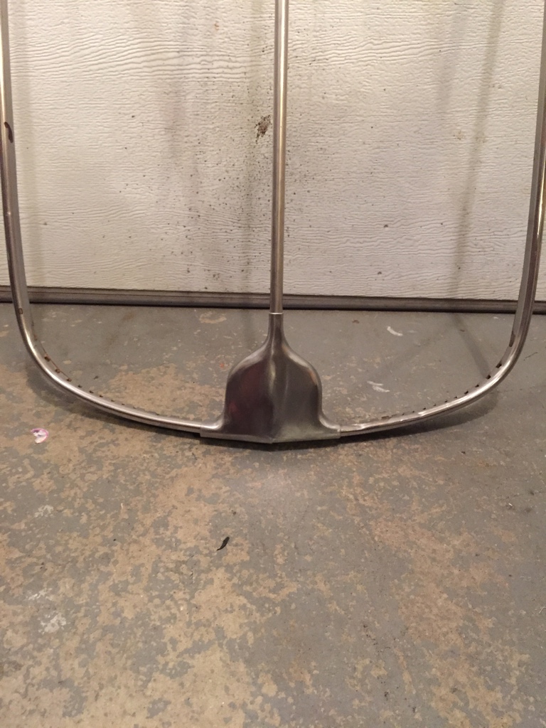

    With sanding and polishing I think I can use this one. I'm getting better but I don't want to do this 20 more times until its except able.
    I know it looks rough.
    All the edges get trimmed back almost by half. And the three trim points are long right now
    And a little make believe session.
    The stainless piece and Hupp emblem get folded down the center and three rivets will go through all parts and a dummy flat blade screw goes on the top portion.

    Since it will possibly days before I get another chance to sneak in some hot rod work, I have to show my small progress. My attitude is complete flipped on this grill bezel. Taking in to account the ten or thirty foot rule, it seems to be a passable piece coming my way.
    I've been working out the "blacksmith" marks with a Dremel.
    Then I trimmed it back to get a better visualization
    I did a little hammering to the main curve's new cut edges.
    I didn't make the buck very accurate or symmetrical. And it shows in the bezel more than I thought it would. I believed I could tweak the finished piece by hand. Not really true.
    I sanded more with Dremel and started to wet sand it with 400.
    It is taking shape enough now that I'll back up and try to hammer it out better. Then sand out the scratches more and back to finish sanding for polish. It still won't be perfect. Now I'm ok with it looking pretty good and when your up on the car it will show that it's hand made. I'm not ashamed of it any longer.
    I can't wait to redo the top piece to this level.
