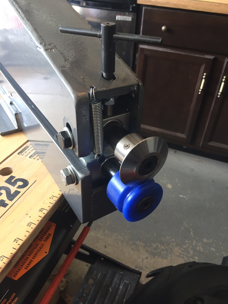

    Experimenting with my grill shutters. This is a fairly slow process on the bead roller(I'm using the hand crank for now). I take a few steps to get to this with flipping and running each direction plus changing roller dies back and forth.
    loudbang, brEad, tb33anda3rd and 2 others like this.

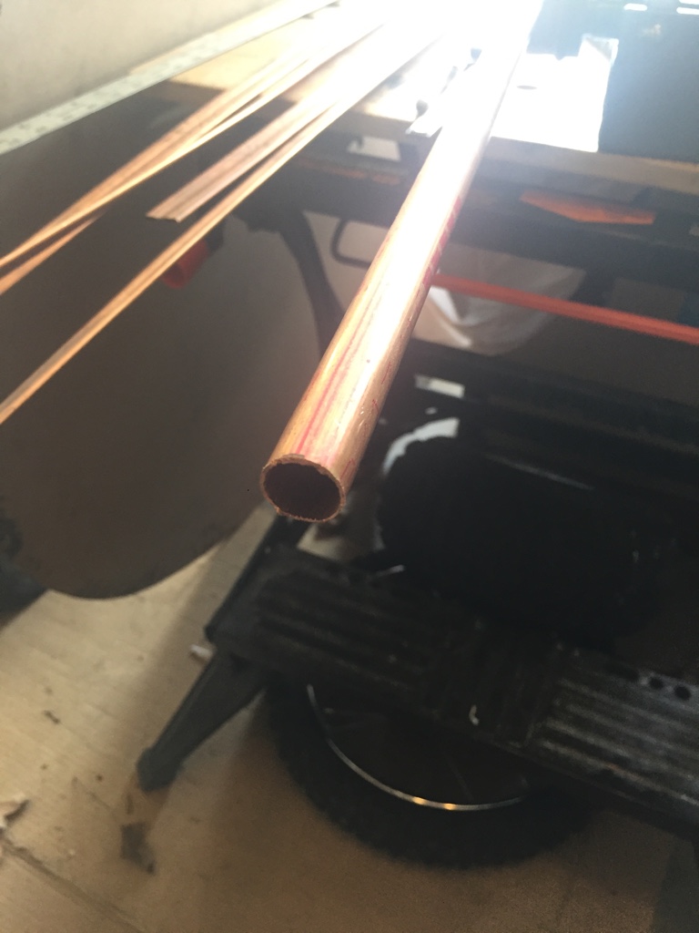

    First I start with some 1/2" copper tubing. It's the cheap red softer stuff, I didn't want to fork over some steep copper costs on an experiment.

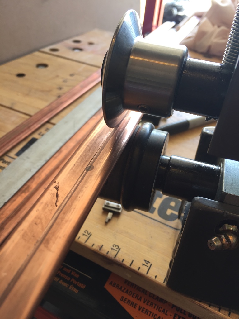

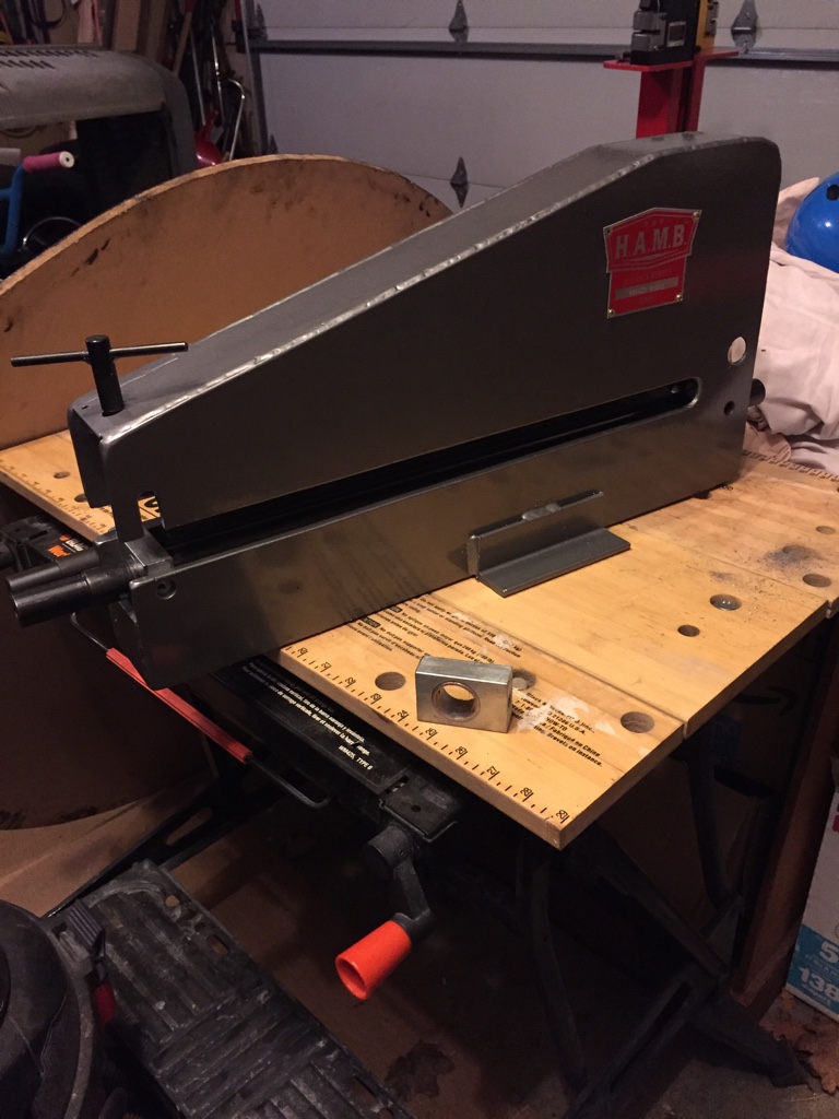

    Then I fire up my new HAMB alliance bead roller(I needed to do something with these tags I'm piling up).
    I lost a screw for the tag. Keep forgetting to install the zerk fittings(original 32s of course) Lol.
    Step one is rolling out some flat sides in the round tube. I slowly walk it down to a roughly .350" oval. I do this in different directions controlling the bowing, squareness of the two flats, and any twist as best I can. Starting with its red markings up. I'm using the flat surfaces next to the bead impressions on a set of dies. If I start close to the bead grooves I can minimize the markings from the set screw holes. I scribe a centerline down each flat before moving on.
    Step two is installing my shiny tipping die on top to roll a simulated seem down the middle of the flat surfaces.
    I do this as well in several small increments to be safe. Flipping sides and directions multiple times.
    I now take it to the point of the two sides touching in the I.D.
    After that I go back to the two bead roller dies and walk the four raised sections down to a flat surface leaving a nice round leading edge for the shutters at about .150" thick. When I've gone further they start to get a knife like edge. Plus I'm happy with this thickness.
    I make sure I run it through a couple times all four ways so it's evenly flattened out square. Sometimes I run it back with the tipping die to make sure the middle groove is crisp.
    Now I need to fit all 16 shutters to the grill shell in the respective positions. Then finalize a mounting solution to keep them angling in slightly towards the center bar eight shutters per side. I would like to continue this in a fashion that again doesn't shout out "hey I'm a poser"
    I'll clean and polish all 16 bars then soak'm in bleach for the cool corroded look.
