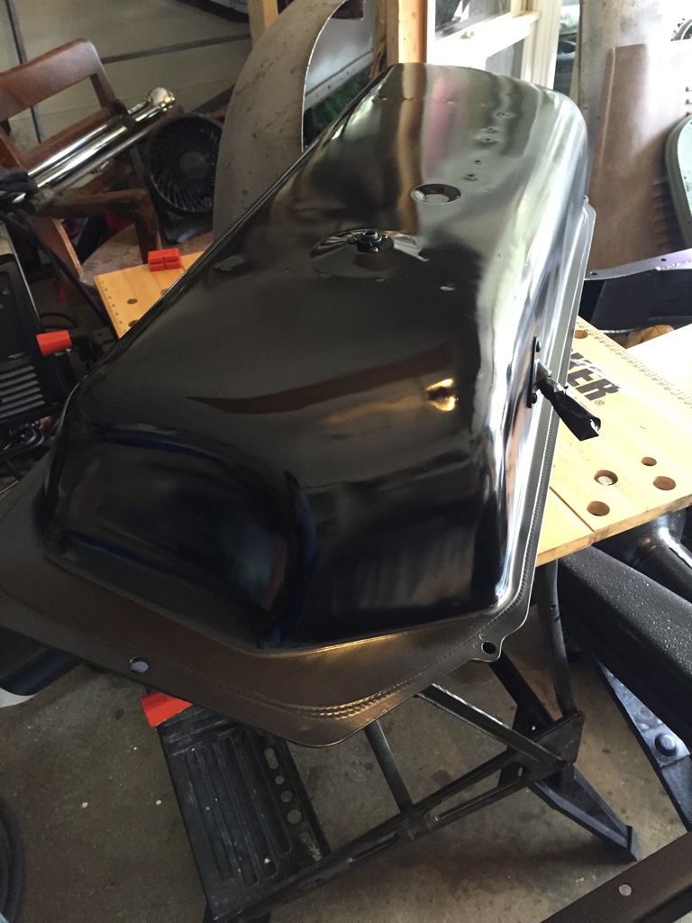

    Not-so-pretty spray bomb job.
    I didn't want to put much effort into this thing. I wasn't going to mess with it at all before having to change the mounts around. My intentions were to slap it in and use it to try to cut back on how long this build is taking. I had planned to run it for like a year or so and get around to freshening it up inside and change the 3:78 for 3:54s. It is "supposed to" not have much time since its last overhaul. It feels great but I'm still just trusting a HAMB'r on this one, oh well.
