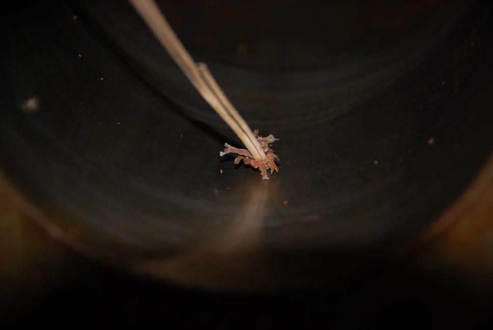

    I have a 259 poly that was machined a few years ago .030 and new pistons, you get the drill. well the cyl walls are super smooth and some people said i need to hone them to get the rings to seat. well i dont know what kind of rings they put in it so im not sure what to do. Do i use the ball hone? or the flat stone? or what? there is a tiny bit of rust on the top of a few cyl how should i knock that down. i hope the pictures give an idea

    I use the ball hone, soak it in fresh oil beforehand and use lots while honing. Spin on high and run in and out at a pretty good rate to get a crosshatch. Might be other thoughts on the subject but thats what I do and have had good luck.

    I like tool mans idea. I work on diesel engines a lot and we use ball hones. The flat hone would be a good idea to get the rust out. Then use the ball hone to make cross hatches.

    I heard the ball hone may be the way to go. maybe ill use the flat to get the rust out. For the ball hone do i just use the regular motor oil or maybe tranny fluid? How many passes should i make through a cyl? just a few? Im not sure how much cross hatch i want to put in it. thanks

    Dont go crazy on it, 5-10 passes up and down should be enough with newly machines cylinders, I use motor oil, seems to work fine for me.

    Use the ball hone and you should have no problems with the rings seating
    You will have a problem with the grit left behind by the ball hone. Get all, and I cannot emphasize all strongly enough, of the residue & grey film off of the cylinders and block. That residue is a big ring, ring land and bearing killer. We used the old and extremely effective soak hot tanks with caustic solution and when a block was pulled out that had not had the cylinders properly cleaned after honing there would be grey residue on the rag when the cylinders were wiped.
    After honing wipe the cylinders of the heavy stuff then spray the cylinders with CRC or WD-40 and wipe with a clean towel until the wipes show no residue. I to this day soak a lint free paper towel in lacquer thinner and wipe each cylinder before assembly...not so good for my hands but I am too thick in the head to wear thin gloves.

    Thanks guys so the ball hone should take care of little rust and rings and not even use the hone with stones.

    Thats correct, just the ball hone, no need to use the stone hone.
  11. On any cylinder that has been run, use the ball hone. It will follow the wear tapers and leave the cross thatches even in the taper.
