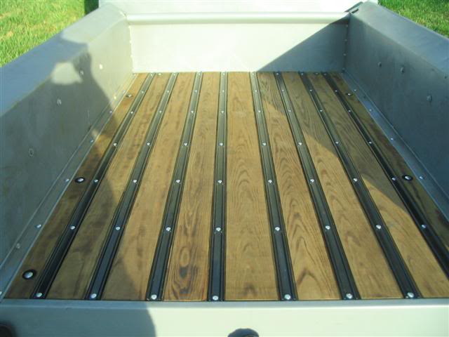

    Brand new pressure treated pine.
    Burned the soft grain with a propane torch.
    One coat of a very dark stain.
    Thompsons.
    Done.
