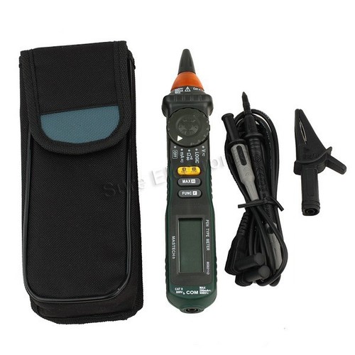

    Chances of the meter being readable by the time you get your head and both probes in position - doubtful.
    Wish they would make a meter with a digital readout right at the probe.

    Haven't seen one of those yet.
    I have a bunch of jumper wires of various lengths w/alligator clips that I connect to whatever I want to check and then to the probe. Sometimes it requires a covered alligator clip for insulation, so if you make some, you might choose covered clips. I also made up some with a spade connector to speed up the process of checking those wires.

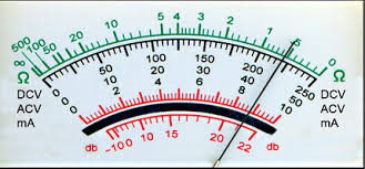

    So, the horse hoof is Ohms and is read on the light blue scale.
    Is Ohms the resistance of flow of current?
    DCvolts - Car stuff
    ACvolts - House shop wiring
    All read in the center black scales, based upon where you have the dial set - 10, 50, 250 -
    mA - milliamps
    db - lower red. What is that? The noise level when we hit our head under the dash or something?

  16. vintagedream
    Joined: May 27, 2011
    Posts: 50
    vintagedream
    So here's the deal: this meter has 3 dc voltage scales, 10v dc, 50vdc, 250vdc, those are the three black scales, and 3 corresponding positions for the rotary knob. Use the scale that matches the knob setting. To measure 12 volts, set the rotary knob to 50 vdc and read the scale that goes from ov to 50v. This meter is set on the 50v scale and is reading 1.5 volts. A 20 volt dc setting would be better for measuring 12 volts but this meter does not have one.

    willie2323
    just curious but why don't you measure your 1.5 volts on the 10 volt scale?

    vintagedream
    I couldn't find a picture on the interweb showing a meter measuring 12 volts. I guess this guy was hoping to measure 12v so he's on the 50v scale, but all he reads is 1.5. Maybe he found his problem.
