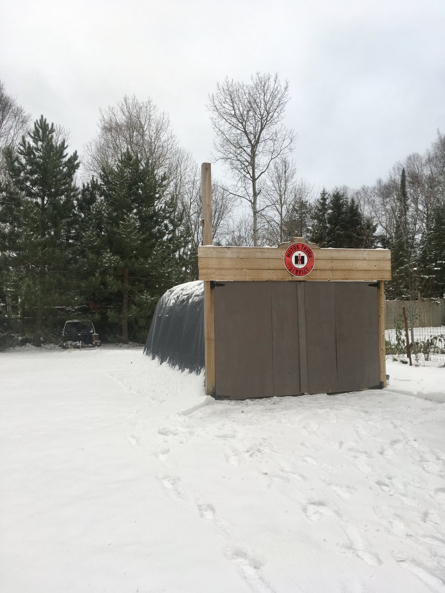

    That's really neat! I need to put up something like that!

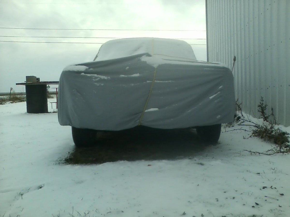

    this is how I did it. sat right here for 10 years.

    I leave west of Thunder Bay. I bought a brown peaked Shelter Logic portable that is 12 x 20 x 11 high from CTC. The frame is 2" square tube and the roof is snow rated to 45 lbs/sq. ft. I brought home a round tube shelter from CTC that was supposedly good but it had all the holes misaligned so its frame was badly twisted so that went back. I started looking around for a better one when CTC had the heavy duty on sale for $999 down from about $1200 at the time. I put down heavy poly then built a floor with 2x4 covered with T&G plywood. It is dry & comfortable. The car is inside a carbag with 2 large containers of silca gel from Lee Valley Tools. This was my temporary solution until I got or built a garage. I have a garage so I will move the car into that next fall and get to work on it. A bit of an overkill for temporary but the extra $300 was worth it for the quantum leap to a much better shelter.
    The square tube version is peaked steep enough that it is self cleaning with dry snow. The snow usually slides off and if there is a little wind then the fabric movement will clear the roof. In 2013 we had a crazy winter. The snow banks on the streets were up to the bottom of the stop signs. There were a several round tube portables in town & one metal quonset building that collapsed in 2013. There was a lot of snow on the shelter's roof at times. Sometimes I thought that I should wade out and give the building a shake but I let nature take care of it. I think if you live in the great lakes snow shadow you might have to give this building a shake if it is really high or too wet. These portables may have been built with your snowfalls in mind. 45 psf of snow is about 3 ft of wet snow. There was about a foot of snow on the roof this week. Today was warm and the snow was sliding off.
    I noticed a couple weeks ago there is one pin hole in the roof other than that it has been good. I read that it is a good idea to put a tarp over a portable garage to keep the UV off the roof. I will pick up a good military style canvas tarp to cover the roof when spring returns. I have an old car squirreled away in the shelter and my son parks his snow machine in there for the summer.
    The closest CTC shelter that I could find similar to the one that I have is this one.
