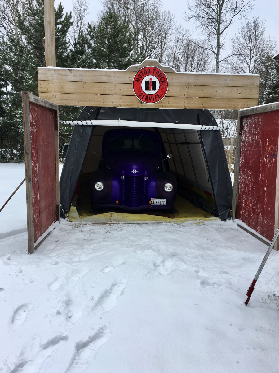

    Don't tarp it. I use portable wigwam. Vapour barrier is a must on the floor to keep moisture out over the winter
    I also made a false front to protect entrance from prevailing north wind IMG_1322.JPG

    bchctybob
    Now that looks like a great idea, who makes/sells those wigwams?

    Jazz1 showed exactly what I was thinking of in his post #13. One that has a vapor barrier below the car and a real sturdy portable carport that fits somewhat close to the car but doesn't let anything touch the car and is designed to shed snow, water and wind. You don't need room to work inside you just need enough room around the car to get out of the car when you back it in. From experience the bigger portable car ports either get blown away or don't shed snow and collapse.
    The round top ones aren't cheap but look a lot sturdier than the other ones. https://www.tractorsupply.com/tsc/p...oundtop-instant-garage-sandstone?cm_vc=IOPDP1

    IMG_2678.JPG IMG_1324.JPG The round type of wigwams do shed the snow however you have to shovel it away from sides as it builds up and puts pressure on walls. My first cover lasted 4 years. New cover was $200 so cheap storage IMO
    With poly on floor I occasionally sandblast in there during warmer weather
