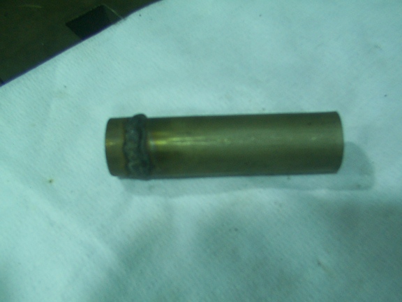

    This gizmo is made from common stuff, i used a 1/2drive X 5/8 socket, a short piece of pipe, a 1/4 bolts and some 3/8 X .058 tube.
    What this will do is create a dimple in sheet metal for a screw or bolt head, in this case a 1/4" fastenor.

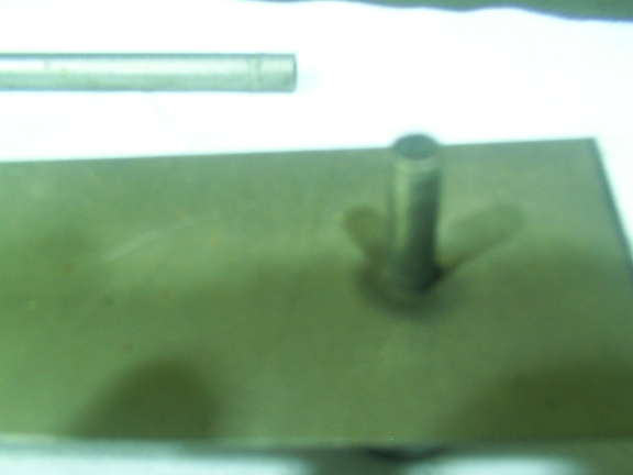

    To make the tool i used and old 1/2drive X 5/8 socket as the receiver for the forming dies. Pic 1 shows the socket, 1/4 bolt and washer, i put the washer on the bolt and drive it into the socket - pic 2 - this will automatically center the bolt for welding. Pic 3 & 4 show the welded bolt and the bolt trimmed to length - the bolt acts as a locating guide for the dies.
  2. oj
    Joined: Jul 27, 2008
    Posts: 6,575
    oj
    The next 2 pics show a piece of pipe - they measure pipe funny, this piece has about a 7/8"id and od is about 1 1/8". I cut a short section off it, welded a #10fender washer (reamed to tight 1/4") to one section and then joined the 2 sections back together so the fender washer is inside about 3/8 or so. This is one of the dies.

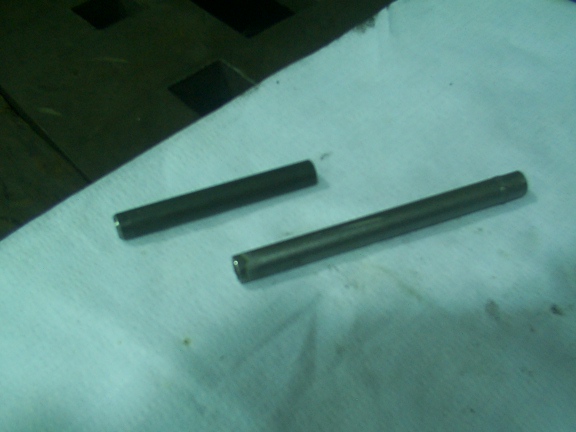

    The next pic shows 2 pcs of 3/8 X .058 chrome moly, they are exactly 1/4" inside diameter, one piece has a square cut on the end and the other has a bevel for forming a countersunk pocket. These are the other dies. The tool is done, now to use it.

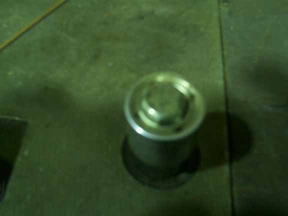

    I drilled a 1/4 hole in 18ga steel, the 1st pic shows the drilled sheetmetal over the receiver with the 1/4 guide protruding. The square cut 3/8 is being slid down over the guide in pic 2, when the tube is tight against the metal i smack with a hammer and rotate the tube as there may be imperfections in the tube etc and rotating will make a cleaner impression. Pic 3 shows the dimple that is formed inside the receiver/socket.
    Now you need to raise the dimple, shown next with the pipe.
