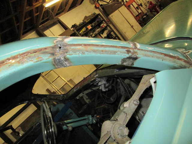

    The big problème with my rain gutters is they have the cancer and I can't use them after chop : (. Exists there in reproduction ? : Confused:
  6. On 2 different projects I have made new gutters. No big deal on a good 10' leaf brake. Installing them is a different story. Often times when the gutters are gone so is the roof skin behind them. Get creative with the roof repair and incorperate both jobs into one. This is generally where Top Quality Tig welding skills come into play. We each find our own way to do this job, Just remember that you will be using some kind of Drip rail sealer and there will be a headliner on the inside. No matter your choice of methods it shouldn't show on the finished product. The new part does not need to be welded solid, in fact I advise against that. Today's new 2 part panel adhesives are unreal. Also think Tabs and Slots.

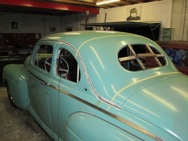

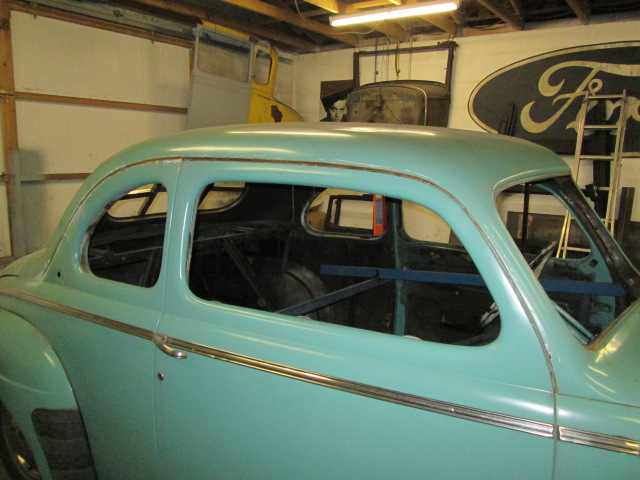

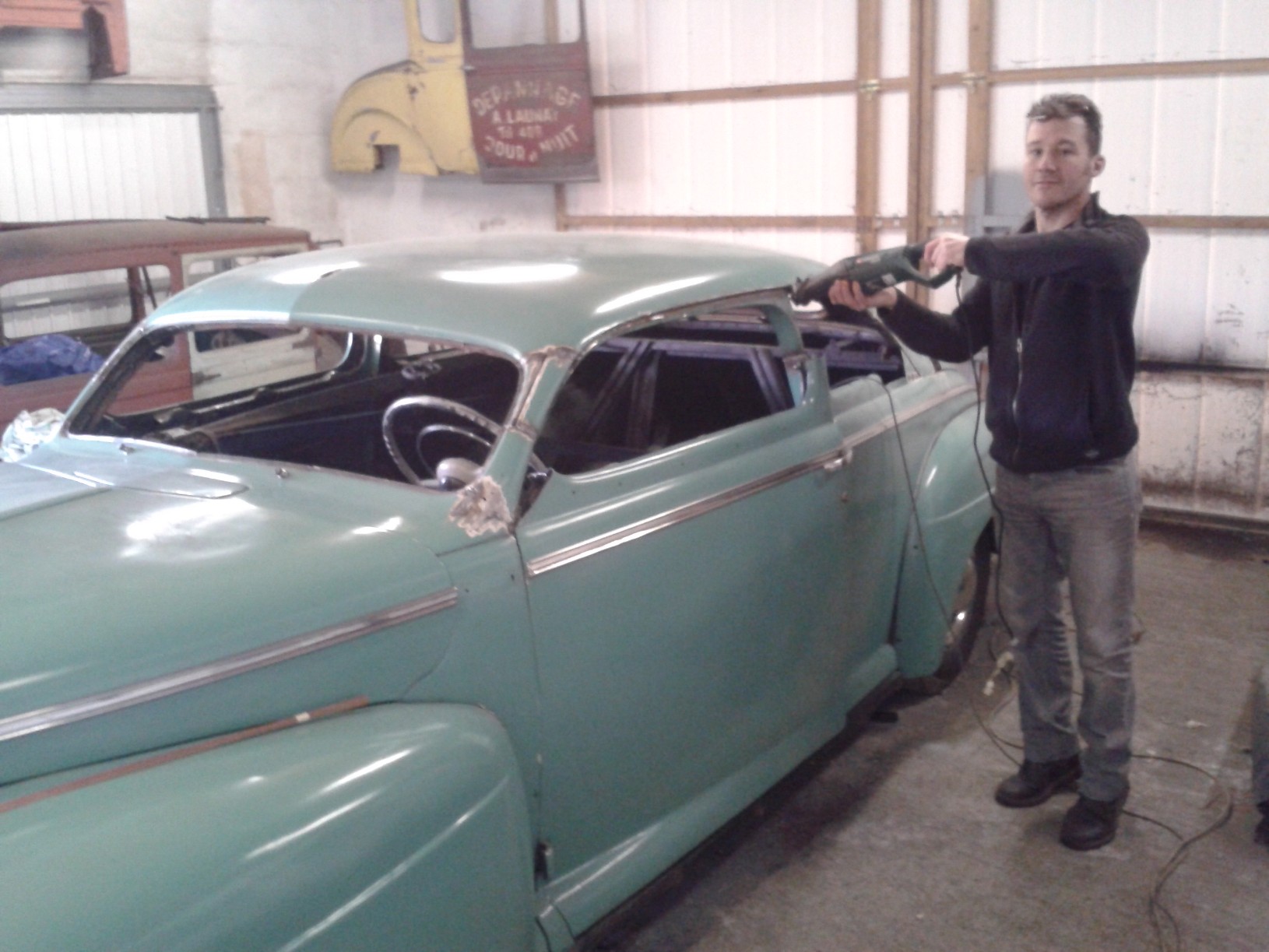

    After to consult full of people here I took my courage has 2 hands and with the help of my friend Vilo we let us have to decide to make the chop of my 46 for the New Year's Day, my English being very bad I am not going to extend over comments , the photos are speak about them same. I would nevertheless try to answer if I can understand your questions ;) IMG_0128.JPG
    We are cut the middle pillar at 5" :D

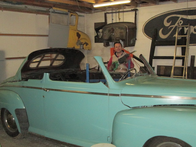

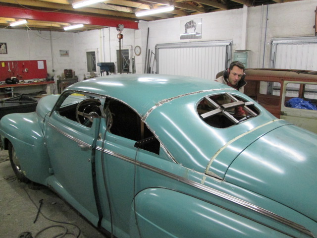

    We have to reposition the roof has its place then to tilt amount of windscreen IMG_0159.JPG
    My friend Vilo
    and me I would like to cut all :D
    and my new grille :)

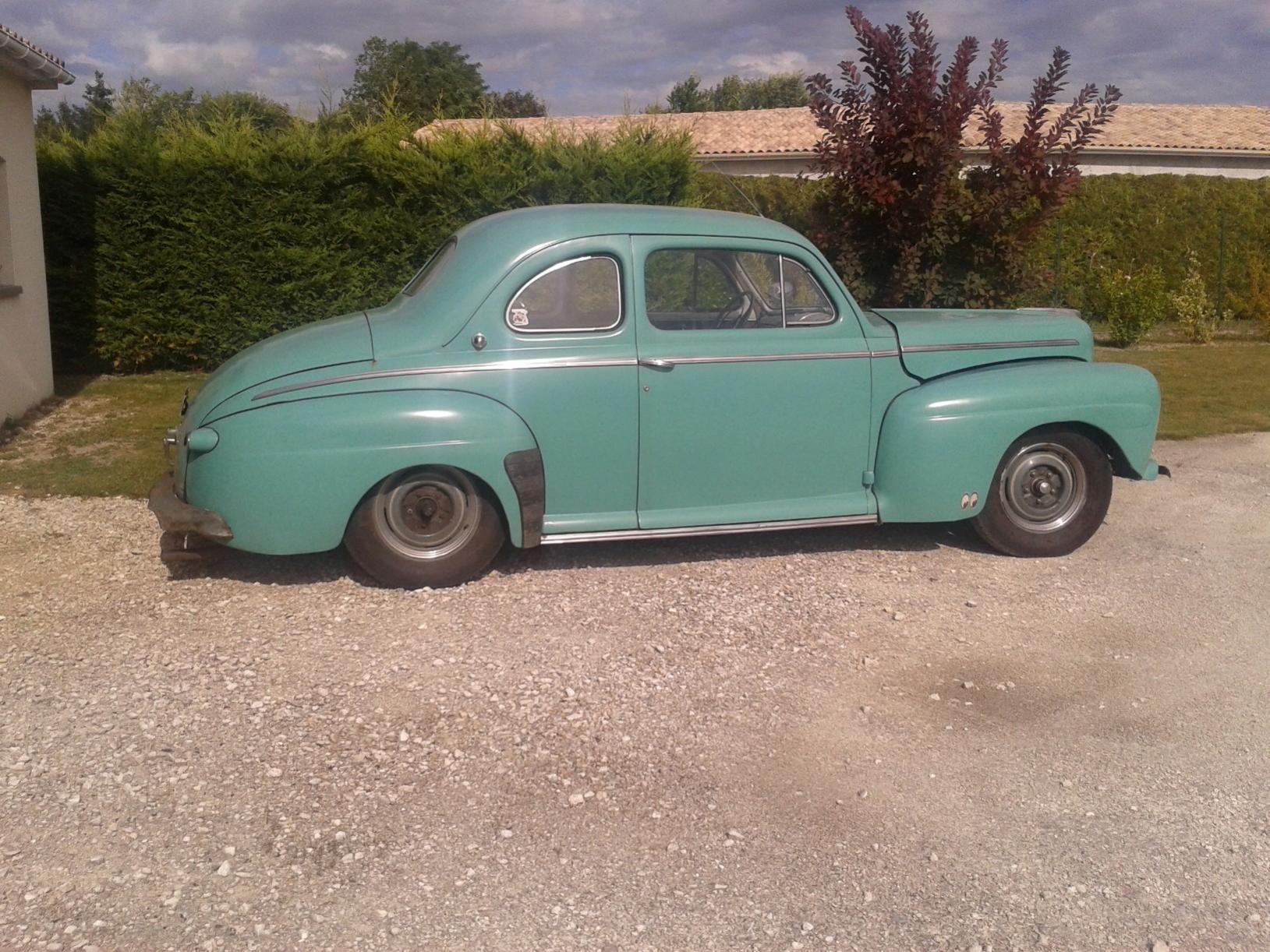

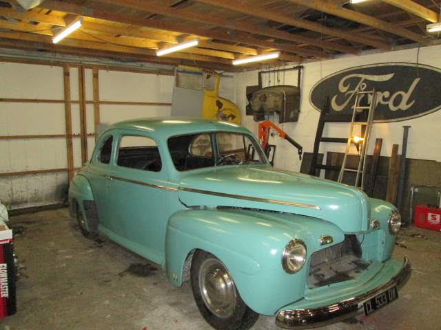

    Before :D WP_000575.jpg
    and after :eek:
    That all for the moment , but there's a lot of work on ;)

    Will you incline the B-pillar?

    I'm sorry but I do not understand what you want explain I and I would make for you quite the photos which you want ;)
    No I'm not incline it and no rain gutters :p

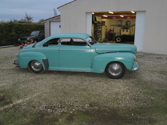

    whay do you think of this one ?
      102.6 KB
