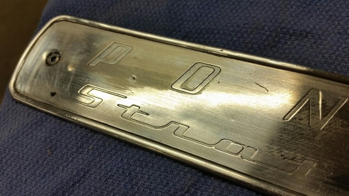

    I have the plates off of my 55 Pontiac rocker covers that are polished aluminum with Pontiac Strato Streak embossed on them. The letters are very very shallow. They were filled with black paint from the factory. Is there a way to redo it? I've tried filling with paint and both wiping off excess when wet and sanding off excess when dry with 2000 grit. Isn't working. 20200619_052043_1592572891526_resized.jpg 20200619_052102_1592572890366_resized.jpg

    The problem with wet sanding is the letters are so shallow even with a steel backer it takes out paint. No pinstripers around here. I've been looking to have some wheels pinstriped for 2 years now. The sign painters that I've contacted won't touch a job this small. I'm beginning to believe that I'll just have to leave it all polished.

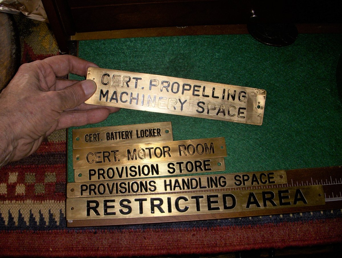

  16. Let us know if you ever get it figured out. I have some vintage steamship plaques I plan to use in my '50 panel truck that I'm attempting to refurbish the lettering. Some of them are etched fairly deep and are a walk in the park. But a couple have the merest hint of depth and are kicking my butt. For my next try, I might use a single edge razor blade for a squeegee, one letter at a time.......

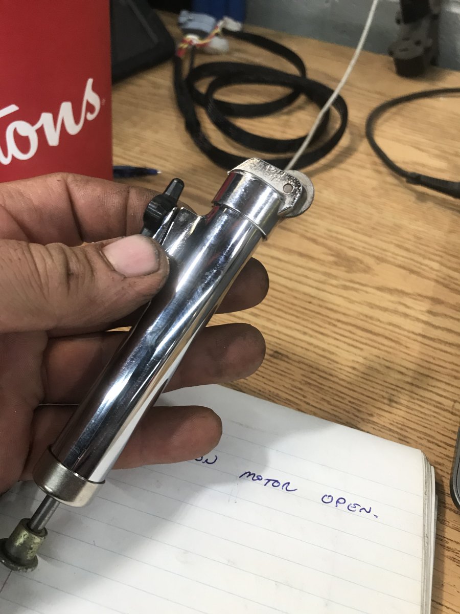

  17. C7257D6E-28EF-4B91-9B30-4C7FF043BEA5.jpeg E378A744-8A2D-40C8-9AEE-ECDCA8A50732.jpeg
    it’s called a beugler
    Works well
    don’t think it will work for this.
    paint pen, masking tape,patients is what you need.

    These letters have curved edges and are very shallow but wide. So it's easy to hit the middle of some of the letters.
