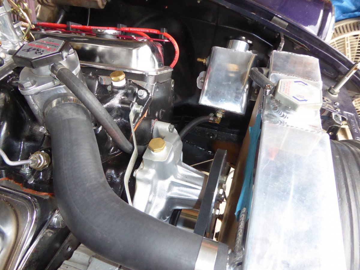

    I was having the same problems as you are, I finally tried a triple pass radiator and it worked, it is a fine line between the water staying in the radiator too long for cooling and the water staying in the engine too long bringing the heat up. I also moved my transmission cooler from in front of the radiator, to along the rail it seemed to be causing added heat.

    The new rad is a triple core ..not sure if that's the same a s triple pass.. so hopefully hat helps. I'm definitely going to look at remote cooler for the trans .
  6. First mistake is your thinking on the fill point, if your rad is above the engine the rad can be your high point.
    I can't help you with fan room, without knowing more about the car and if you can move the radiator or not, but you are better off if you can run the fan behind the radiator.
    For a t stat I use a fast acting stat, I have used Moroso and Mr Gasket they are both good stats. The little holes around the edge of the stat are for cruising at speed, if you are not doing that then they are not necessary.
    if your engine jammed in a tight space it is important to let the heat out, that is what louvers are for. I don't know if you have done that but they really are a functional doodad.
    Hope that helps you.

    All good stuff ..first to clarify ..the rad is lower than the engine so its not good as a fill point. As to louvers, the hood has 2 - 4" holes in it to let out heat and the wheel wells have large openings for the headers so there is lots of area for heat/air to pass out. Synthetic oil was a good idea. I have a MR . Gasket 180 hiv vol stat in now. I can't see how to drill any bypass holes in it however for an air bleed. I'm going to put in a remote trans cooler as recommended.

    3 core is not the same as triple pass. With a triple pass radiator the radiator has 3 separate sections to pass through. The middle section is connected to one outside section on the top and the other section at the bottom. Also a 2 core with 1" tubes cools great, that's all I have in my cpe with a 454 in it, but I do run a mechanical fan also. As someone else said close all the holes and airways around the radiator so that the air is forced through the radiator. Change that fan for a smaller one so that you can run some kind of shroud from that top purple bar back to the radiator tank blocking air from flowing over the top of the radiator

    Eastman sells a nice 3 pass ... but only certain sizes ... I was only able to find one size that would fit my car without having to se3eriously cut into the front frame area ..same size as a 1966 Mustang.. Will see how the 3 core works but wondering if a 2 core with 1 inchers might have been a better choice for airflow.

    I hope it does not over heat but it used to so I'm making as many system changes that could help cooling BEFORE its fired up. I just rebuilt the heads and replaced the carb and I have a few other things I need to complete first. I need to flush the fuel system, adjust the trans kick down, possibly replace the pan gasket, and make a few electric updates etc. etc . Right now the car is not plated or insured so even if I fired it up I can't really road test it yet. I want to get it as close to right as I can before I turn the key and I'm in no hurry.
