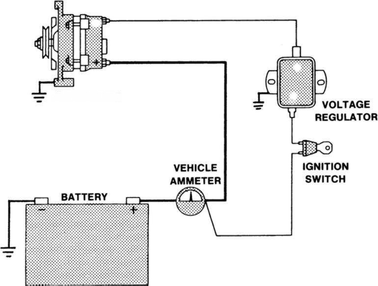

  1. Hello fellow HAMBers need some help on hooking up an Amp gauge. I am running 6volt with a generator. It is a 31 ford Av8. Can any one give me any tech support?
  2. Charging wire from the generator to one side of the gauge, and then the other side goes to the battery side of the electrical system.
  3. This help?

  5. So would the charging wire would be the ground post on the generator? Generator has 3 post. Arm, Field, and Ground.
  6. I would think it would be the (-) since the (+) is your ground.
  7. jazz1

    Amp gauge needs to go between all loads and the battery except the starter. They are meant to how much charge is coming or going to the battery. Not how much the generator is putting out.
  9. So could I hook up the Ammeter positive (+) to the fuse box since that's where all the power is going to and the wire feeding power is on the Battery post on volt regulator. And negative (-) to the starter solenoid where battery cable is connected?

    If I'm reading your description correctly Archie, the answer is no. All power from the generator or alternator must pass through the ammeter for it to work correctly.
