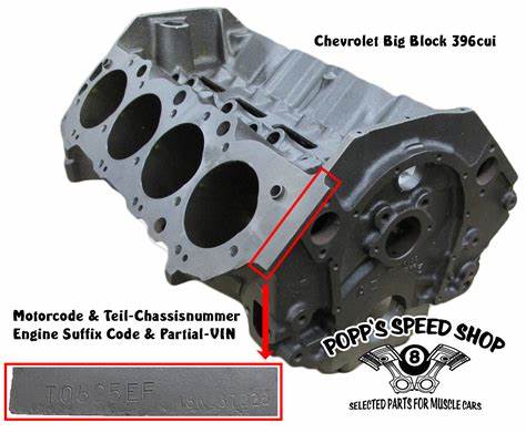

    I didn't have a suffix number photo so I snagged this one even though it is big block off the net. Full Creds to Popp's speed shop
    Location is the same on small block, on the machined pad in front of the right head. There are lots of suffix code decoders on the net or post it here and someone will do it with about fifteen seconds of effort.

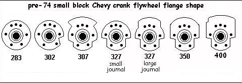

    I believe that 350s also didn't have the provision of road draft tubes at the back of the block

    Ding, ding, ding; we have a winna' here; this is what I was trying to say way back in the second posting about looking at the crank flange balance pad. Although it says, "pre-74 SBC, it's probably because that article was wrote in 1975 or so. Keep in mind, those are ALL 2 piece main seal blocks/cranks, and not late model one piece main seal blocks/cranks (that open up a whole nuther' set of issues). Thanks for posting that stumpy! I am Butch/56sedandelivery.
