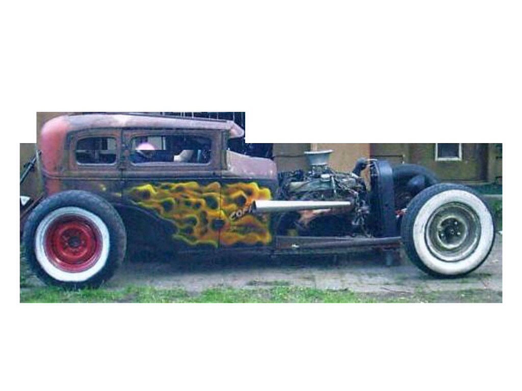

  15. here is a side view of the car as it sits right now

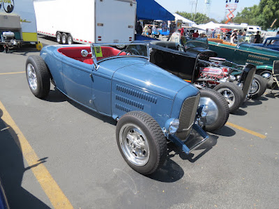

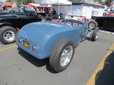

    I like it, especially if you want to mess around with tire sizes and subtle changes in the wheelbase. I couldn't find many samples photos (there aren't that many attempts, eh?) but here are a few. In one of these pix it is hard to tell if any mods were made. And with lowered cars with big tires you can't even see them. The Busby car is the cat's PJ. Gary
  17. Thanks for the pics Gary - awesome!
    There aren't many examples because its a lot of work.
    When cars are lowered so the wheel goes beyond the arch of the wheel well it looks like a major fuck up to me. They throw an awesome silhouette ( as in only a darkened outline) but are all kinds of fucked up with a detail profile or rear view. It's a whole lot easier to NOT move the arches or eliminate them but that's the difference- extra work or major fuckup.
