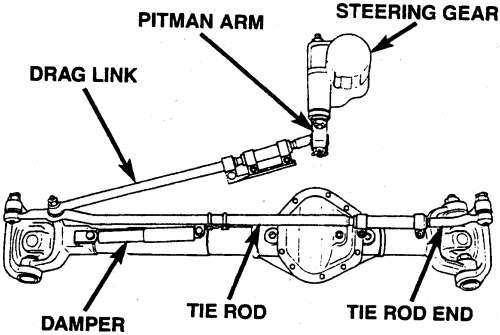

    Get one of these for the passenger side of your tie rod and look for a suitable Australian steering box. Scan-200618-0002.jpg

  6. the 4x4 guys do this a lot
    it articulates better. you probably dont need that for your application though

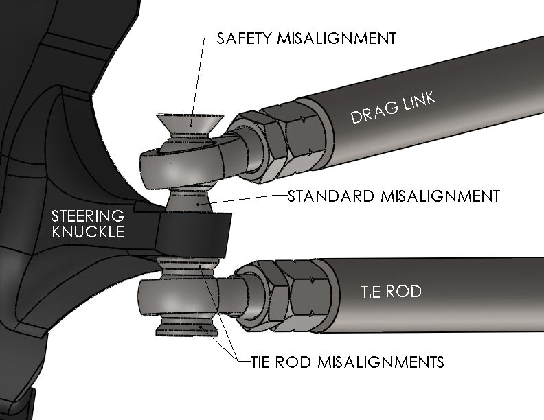

    look at 4x4 style drag links, there are lots of aftermarket style one that use rod ends or heim joints. The steering link can be added to a drag link or at the steering arm.

    Nice solution, but be advised of Aussie regulations at their inspection station:
    Very narrow on acceptance of 'aftermarket designs', spherical rod ends would be right in there...
  8. the Australians dont like rod ends?
