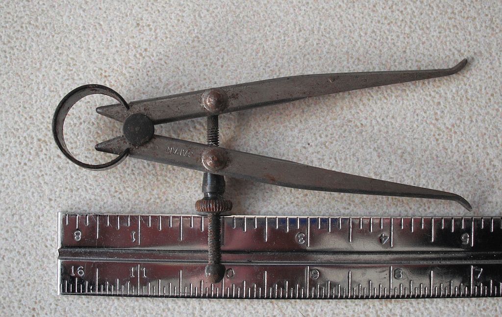

    Singh grooves, man, I aint following anyone down THAT rabbit hole....;):D
    Heres the dividers I was talking about, I was just thinking, its been probably 35 years since I bought these, they may be more than $10 now, but they are still WELL worth the money.

    The dividers are a good tool, as are home made sheetmetal templates for curves.
