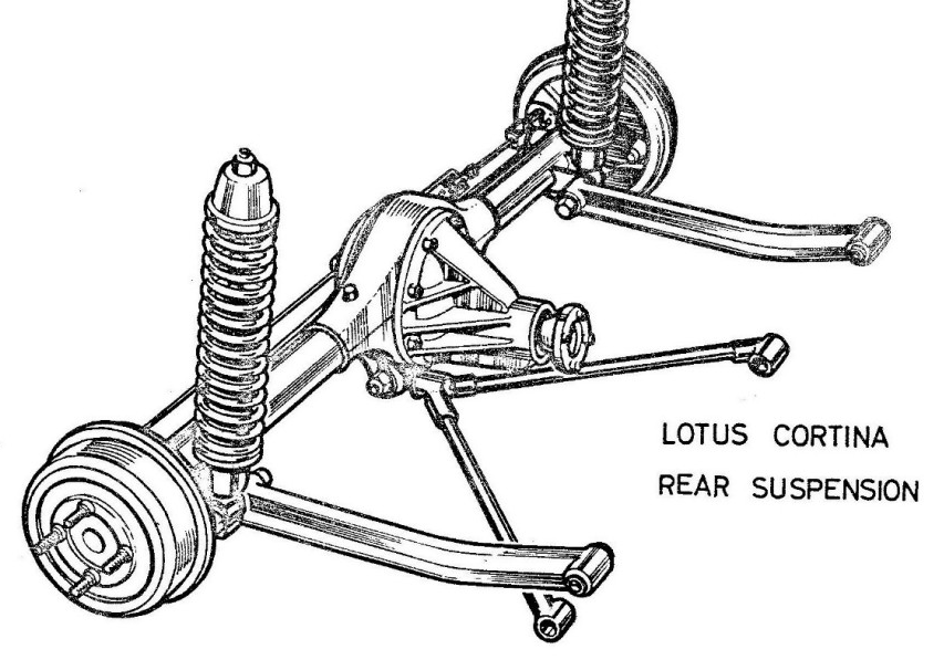

  21. Mimilan
    Joined: Jun 13, 2019
    Posts: 1,232
    Mimilan
    NO it doesn't.
    If the height difference at the frame pivots is the same as the height of the pivots on the bell-crank the arc of the 2 link arms counteract each other.
    The centre pivot moves vertically on a Watts
    You can also mount a watts link bell crank horizontally [with 1 link in front of the axle and the other link behind]
    and it achieves the very same result.
    I've seen this on Clubman racers where they need a really Roll Centre with a watts.
    Early Clubman Racers preferred the Low Rear R/C to soften the rear roll stiffness [pre-Limited slip diffs]
    You can also achieve the same low R/C results with a "Woblink" variation of the Watts Link
    All this does is "Re-invent the wheel", and ending up with the same end result as Colin Chapman's triangle 3-link.
    Which give a low R/C height and also controls forward thrust, axle torque reaction, brake torque, and lateral acceleration with only 3 moving pieces
    AND
    The R/C height never changes with suspension movement.

  24. Ned Ludd
    Joined: May 15, 2009
    Posts: 5,405
    Ned Ludd
    The angle of the line of movement seems to be perpendicular to the angle of the arms at that moment when they are parallel to one another. Of course that would have to be verified: there are a thousand ways to cheat an animation. But it could account for the lateral movement @gimpyshotrods mentions: the bars might be out of parallel at rest, or there might have been compromises in locating the outer pivots. It this works it's a solid basis for a heuristic to set up a Watt's linkage.
    gimpyshotrods likes this.

  27. Ned Ludd
    Posts: 5,405
    Ned Ludd
    The rotation at the ends of the links happens about three axes: assuming about 3" of travel in each direction, you might see 7-12° of rotation in each direction about the bushing's axis in both bump and roll, about 3-4° of rotation in each direction about the link's own axis mainly in roll, and some fraction of a degree of rotation in each direction about the axis perpendicular to the other two. So, to prevent your linkage from binding, i.e. ceasing to be a linkage at all and instead becoming a structure, the links need either to be spherically jointed, or to have compliant bushings capable of accommodating at least 4° of rotation about an axis perpendicular to their own, at both ends.
    Due to their angle, the compliance at the angled links' bushings is amplified geometrically under side loads. This is by no means a bad thing. The linkage's job is to prevent longitudinal and lateral movement while allowing vertical movement and roll movement, and to locate the roll centre. For various reasons it is conventional to use a triangulated 4-link to establish a fairly high rear roll centre — so much so that many believe that this is the only possible correct application of a triangulated 4-link. The principle can in reality be applied to put your roll centre wherever you want it. It's a lot of design work, though, so it's more suited to a street situation where you try to establish an overall optimal balance and then lock it in for the rest of the car's life, rather than a road-race scenario where you'd want to be able to tune the car for each track etc., preferably by changing as little as possible. Still, the triangulated 4-link has the facility that it is possible to project the roll centre well outside the bounds of the physical hardware of the car.
    Solid axles tolerate high roll centres because they are relatively immune from the lateral jacking effects which affect every form of independent suspension I've heard of — at least as long as the RC height is fairly constant and there is a positive roll moment arm. Notwithstanding all the good reasons to keep roll centres low, exploiting a solid axle's tolerance to a high RC might be a perfectly valid choice. For instance, a high roll axis might be a way to enable very soft spring rates to be used while keeping roll within reasonable bounds. The downside to this approach would be that vertical wheel movements over bumps result in small lateral movements of the car's sprung mass, proportional in amplitude to the RC's height above the road, which might be detrimental to ride quality.
    That brings us back to those compliant bushes. And that is how that geometrically amplified lateral compliance could work in our favour. It could eat up that lateral jitter over bumps without affecting much else. Because we're dealing with a linkage, where all the stresses in the links are either compression or tension, we know that deformations due to compliance will only happen along the links' axes. We are therefore able to plot where the roll centre is going to move as a result of bushing compliance, and unless you've got some seriously weird geometry, it isn't going to move very far. So, a lot of compliance in the angled links isn't materially going to compromise the lateral location of the axle. We'd have to look at what it does to axle rotation under power and braking, but that's another exercise. What I see coming out of this is that it might be worthwhile looking at very stiff bushings or even Heims or other spherical joints on a triangulated 4-link, but with a very soft compliant bushing at one end of each angled link only.
