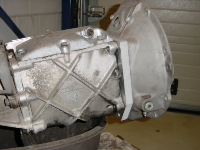

  10. Mean Lean
    Joined: Aug 16, 2006
    Posts: 170
    Mean Lean
    Thanks all you guys for the input, last week I put a broadband lambda sonde in the exhaust for measuring the fuel/air ratio and it sits nicely around 14.3 all the way, accelerating and cruising.
    Here is a pic from the Flathead/Volvo combination.
