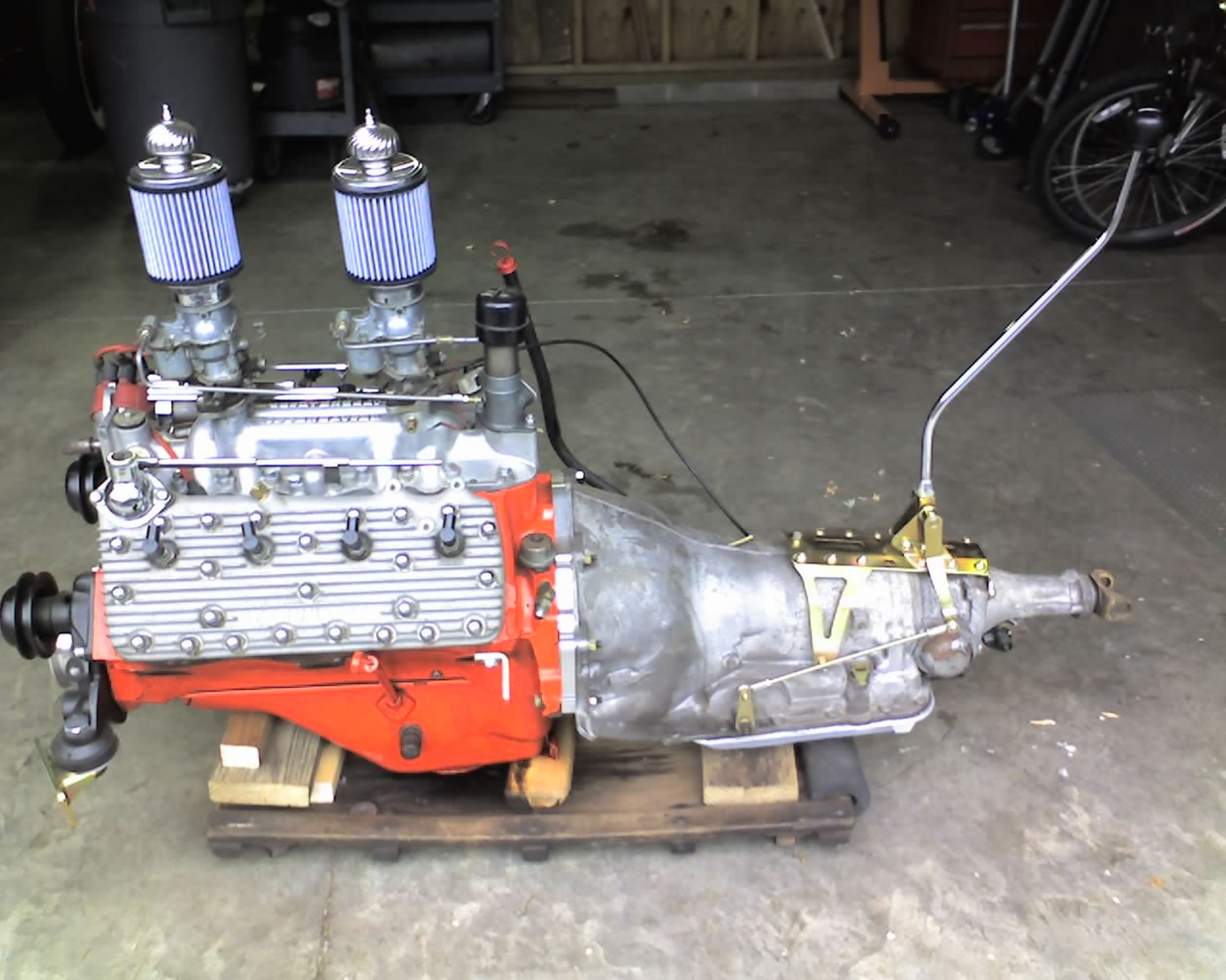

    Here's what I'm up to....hehe Just getting ready to set this 4-71 on my rad flattie...we'll see what happens. Mitchell intake, 2 holley 2100's, a 4" merc crank, Isky cam and offy heads. Yep, thats a 700r4 AOD.

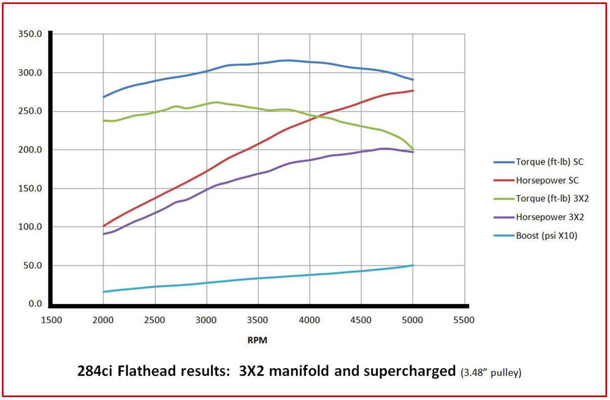

    Mass of the flywheel will affect the moment of inertia of the rotating assembly which will impact the accleration/deceleration of the crankshaft, not change the torque. A large factor in a flathead's torque is due to its undersquare design.

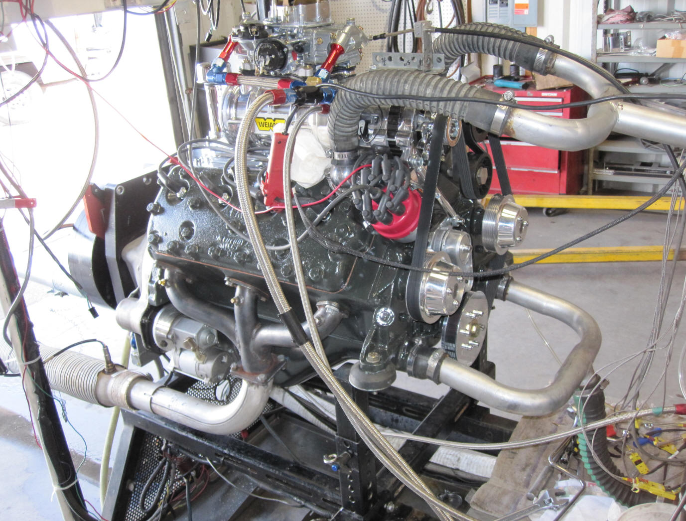

    Regarding HP that can be realistically achieved; attached are the corrected dyno HP/torque curves of a recently completed stroked 284 ci 8BA flathead built for reliable street use by Abbin and McGlasson. The engine was run both normally aspirated (3X2s) and supercharged (Weiand 142) to compare output:
