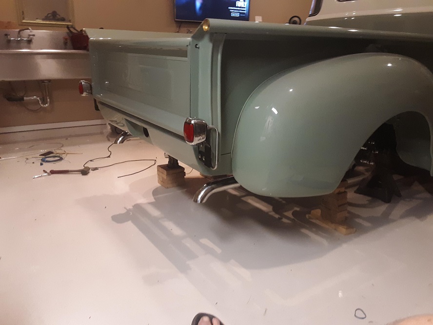

    I made my hangers out of old flathead connecting rods that I cut down and rubber mounted them to the frame using weld in bungs. I used one before the smithy, one after and one on the rear frame rail for the tail pipes per side. No X pipe as they complicate servicing. I don't have a great picture at work but here is an exploded view for no reason at all.

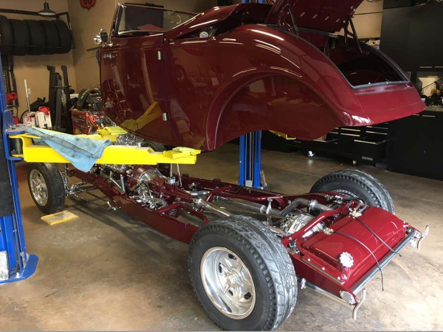

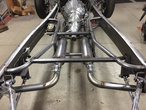

    Mine dumps in front of the back tires. One hanger at the end of the tailhousing and another on the inside edge of the frame rail where the pipe passes under. Very stiff.

  17. How big is the gap between the frame rails & the pipes?
    Are you concerned with damaging the frame paint by heat from the exhaust? :confused:
    I'm asking for a friend.;)
    BTW, your coupe is beautiful.

    Pipe is at it's coldest point right where it goes under the frame at the ooutlet, that's also the closest point. It's about 3/4" below the frame rail. Where it crosses over and under the crossmembers it's closer to 1-1.5". We'll see about burning paint, it's only run a few minutes so far.
    Thanks for the compliment.

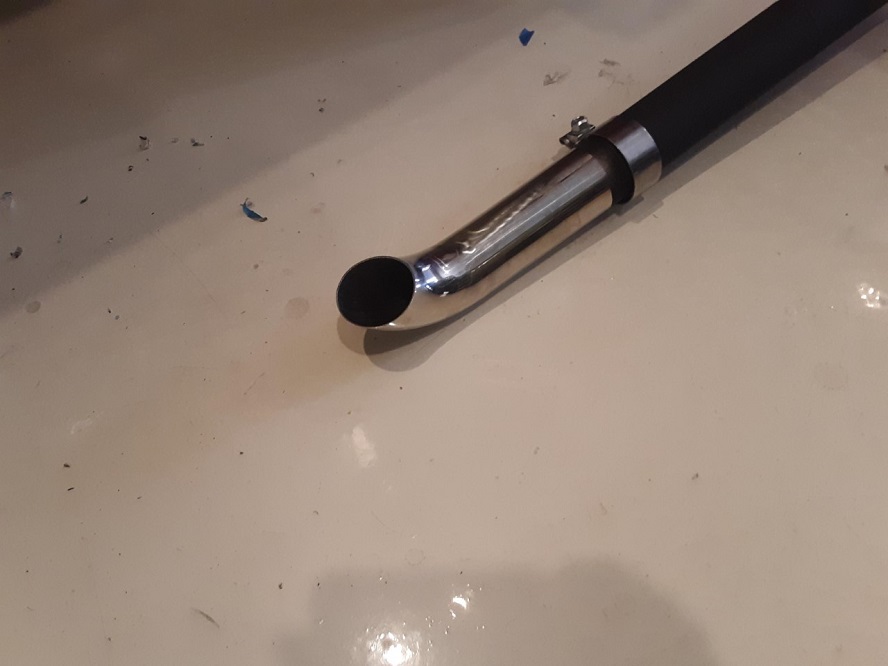

    The rubber hangers in the steel box tube are called 'southern' style hangers - why I don't know, but you can buy them pretty reasonable on flea bay. The metal rod has about a 10" tail and I heat it with a torch and bend it around the exhaust pipe and put a couple of inches of weld on it.
    Tips are just a stainless mandrel bend slit on the bandsaw and welded to the mild steel mandrel bends with nickle rod.
    Dump is out the back.
