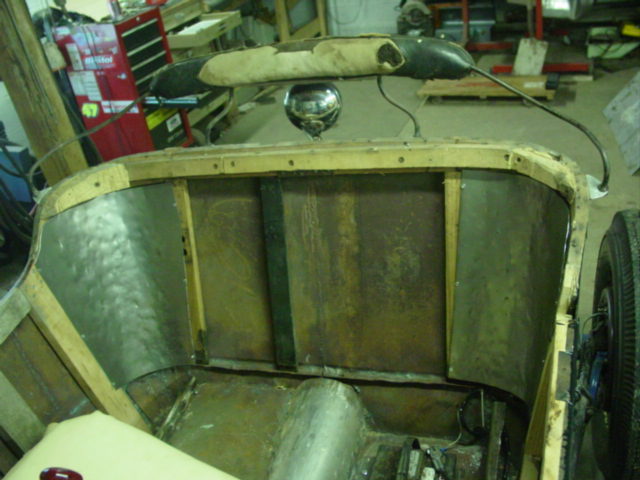

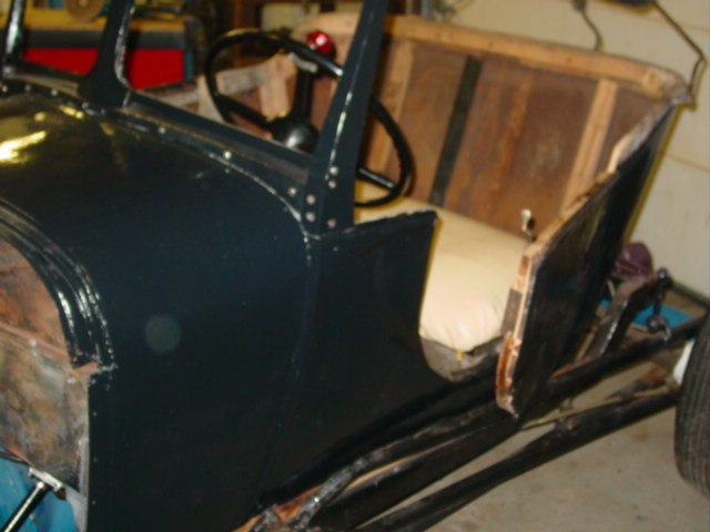

Part of original bodywork, I copied some pieces and in the end made the connection between cowl & backend, wooded the door shell... Makes a good body especially with the deck screws and glue available now. I have no illusions about finding any other original body parts and plan on the next roadster body to be from scratch. I don't have enough sheetmetal tools yet but certiamnly can build the wood frame. Locust or ash is the most common locally, lighter than oak. Can carve with chainsaw, bandsaw, disc grinder and costs nothing.

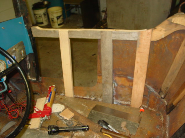

I did new oak for the rear cab support on my '33. I used the old stuff as a template & it worked out just peachy. I also used plywood for my half of my floors. I've always been better with wood than metal, so it was a pleasure to do that part. Here's a shot where I used buffalo nickels to cover the bolts heads.
