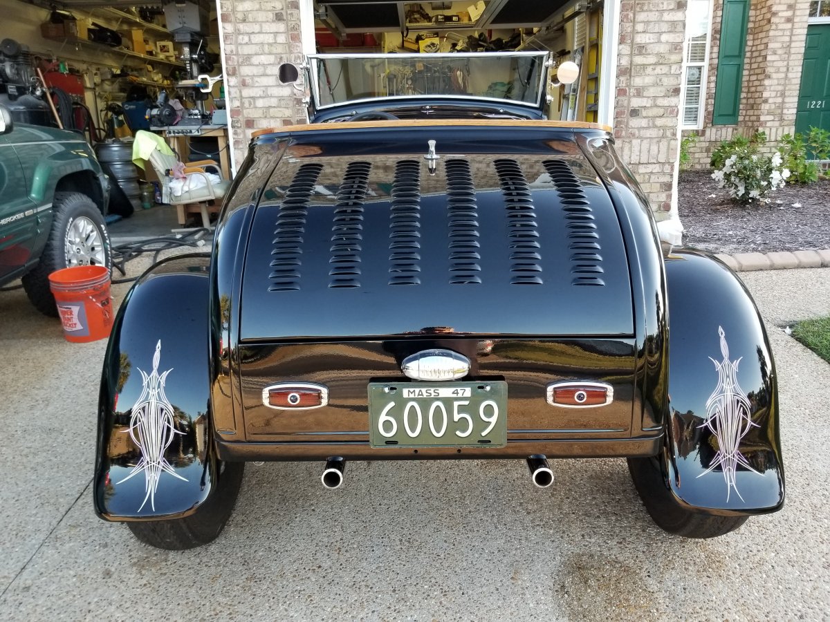

    On my roadster I rolled them out along side the fuel tank, straight 2.250" pipes, ceramic coated all the way to the flathead, aluminum motorcycle pipe caps pounded in the ends to finish them.

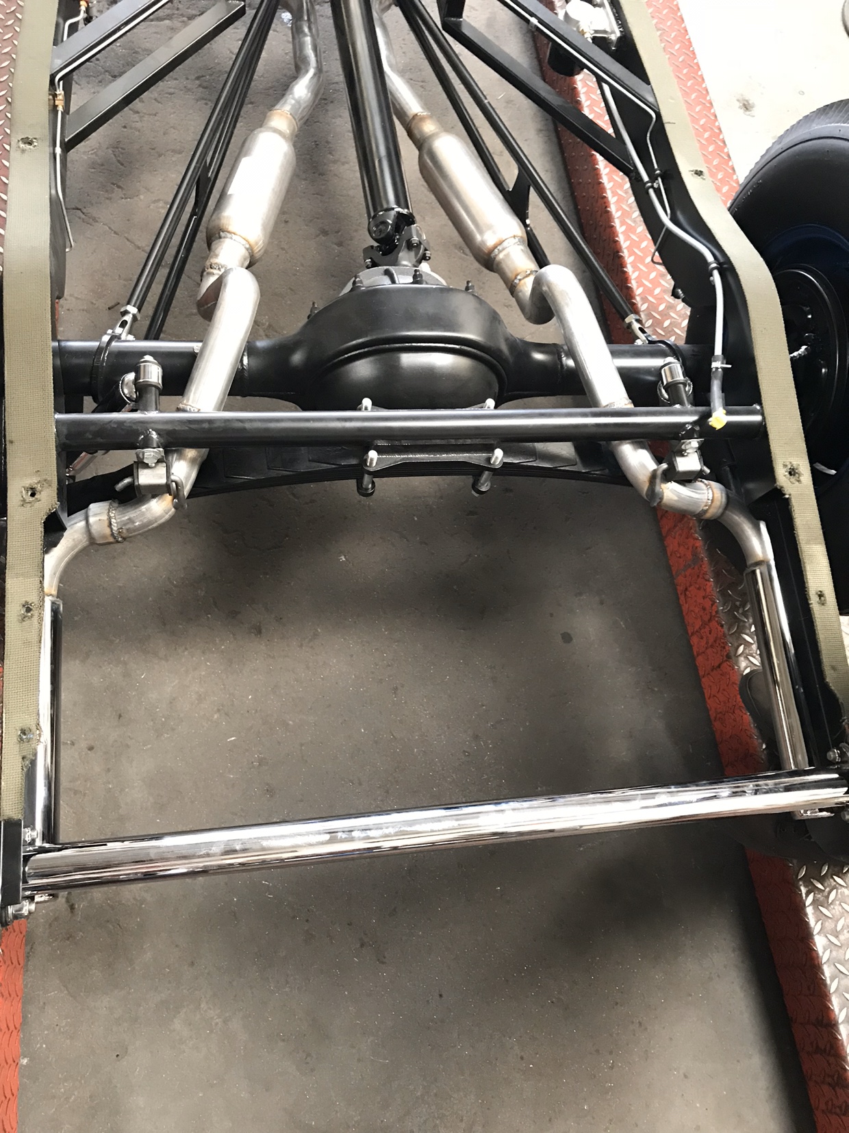

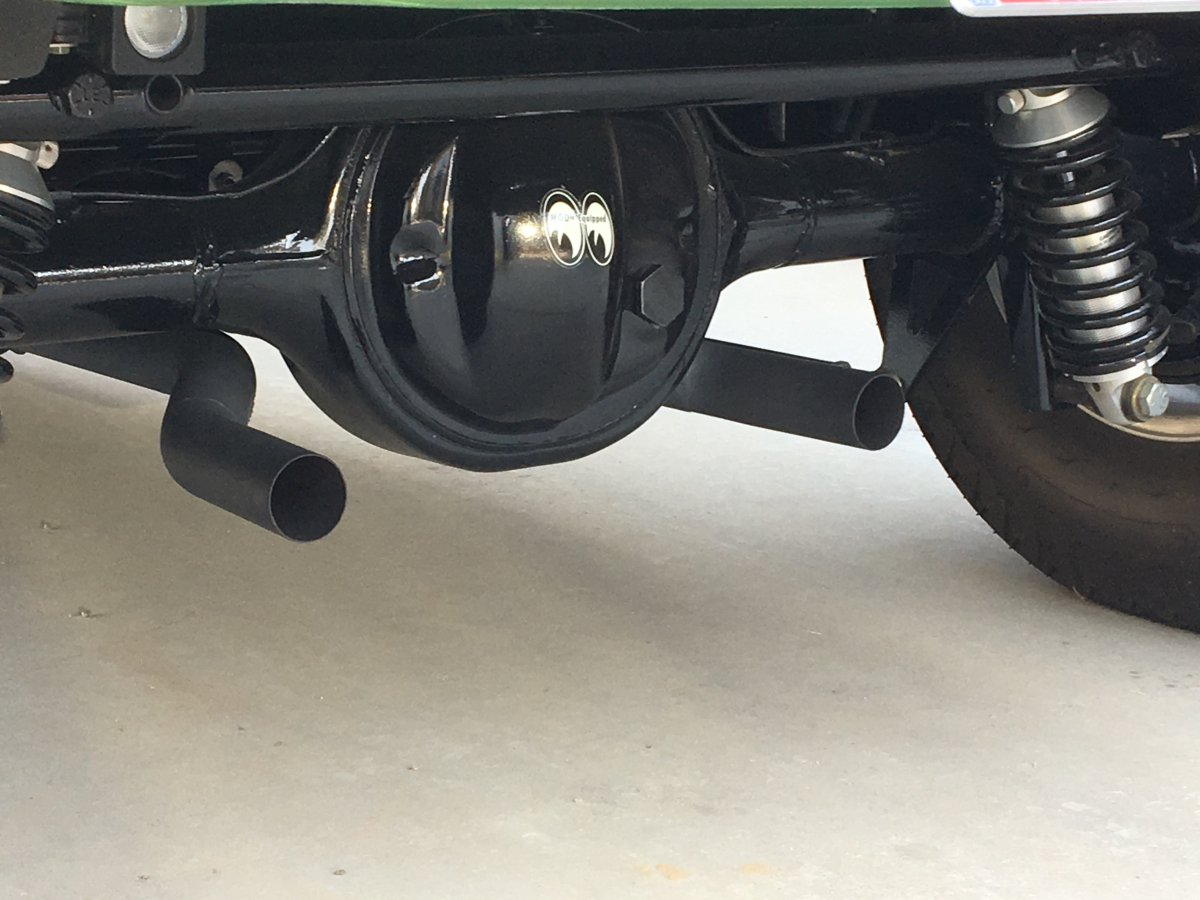

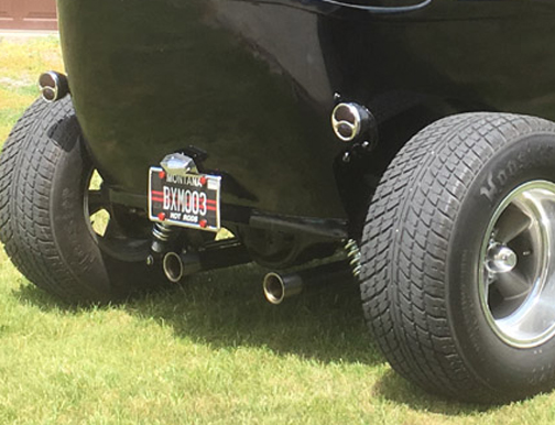

    Ignore the meats. Tips are collector reducers tacked to fabricated 2-1/2" pipes clamped to SpinTech cans and doglegged under the axle. Bare metal with clear engine paint.

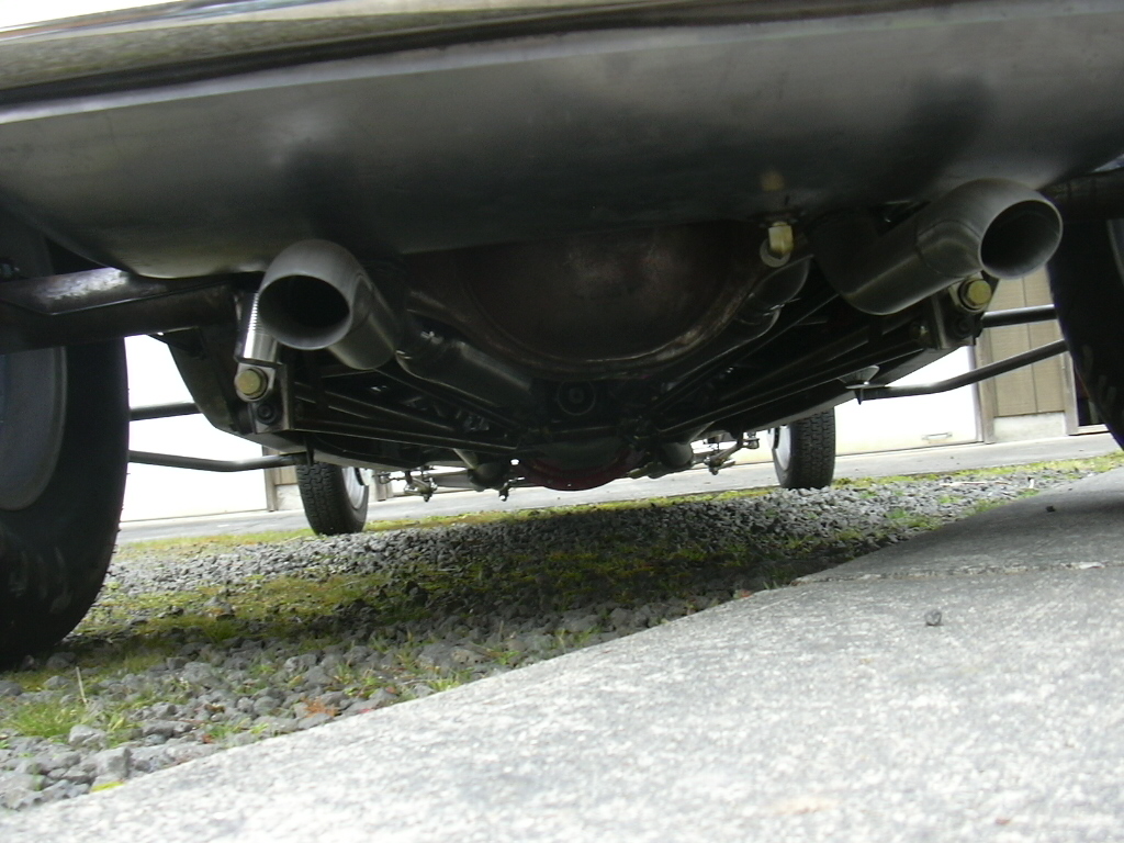

    Turned out at a 45 degree angle and slightly turned down.

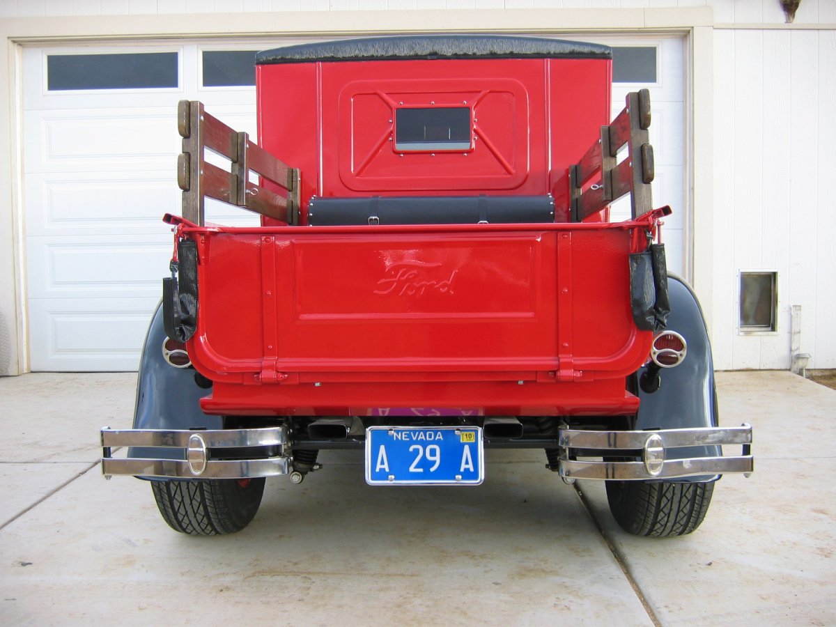

    Pipes are 2-1/2" and stuck about 3-4" more strait out. Couple hundred miles and rear bumper would need cleaning from exhaust haze. Shortened the 3-4" and put about 1/16 of a 90° bend down and bumper cleaning time gets up to around a 1000 miles.. 51 New Pics 003.jpg 51 New Pics 011.jpg

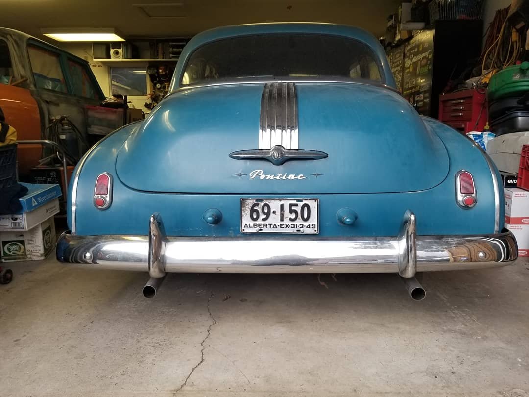

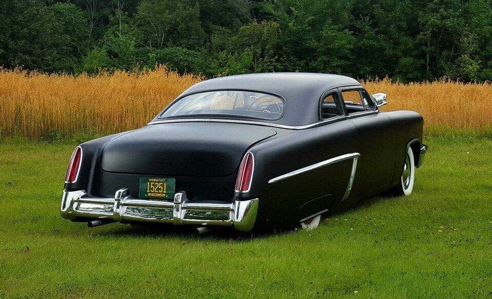

  20. Here's mine for now, glad to see this thread, it has some good ideas already, I hope it continues to grow. :) 20191104_120404.jpg
