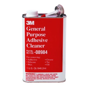

  13. Yes, 3M General purpose adhesive remover. Can't remember part # though. Excellent stuff. It is a product you should keep in every shop.

    Another recommendation for 3M General Purpose Adhesive remover - Part #8984. If you give it time and work with it, I've never had any type of adhesive (dried or otherwise) that this stuff won't remove.

  21. i just bought some of this stuff last week to help me remove some old dried cracked stripes the previous owner put on my 72 f100 i also used a eraser wheel to get them off heres 2 pics and yeah i know the truck is o/t this is just for demonstration first pic is before second pic is after i have to buy another eraser wheel to do the passenger side
