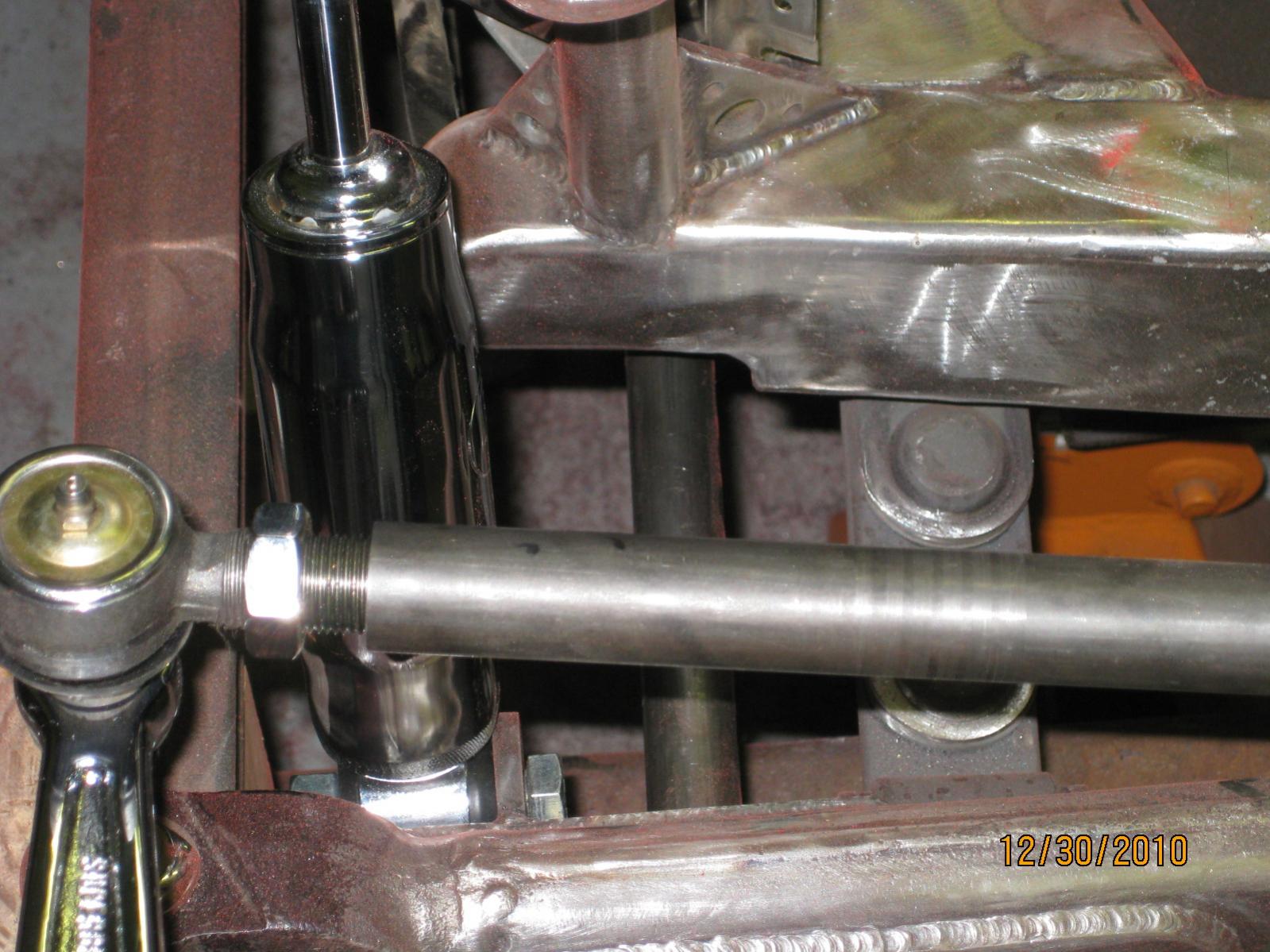

  16. This is my Model A that I'm currently building. It has the crossmember set back 2" and the spring mounts are built onto the wishbones. I have the deep drop bolt on steering arms so it has the correct ackerman. Its a lot of work but it can be done safely and with the correct geometry just do a lot of research first.

    Here's how I "pushed" my front end out to get lower....with a drop axle as well.
    I don't know if this is "considered" a SUICIDE front end,,,,,seeing that if the spring were to fail, the axle would just hit the frame. I did it this way as I'm not a fan of cut off frame horns and tall suicide perches....
